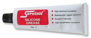

Dielectric grease is an electrical insulator and as such if it’s applied directly to the conductive pins in a connector which may have low contact pressure due to the their age/deterioration such as in the injector connectors the grease may have a negative effect.
You need to ensure the injector male pins are perfectly clean and that female pins in the harness have good contact pressure to create a low resistance contact.
Cleaning may well solve the problem but ideally you will want to replace your harness plugs with new ones and apply some silicone grease as you plug them in.
