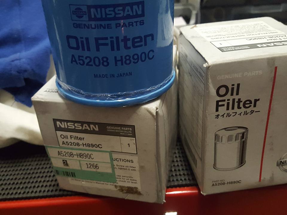

I have A2508H890C oil filter & 1102601M02 washer drain.

I think that's the old part number. That filter went NLA years and years ago. The one that Nissan supply now doesn't have the non return valve in it. The WIX filter does contain the non return valve and I believe so does the K&N. They're all good though.
Surprised if these are not available at any Nissan dealers as they fit many modern Nissan`s as well as the group of older cars on the label.
