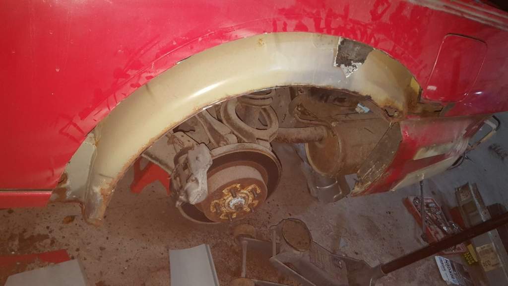

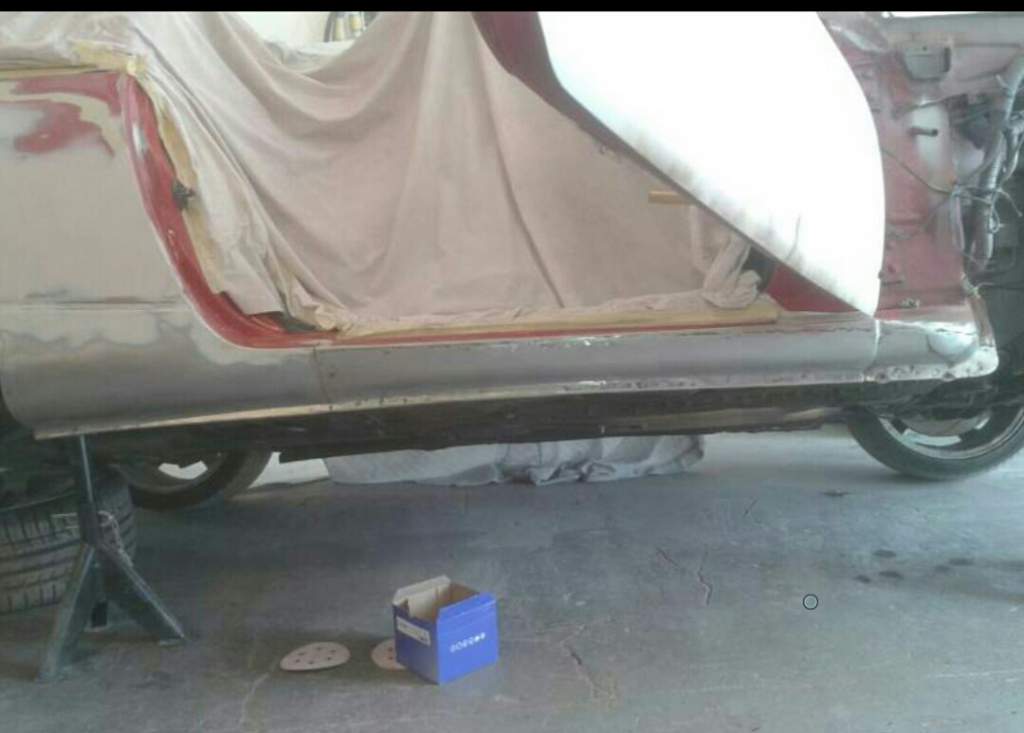

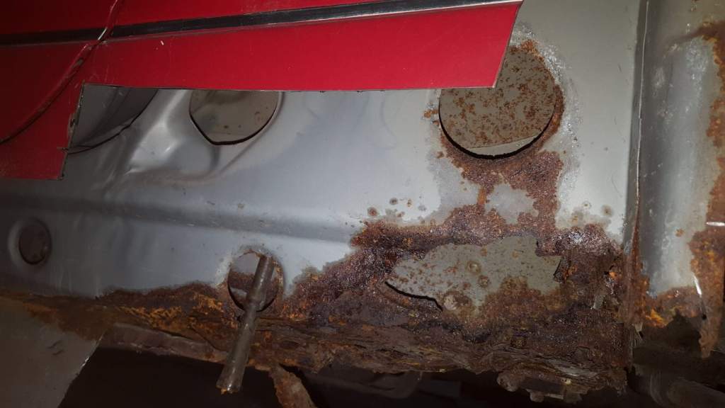

Here are my exploits.
Again, don't be put off, it was not as bad as it seemed.

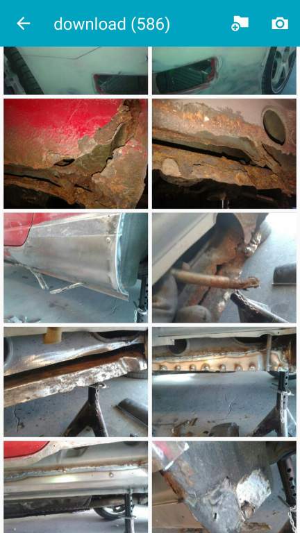

Looks like I need to pull the pictures out...

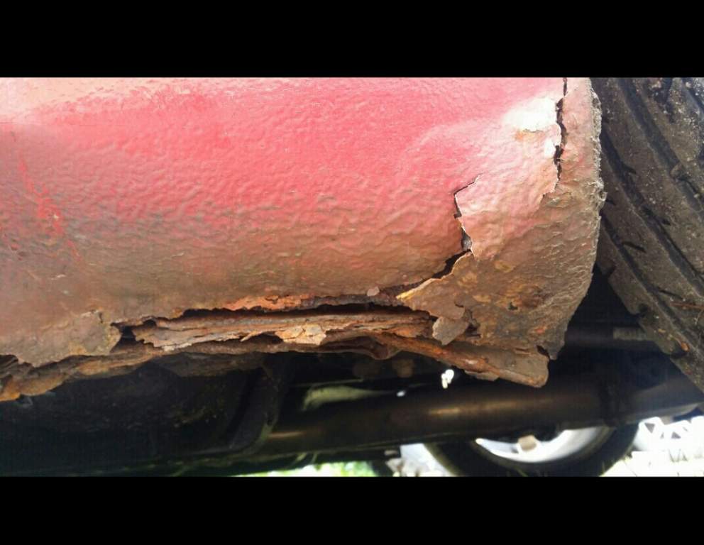

This is what mine looks like at the moment. It's only the drivers side that's actually bubbled through the paint, I'm sure the passenger side is no better, so will obviously try to get them both repaired.
That's more than 'bubbled'. Not wanting to be the bearer of bad news, but that will have rotted the inner sill too. You might want to check your targa drain holes which sit just behind the sill return by the floor pan.
The sill is made up of 3 different sections and is fairly complex, by the time the outside has degraded, the inner pieces will also be shot.

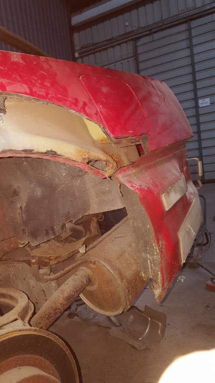

Yep si's right I'm afraid...my red zed had one small bubble on the arch and look what lies beneath :ohmy:
And to be honest looking at that bottom sill,I'd bet my 3 legged bengal that's had a poor repair before :(
[ATTACH=CONFIG]110344[/ATTACH]
[ATTACH=CONFIG]110345[/ATTACH]
[ATTACH=CONFIG]110346[/ATTACH]
Agreed, I see a lot of filler in that photo.
