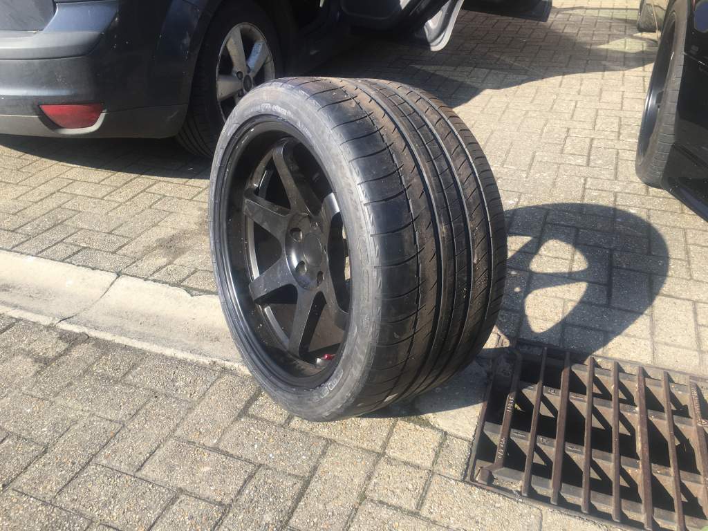

New rubber went on yesterday.
Aesthetically they’re not ideal, I forgot that Michelin’s are quite balloony in their fitment so probably should have gone with a 275 or 285 tyre,. But in this case, function wins over form. 295/35ZR18 103Y XL Michelin Pilot Super Sports and the Z now has a serious rear end foot print.
I’m probably going to have to do some clearance work where the bumper mounts to the quarter panel as it’s looks like it’ll foul on suspension compression. Also looking into corner balancing and geometry when I’ve tweaked the ride height.

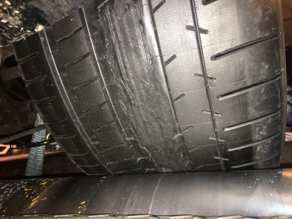

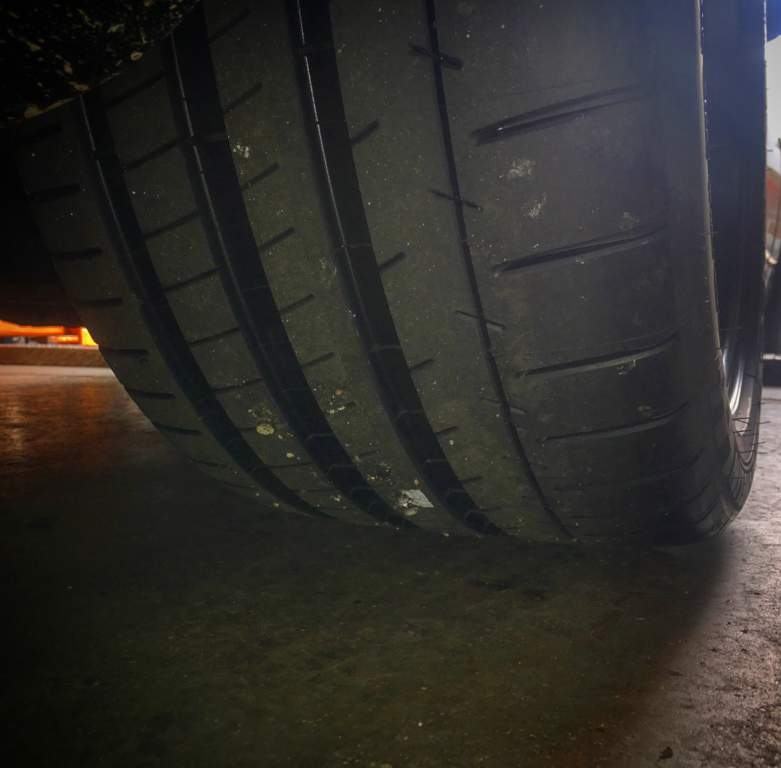

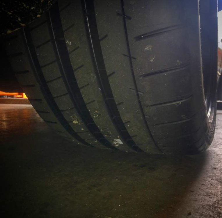

Yet again, another tyre failure. This time a 50 miles of use Michelin
Same side as the last failure. No signs of it catching or rubbing anywhere on the tyre. 32psi when cold, 45psi hot.
None of us (myself or the tuner) have any idea what on Earth is going on. He’s never had a failure in 10 years of tuning, never mind two on the same car on the same wheel
Yet again, exasperated :(
I would contact Michelin and ask for a refund. You shouldn't expect the tyre to fail brand new!
I have heard of dynos putting extra wear on tyres but not chewing them up. Is the wheel slipping on the Dyno before that happened?
No slip at all, still at wastegate boost pressures at 360ish HP
You can see it went under heigh pressure as you’ve got dirty edges inside and out but I’m sure the tyre is rated a lot higher than 45psi. I’m sure Michilne will replace it. Sorry you still not getting the luck you deserve!
I wonder if the problem (with these new tyres) is lack of running in to remove lubricant left from the
manufacturing and this has caused the tyres to slip and overheat on the dyno roller and ~360 HP.
During the manufacturing process, tyres are treated with a lubricant to prevent them from sticking
to their moulds during the curing stage. When brand new tyres are fitted to a car this lubricant is
still present and can make the tyres slippery until it is worn away from normal driving over a number
of miles.
Maybe a silly thought but 2 tyres on the same side on the same dyno have you checked the roller carefully for anything on it?
There was no signs of any wheel spin on the dyno, as that was one of my first thoughts around the heat being generated.
Given how grippy the knurled rollers are, I would have expected a lubricant issue fairly early on during the dyno session, but given how hot they got I think it would safe to assume it would ha e been burned off pretty quickly
I’ve messaged and tweeted Michelin UK asking about a warranty claim. Even if I’d done a mahooosive burnout at 45psi tyre pressure, I wouldn’t expect to see that kind of failure until the tread was well worn. As you can see from the pic, everywhere Bar the delaminated part looks pretty brand new. Here’s hoping Michelin are willing to replace them (not holding out though, luck doesn’t appear to be on my side at the moment)
Yeah, nothing obvious apparent. The rollers were re knurled about 6 months ago
What are the edges on the opposite tyre like? Are they showing the same dirty edges?
If not that wheel has reacted differently to the slight change in size as the pressure increased.
I know I'm reaching a bit but trying to think out of the box for you. Something slightly ajar in the suspension might put differing loads on the tyres.
The car is anchored in the same position so all of that energy is through the tyre, nothing absorbed by the car or suspension.
I only glanced at the other side, but looked pretty similar
Well I’ve spoken to Michelin directly, and they’ve asked me to take the tyres back to the retailer for inspection/warranty claim..
I’m going to push for both tyres to be changed, given that the failure has happened inside the structure of the tyre, it’s not going to be visible from a visual inspection of the thread (unless it has started to go and we haven’t spotted it yet).
Fingers crossed for a positive outcome and some new, less explody, rubber
Well after several emails, phone calls and complaints I finally managed to pursuade Michelin to replace both my rear tyres. Further more, I managed to get them to agree for me to have a different tyre. I’d decided that aesthetically I didn’t like the 35 profile tyres as they were a bit balloony. Unfortunately, they don’t make the Super sport in 30 profile. So I managed to get a set of 295/30zr18 N4 rated Pilot Sport 2’s.

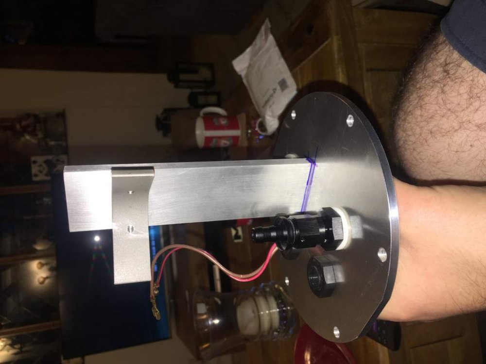

The car was due to go on the dyno yesterday, but prior to doing so, I noticed a smell of fuel at the back of the car. Initially I thought one of my AN fittings had failed, so I replaced it with a spare. I took the car for a test drive only to find I still had a leak when I got onto any form of boost.
A bit of investigation later and i find that the weld on my AN fitting for the feed outlet has split. One exhaust flame on the dyno could have sent the whole thing up in flames!

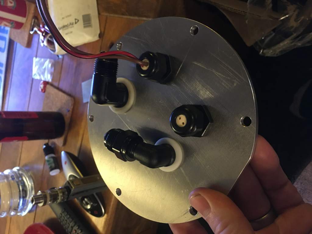

So rather than modify the OE fuel tank lid further to accept AN bulkhead fillings, I’ve decided to have a custom fuel tank lid machined and drilled to use AN fittings.
All being well, it’ll be ready for the dyno on the 11th May... otherwise I may end up missing the Lakes trip (which I’ll be gutted about!)

New bulkhead fittings turned up today, so fingers crossed the custom tank lid will be ready for the end of next week.
In the mean time I noticed I had a little play on the hicas rack tie rods, so a new set of those have been ordered from CZP and fitted in time for its next MoT before the lakes trip

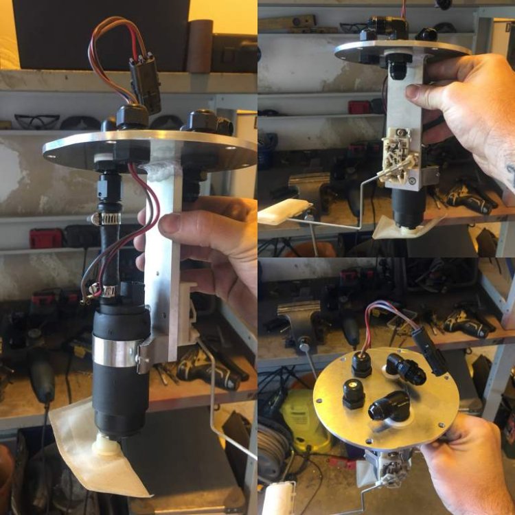

Picked up the new billet fuel tank lid. Mocked up the fittings, and lined up the new pump hanger for it to be welded into place tomorrow. Just need to find some longer bolts to boot it down
