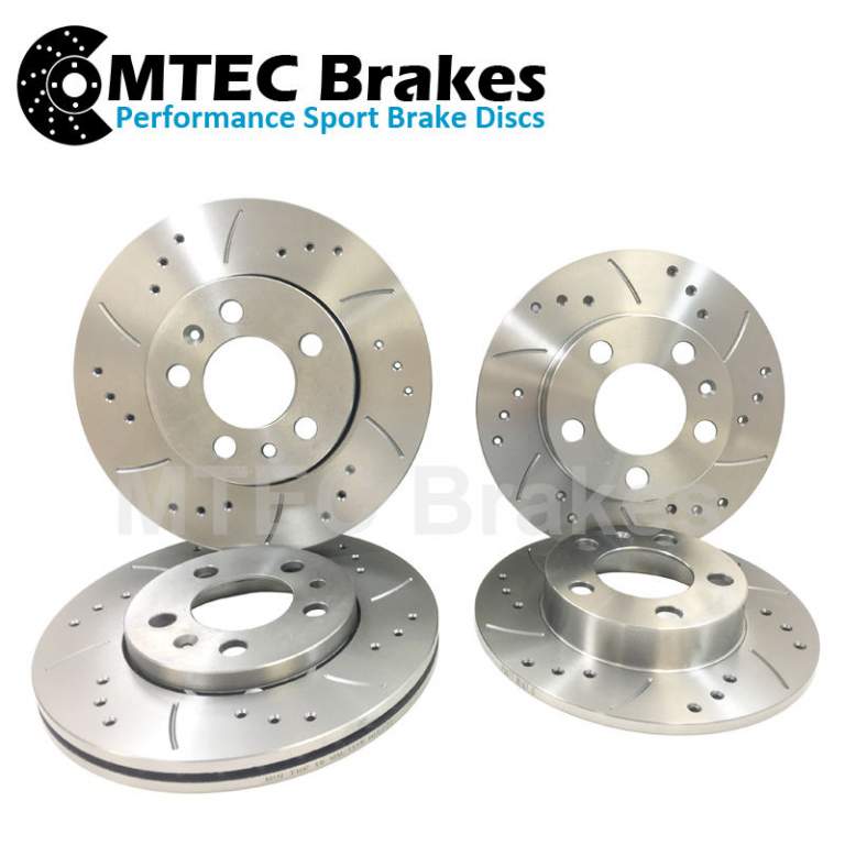

If your on a budget but still want reasonable quality brakes then Mtec ( ebay seller ) sell these fronts for £160 and also do the rears >>
https://www.ebay.co.uk/itm/300ZX-3-0-TT-Front-Rear-Drilled-Grooved-Brake-Discs/290479628736?fits=Car+Make%3ANissan%7CModel%3A300+ZX&hash=item43a1ef61c0:g:J6YAAOSw4GVYSsMt
For normal road use they will be fine and using Mintex pads will give a good feel, of course this is assuming the calipers are in good order, be careful when bleeding to not allow the brake pedal to go fully to the floor, this can cause seal issue in the master cylinder.
