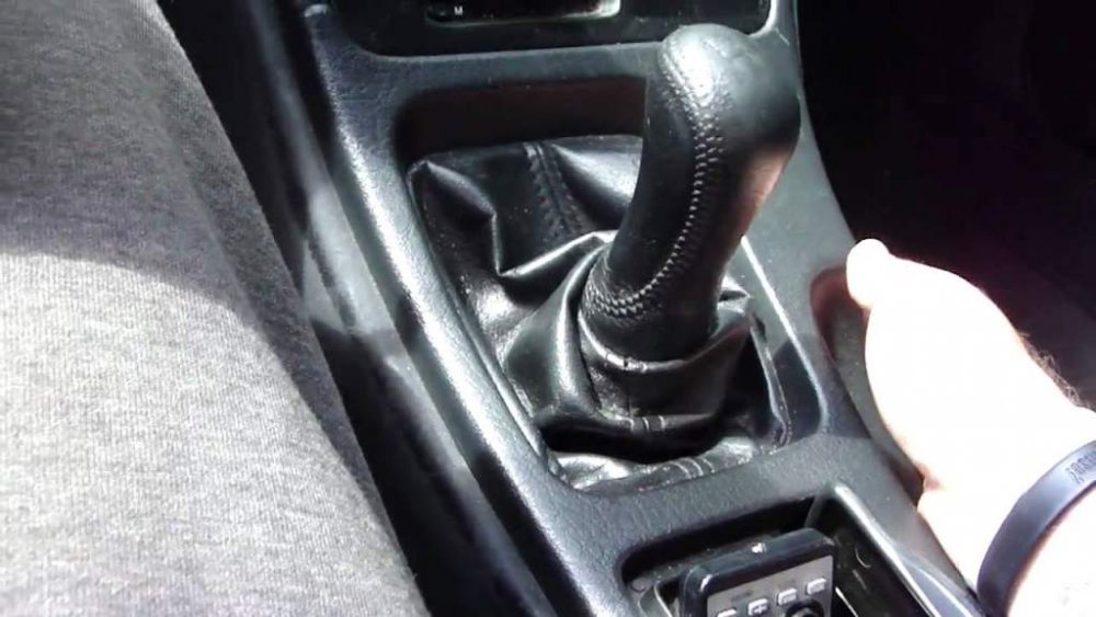

My car is now a fully working manual !

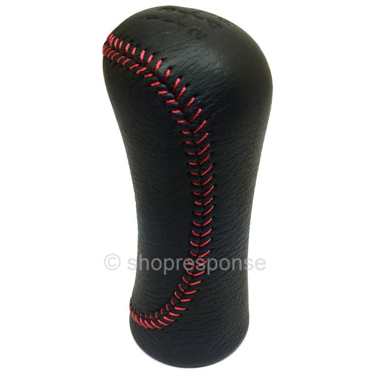

I would suggest getting a new Nissan gear knob, that one looks too small, should look like this>>>
where can you buy them jeff? I would prefer just all black and black stitching. The red one would suit yours!
the gearbox came with nothing so the one on there was a cheap solution from ebay so I could drive the car!
Can be ordered through Nissan, part number is 32865-30P01 for black with black stitching, they are close on £100 these days though, cheaper in the US but the exchange rate and shipping cost will mess that up.
