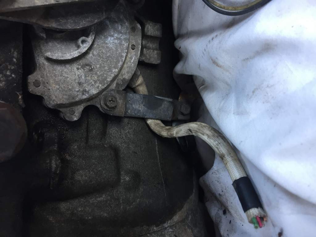

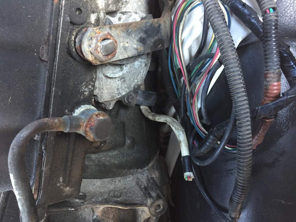

Picked up an automatic box from Ted this weekend,.
He cut this cable for the connector,.
It goes into the auto box,.
You might be able to take out the selector and replace it with your one? Ive never tried.
Not supposing any one knows what the cable connector/plug/socket is under the cover?
Just before I go ahead & dismantle it!
I was just wondering if the cable (which has about 10 small wires in it) disappears into the casing of the gearbox or is it a connector?
Swap over the selector and loom from you old box, easy as that.

Thanks for that Alic
Thanks Jeff for confirmation.
