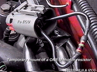

You can place a resistor (i forget correct ohms on this but someone will reply im sure) into the harness that goes to the ecu and this will fool the ecu into thinking that sensor is connected and fine. If this clears the fault it rules out the harness from that point back to the ecu.
Dont place resistor into the short harness that goes to the sensor by mistake. Make sure its placed into the ecu side of the plug while disconnected

This writeup should help you with the problem (and includes the 1MΩ resistor fix):
http://zhome.com/ZCMnL/PICS/detonationSensor/detonationSensor.html

For that reason alone is why others mention checking the connection plug, cable and in fact just check it is plugged in, we had many over the years come in and not plugged in !! the 1 ohm resister trick will take a couple of minutes to try and might just save you doing a whole lot of work if it reveals a cable issue.
