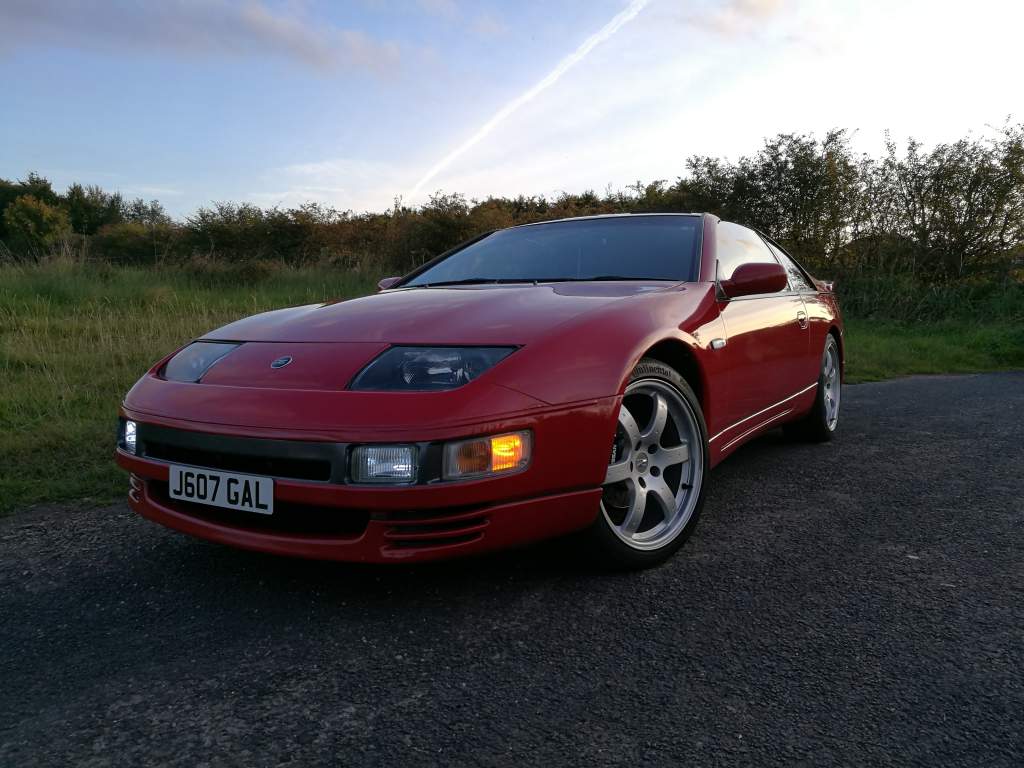

I actually lit both....
[ATTACH=CONFIG]109465[/ATTACH]
My indicators did this (stayed on permanently, until indicator stalk was used and then they would flash in the correct direction) and the MOT tester failed it as:
Nearside Front position lamp(s) incorrect colour (1.1.A.3e)
Offside Front position lamp(s) incorrect colour (1.1.A.3e)
I had to re-wired them so they weren't orange all the time and he passed it

Thats because you were using one bulb to do two jobs (posistion light and indicator) coopd's has seperate indicators and posistion lamps so is perfectly acceptable.
The failure you should have received was "posistion lamp affected by the operation of another lamp" .
Sent from my SM-G925F using Tapatalk
Plus, if your fogs still illuminate as the posistion lamp it doesnt matter what colour the other posistion lamps are. They are not testable therefore cannot be failed.
Yellow posistion lamps are acceptable if within a yellow headlamp.

As Chris said, mine light separately. Had it MOT'd twice since with no issues.
I do like the orange sides :)
