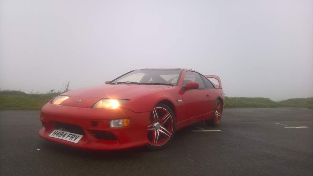

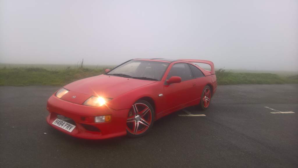

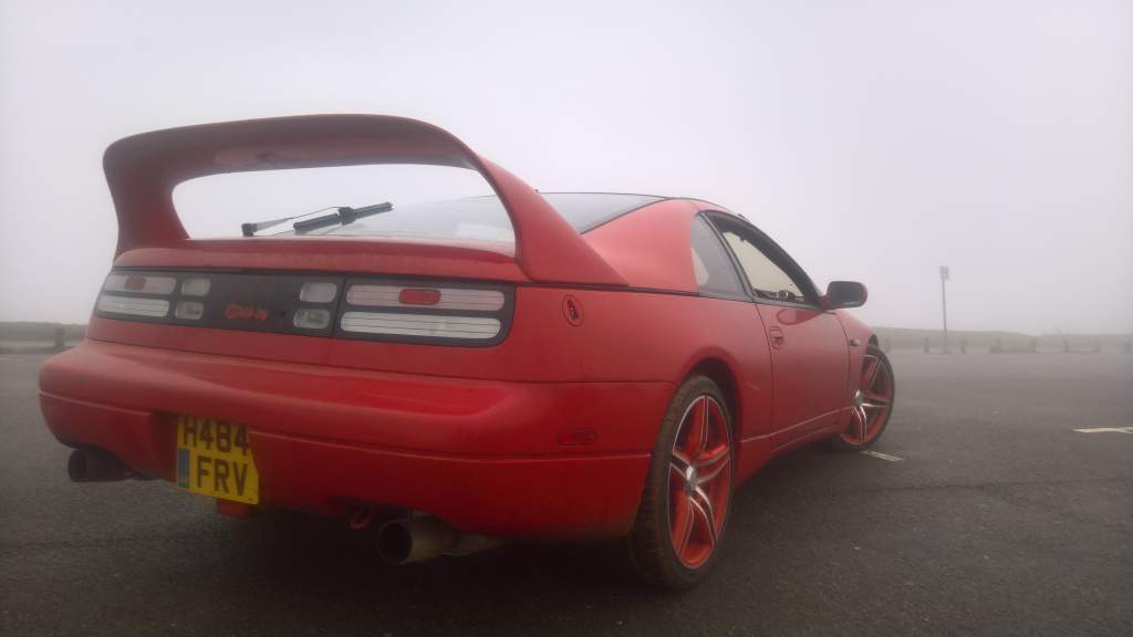

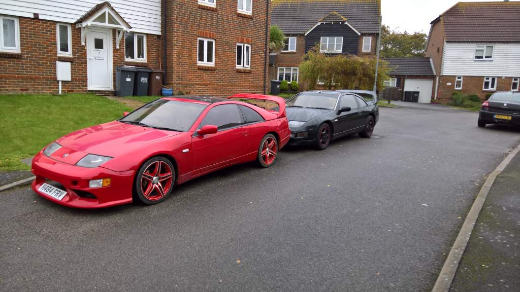

Enough writing now, I can hear you all screaming "where are the pictures, damn you!" so without further ado...
and finally I have my two car garage!

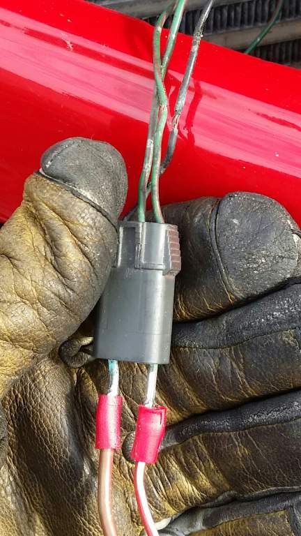

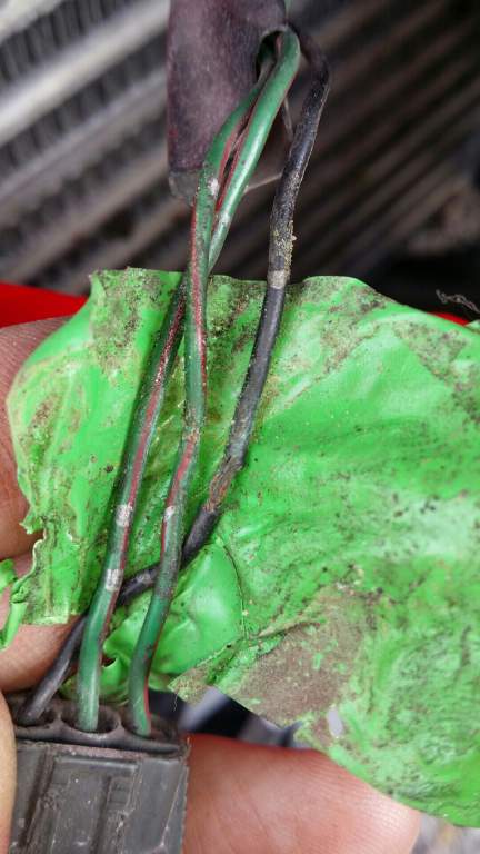

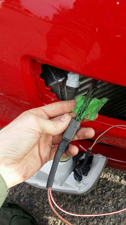

The wheels and the front spoiler are going but not yet as funds are limited! I changed the fuse, lights worked normally until I drove away and it blow the fuse again. I'm guessing some kinda of short somewhere?
I had that and it was 2 wires that had rubbed bare behind the front right light. But it took a lot of finding, I had all the lights hanging out at all 4 corners and traced them back into the car. It was also wrapped in tape. I'll dig up a pic...
This is NOT my handiwork. I did not do this wiring but I have since fixed it.
[ATTACH=CONFIG]109220[/ATTACH]
[ATTACH=CONFIG]109221[/ATTACH]
[ATTACH=CONFIG]109222[/ATTACH]
Glad you did! Bullet/crimp connectors are a bad and lazy idea for external wiring!
