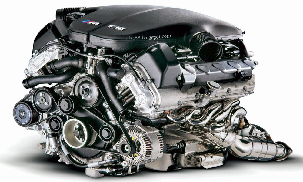

Anyhow, its up to you guys what you do, just my opinion, one that was formed over the many years working exclusively on zeds, and the fall out that big idea`s and battered wallets can cause, oh and buying a car that's more powerful from the factory is great fun, repeatable performance, no "what is that noise" to worry about and still exclusive enough to feel your car is special, is that not what we all want ?
Jeff
My factory stock engine
