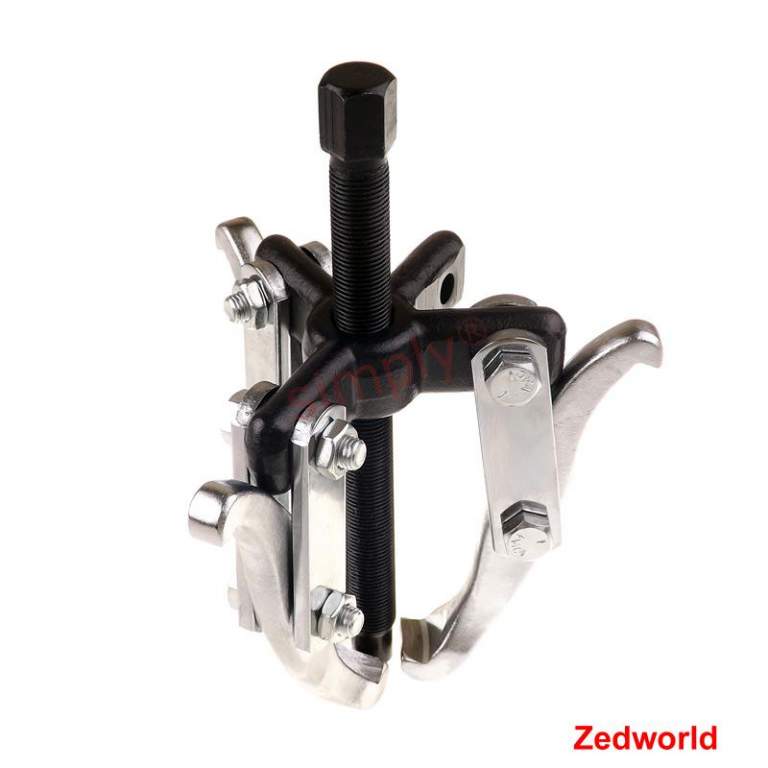

So first you need one of these >>
So insert the pulley bolt back in and screw in around half way, fit the puller ensure the pulley is straight and equal at each leg.
Take a good ratchet spanner and take the slack up, the puller is now tightly held in place, now turn on some pressure, you will see movement, but is will be the isolator middle section flexing rather than the pulley moving on the crank.

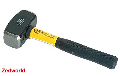

Now you need one of these >>

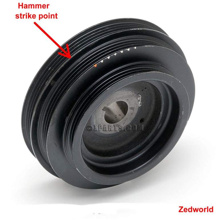

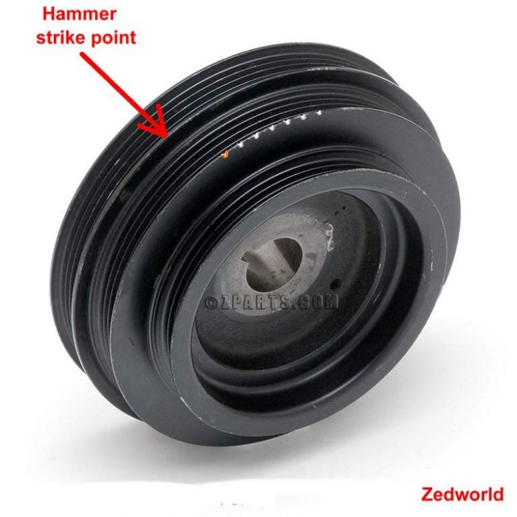

Make some short but firm hammer blows to the pulley, but not right on the edge, there is a solid line that can be seen in the area where the ancillary belts run, do a couple to the left and a couple to the right, check the pulley remover tool bolt if now a touch slack slightly tighten the pulley remover again, enough turns to make it tight again.
This is repeated until the pulley starts moving on the crankshaft, spray WD40 at any angle you can to get on the crankshaft, once it starts moving it will be a case of a few blows and tighten a few blows and tighten etc.
Eventually the main crank bolt will need loosening some more as the pulley comes off, be patient, if you get to a point where nothing is moving tighten the pulley remover bolt as tight as possible ( will try and turn the engine )and leave it for 5 mins and have a cup of tea, the pressure is left on the pulley and when you get back into it the hammer blows will have an effect, maybe small but stick with it.
This process will shock the pulley loose, it can take several repeated attempts to get a rhythm going and slowly the pulley will come off, and its only a small amount of rust that cause the problem. Many pulleys come off really easily, the ones that tend to be a problem have had water leaks in the past that has run down from the water pump or by passes hoses and got between the crank and pulley.

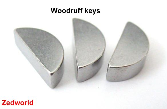

Its important to clean up the cranks will some wet and dry and inside the pulley before refitting and of course take care to not loose the woodruff key.

So that little wedge is called a woodruff key, interesting.

Here some pics of what the key looks like
