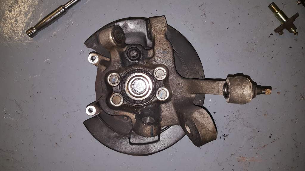

So need to replace all of the bushes on the knuckle shown below, apart from burning the hell out of them.
Does anybody recommend a tool that can press them out ?
I've already tried using the socket method and they wont budge.
[ATTACH=CONFIG]107337[/ATTACH]
I cut the threaded end off with an angle grinder, then carefully removed the lip of the bush with a grinder.Put the whole lot in a vice with a 29mm socket on the back and an 18mm where the thread used to be. I used a 2ft extention bar and pressed it out (it was hard work).
If I did it again I would use a press.
In the workshop on the ramp we got these down to 20 / 30 mins per side with only the wheels removed, cut off the front flange with a grinder and heat up the alloy and whack them out with a socket, keep the alloy warm and the new bush goes in by hand, when it cools down it has it solid.
