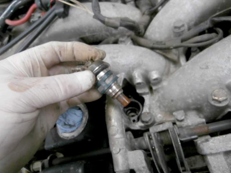

No dremel required for No 1, see my link below with pictures >>
https://www.300zx.co.uk/forums/showthread.php?172124-Injector-seal-fail-tech&highlight=injector
Jeff
[ATTACH=CONFIG]107236[/ATTACH]

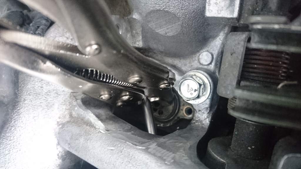

Managed to get the screws and cap off, but, try as hard as I might, I can't get the injector out of the rail.
Any tips? No matter what method I use for bracing, it won't pull out.
It will probably break into bits as you remove it. Make sure you install the new one correctly.
Son of a whore! It popped eventually! Won't be able to self-gratify for a while however! My wrist! God damn it! Lubed up the new one, popped it in and reconnected everything else, she's now runnin' on 6 again!
