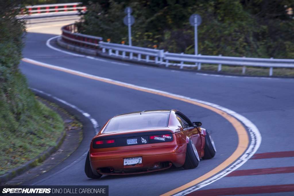

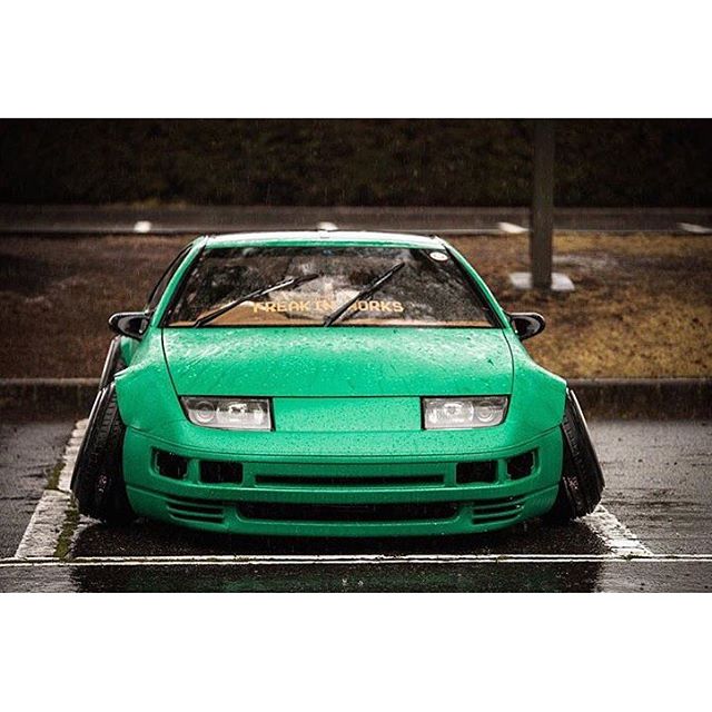

Maybe it's your arms as my car had stupid camber before I corrected it. Lowering the car a lot will cause silly camber on stock arms. I wish I had pictures. I hope your not going this far;
It's been done, rightly or wrongly. It's just not the fashion with these cars, more the sub 100hp hatch back crew. Here's an article on of the cars above.
http://www.speedhunters.com/2015/12/raising-a-middle-finger-freakin-works-z32/
