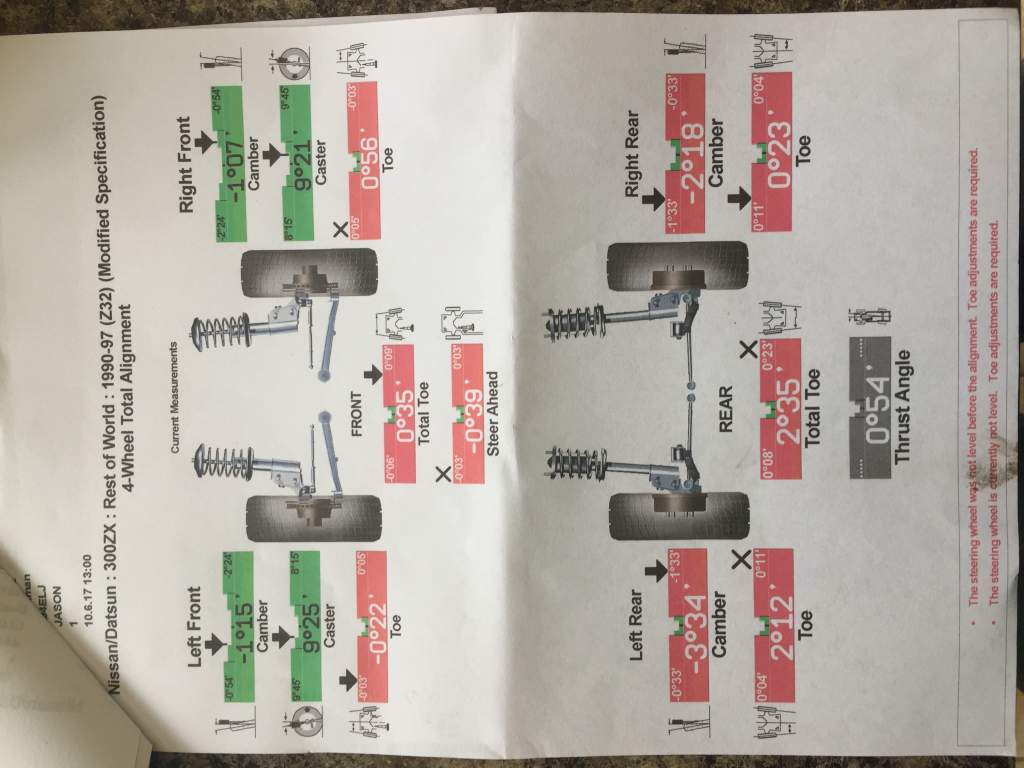

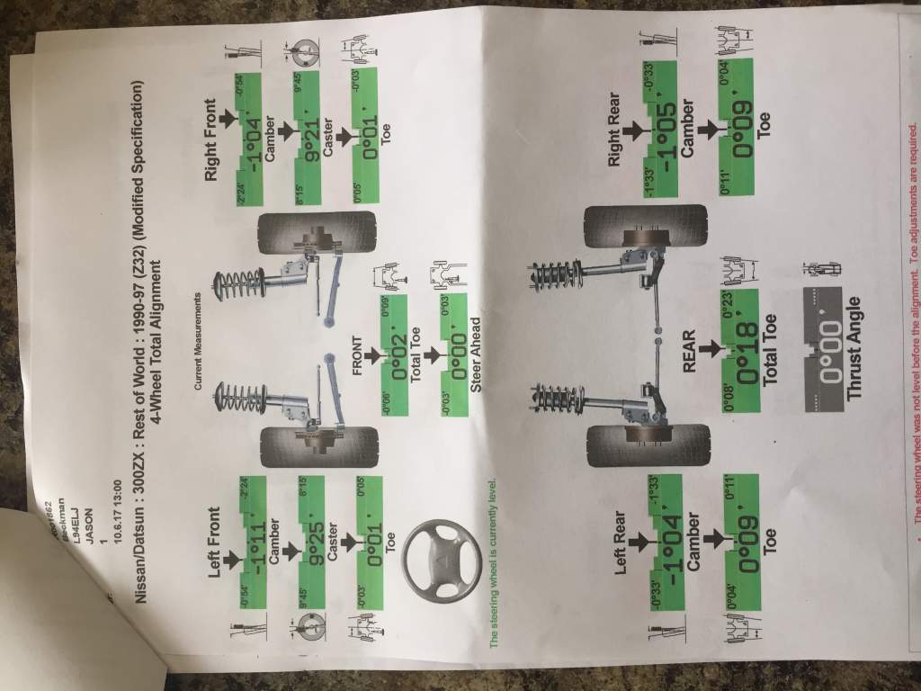

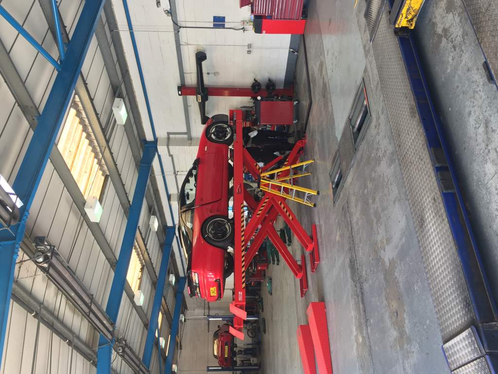

Great job done by the technician at Guildford Tyre Co. using their Hunter Hawkeye kit.
As you can see from the first reading once my car was setup, it had some interesting numbers!

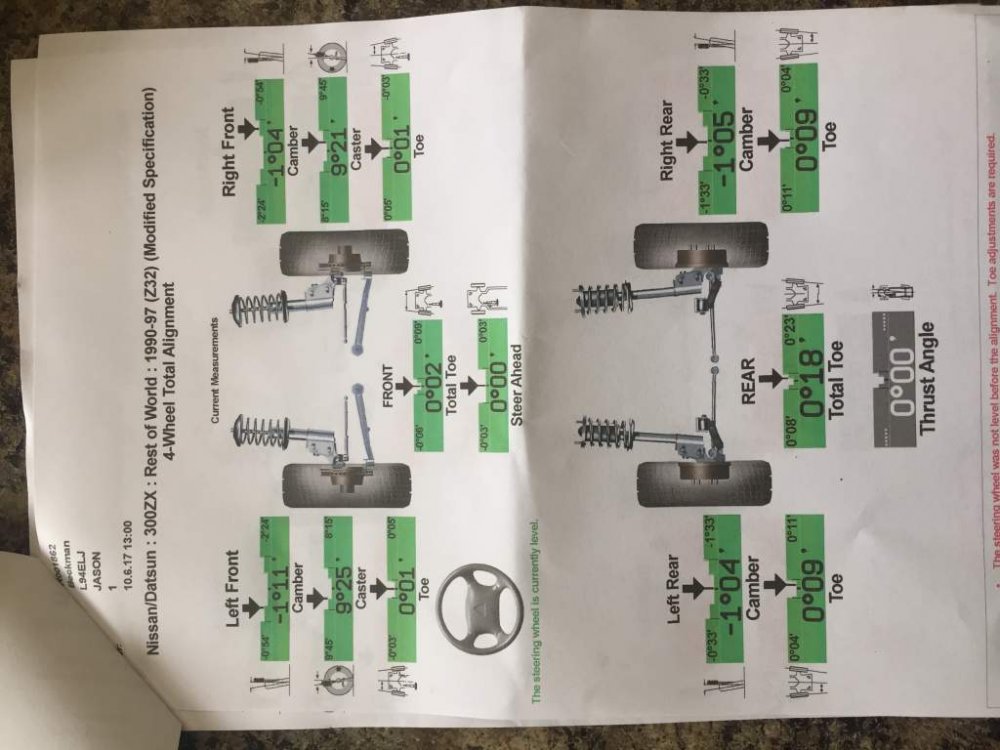

After an 1hr everything was looking much better.
The drive home was a blast!
Sorry about the pictures (iPhone pah)
