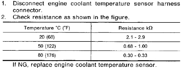

Have you checked the temperature sensor itself?
FSM How to:
[ATTACH]106282[/ATTACH]
FSM How to:
So, at cold tap temperature ohms resistance is around the 2.0 ohms
After running the sensor under a hot tap, probably achieving around 70 deg's C approximately the reading is around 0.80 ohms
So seems to be reacting in the right direction.
Having said that though, I think I will invest in a new sensor for what they cost.

I assume you mean Kilo (thousand) ohms?
[ATTACH=CONFIG]106289[/ATTACH]
Sorry Andrew,
Yes, you are correct.
