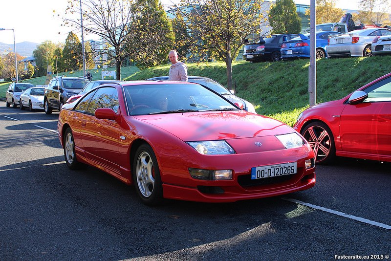

Booked next for transport on the Hoegh Tokyo. It was a long wait for 10 weeks or so, but the tracking was fun to watch. Finally, on the 12th of July 2015, we headed down to Dublin port to pick it up. I was taken aback by the state of it at first, dusty as **** and some paint had also been splashed on the front wing during transport. Just needed a good wash though. It's funny, but the car seemed so much different - lower and wider, mostly - in person, even though I've seen a few of these before. I opted not to drive it home myself, as I had no insurance, the car was unregistered and untested, and I'm a dodgy looking young lad. The drive home was exciting, all the same.
Got it home and gave it a quick wash. The car was absolutely spotless. The only things I think worth mentioning - and I'm being very finicky here:

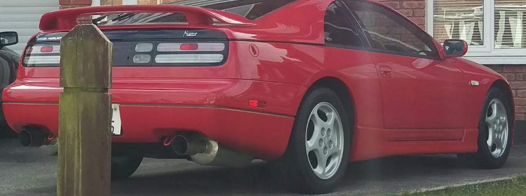

At some point I also fitted a brand new version R gear knob, and a Japspeed cat-back from Richie K. Changed the rear side markers to red (free thanks to Ted!) at some point, which required some modification as they didn't have a bulb slot.

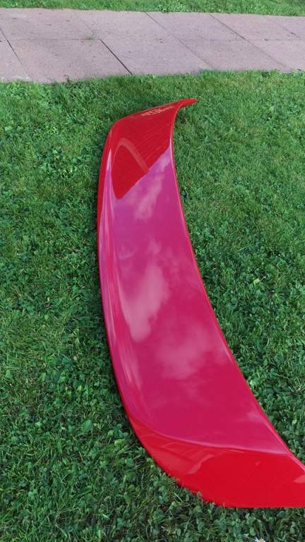

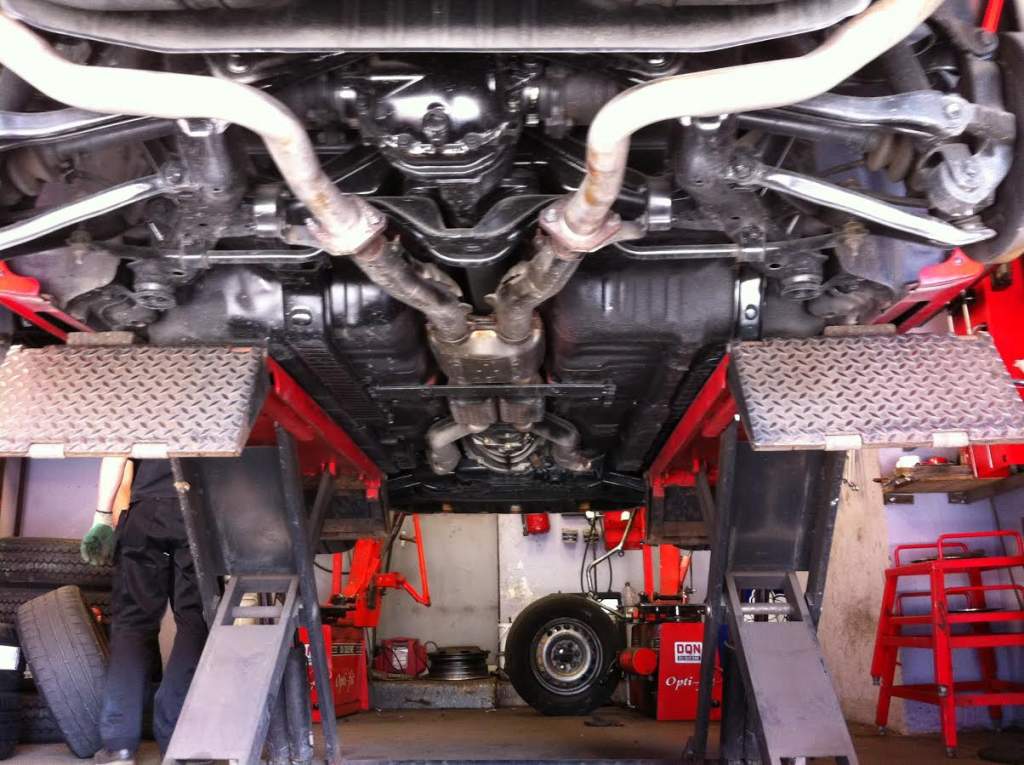

Over the winter and coming into 2016, I had the car freshly undersealed. Fitted new rear speakers as the old ones were pretty much perished. Fitted a new Bosch 068 battery in April 2016 when the old one gave out - fair enough after five years. Replaced the targa seals as they did leak a bit in heavy rain. Coming to August, I finally had the spoiler repainted as it was really letting the car down. Refitted with sealant, as this is a three-piece spoiler and the gaskets were perished and are no longer available.

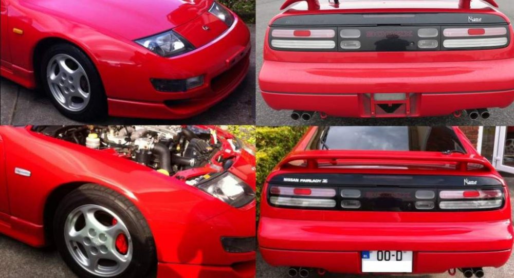

Attended quite a few shows in 2016, met a few other Z owners and just enjoyed the car. Made it to the 300ZX.co.uk AGM, though unfortunately I didn't bring the car over :( Late in the year I acquired a replica titanium key in red and fitted an APEX'i Power Intake. I want to keep the car original so this is about as far as I plan to modify it bar changing the wheels, although I wouldn't rule out a TT swap some day.

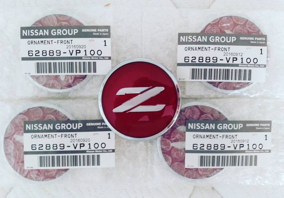

Purchased a set of 350Z anniversary wheels today, courtesy of a mate in Birmingham. Once we figure out how to get them back, I'll get them refurbished and fit some red Z badges for center caps. Possibly replace the tyres if their grip is shite.

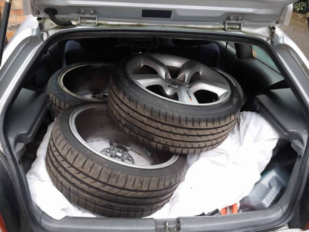

Hi mate look at lombard shipping to get the wheels across, they have trucks goin from Liverpool to Dublin and Belfast. Probably shove them on a container for you at small fee..
Cheers will check them out if we go courier. He'll more than likely be over on the ferry over the coming months so may bring them that way.

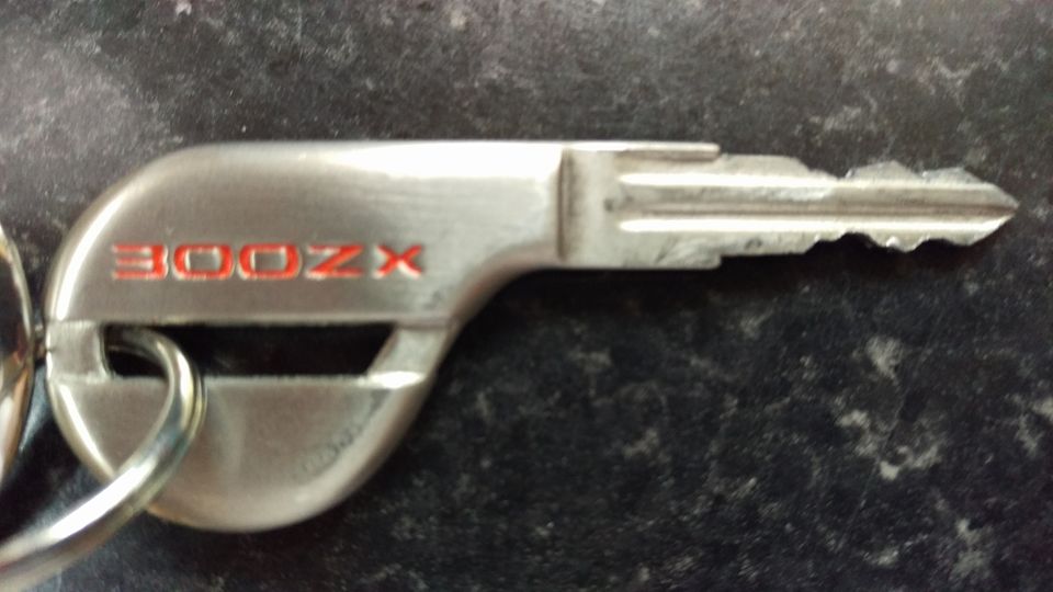

[ATTACH=CONFIG]104181[/ATTACH]

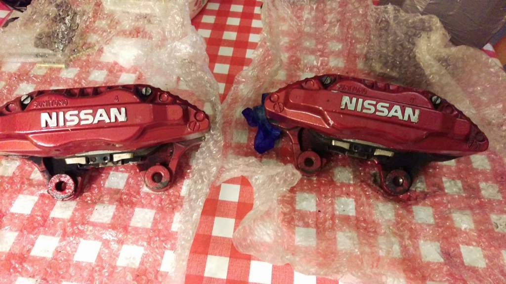

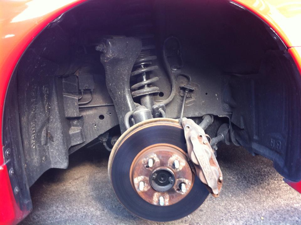

I got these calipers from Mondo, which I'll fit and rebuild my existing ones.
[ATTACH=CONFIG]104183[/ATTACH]

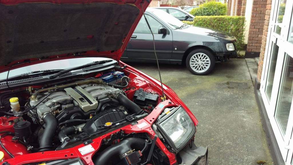

Though I'm grateful to my missus for letting me use her car every day, driving a 1.5L N16 Almera is absolutely soul-destroying. So hopefully this hibernation will end very soon.

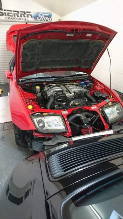

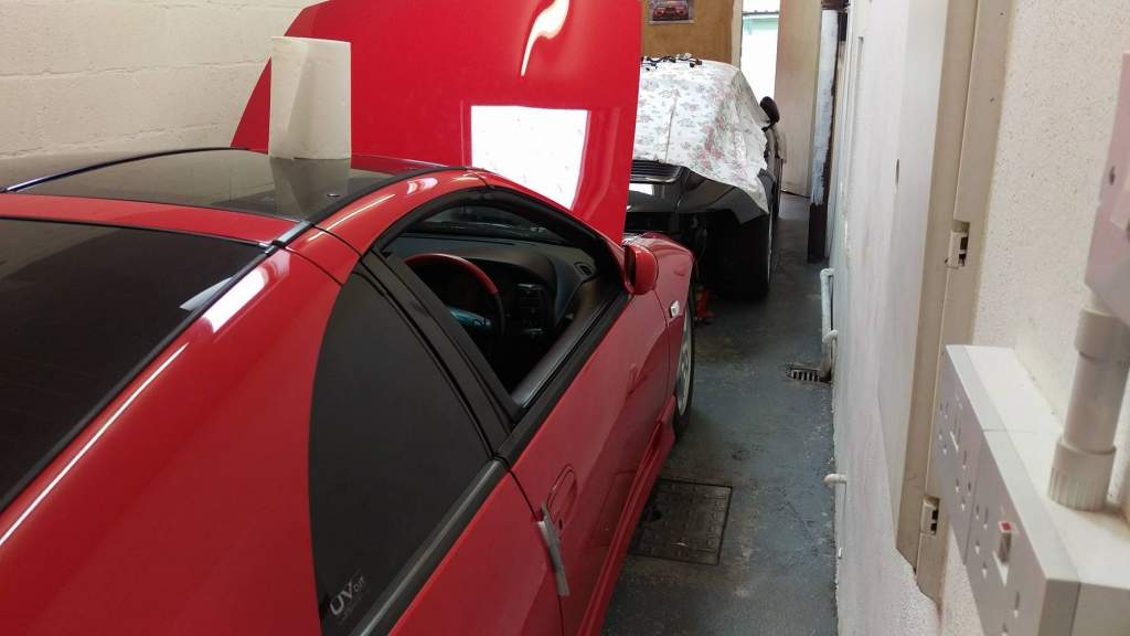

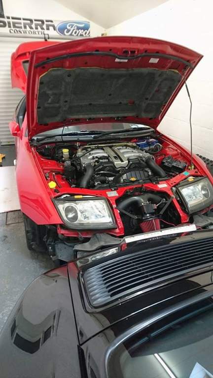

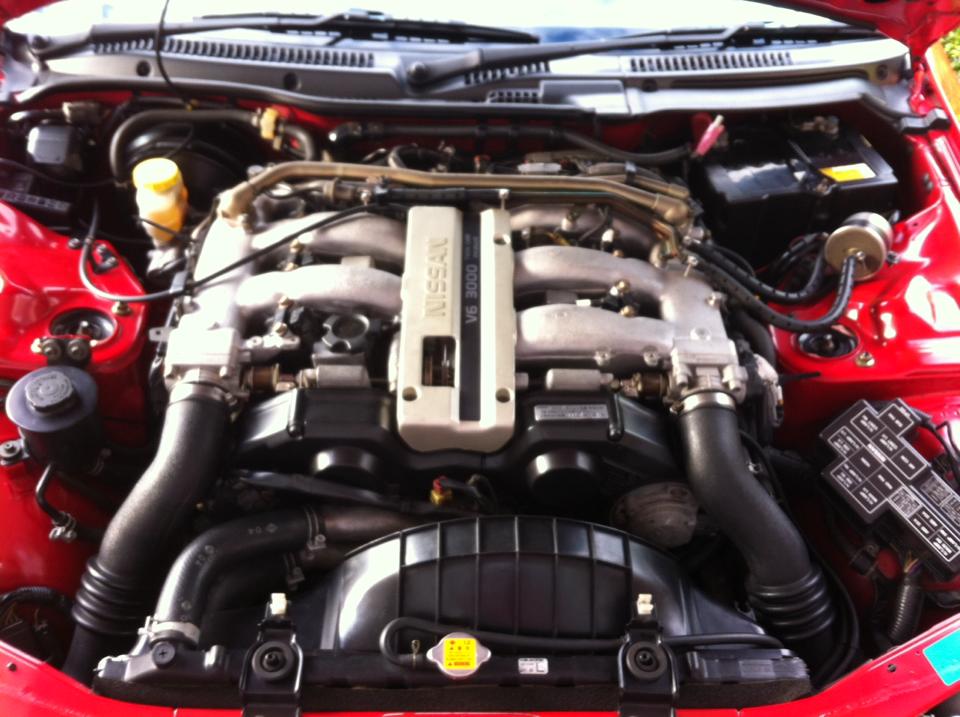

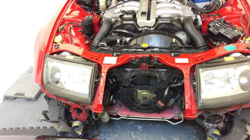

The other week I removed the front bumper, which wasn't really too bad despite the bloody hands. Today, I fired it up for the first time in over three months, and it sounds perfect. Removed the front undertray and got it into the garage - after we pushed the other car out.
Screenshot from 2017-02-24 13:10:47.jpg
So next step is to drain the oil and coolant, maybe Sunday. I'll probably remove the front bumper support bar for easier access too.

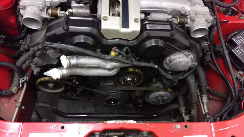

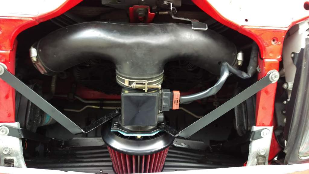

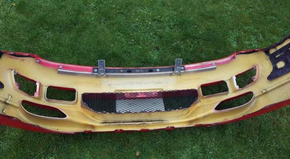

Started stripping the front end down on Sunday.
As it stands now, the radiator is out and that's almost complete.

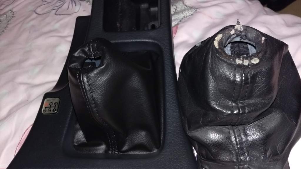

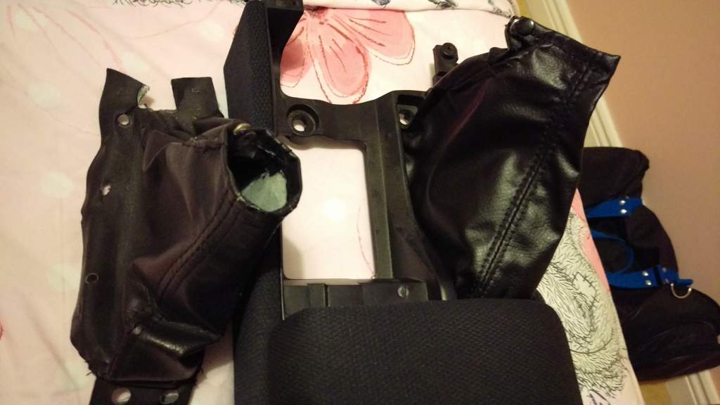

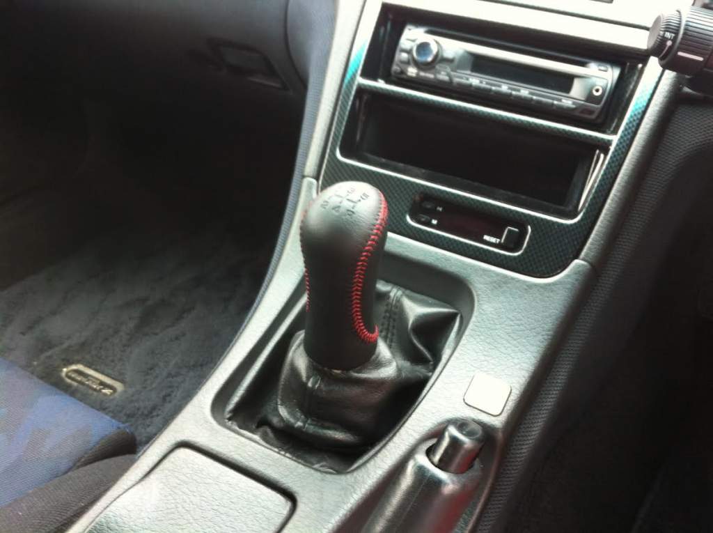

Also removed the gear shifter yesterday to change the bushings - no evidence it previously had any :confused: This evening, while that's out I ordered a Z1 rebuild kit and changed the leather gaitors.
It must have done, I don't think it would work without as there would be too much slack to shift. The (i think) m8 bolt that goes through the bottom of the shifter assembly goes through a sleeved hole in the base of the shifter, surrounded by some nylon bushing and enclosed by a pipe section. And the central balljoint without the plastic bushing would just knock around. Can you provide any pictures of what you mean?
I don't know if i'm making and sense :lol:
