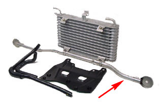

I'm currently undecided as to wether to refit the AUX fan as I have no AC and I appear to be missing a cross bar on the front, not sure exactly what it's called if anyone knows what I mean? Got the tow eyes, bumper brackets and rad support bracket to sort out. The oil cooler bracket was scrap.

I dont think you're missing a front bar? There is the bar that the fog lights mount to, but after that's off, it looks like this (on mine)
Maybe it's a UK thing. I'm sure I've seen an aluminium bar that bolts to the chassis rails. It sits behind the fog light bar.
Ah possibly, the jap had this fog light bar:
But the USDM had a metal one supposedly to meet regulations. Perhaps its a bit like this one for the UK spec also?
Anyone know/clarify?
Now i see, that's what those circular holes with cavity are for, they just have a round sticky black band aid over them on mine.

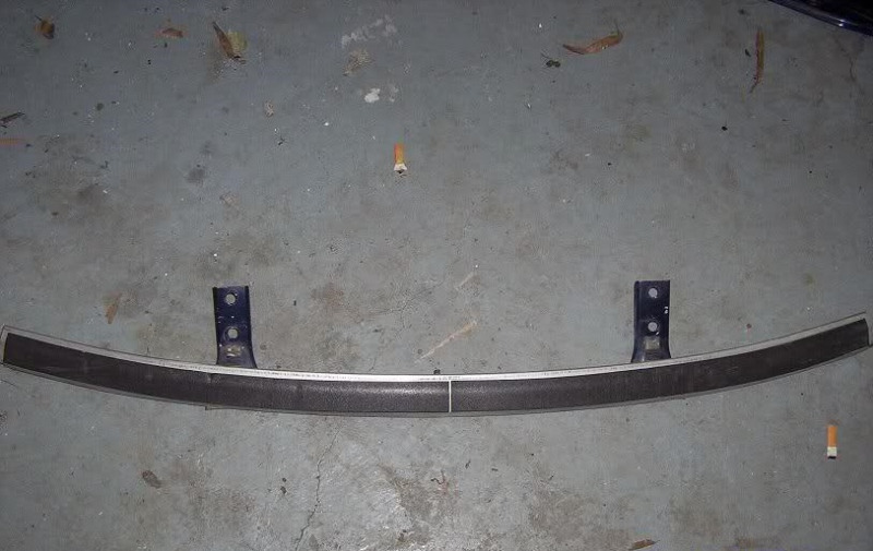

are you talk about this front bumper support
[ATTACH=CONFIG]103738[/ATTACH]
Nope, I've got that one. What I'm talking about looks like a strut brace type thing.
