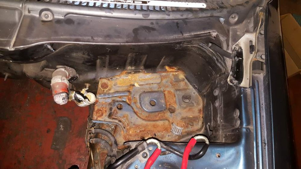

Replacing the Battery Platform Area
Yeh,
Found a how to thread made by Jeff.
Just need to find a donor zed to remove one from.
I'll check mine but like everything else in this car it's probably all rusted up

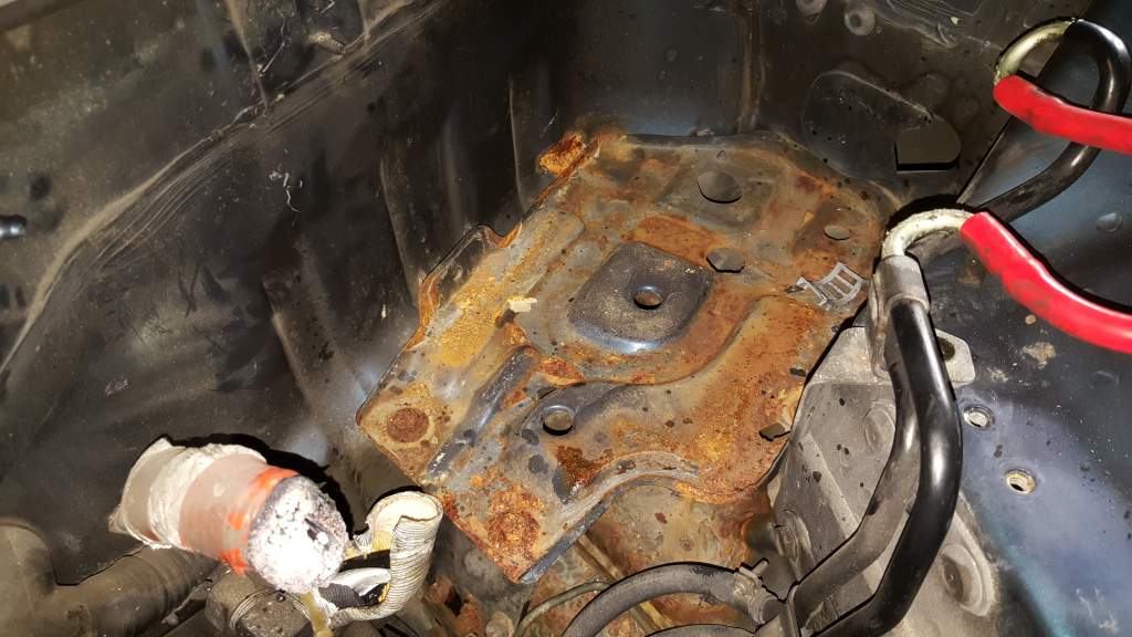

Have you tried cleaning it up with with a wire brush that goes on the end of drill it might not be as bad as it looks
Looks like surface rust to me!
As said wire brush, normal drill & or dremel.
That way you will see if the rust has eaten through.
Then go about treatment.
I'd be tempted, if you can't find a good replacement that is. To either relocate an appropriate battery to the boot, I don't personally merit that much tbh. Or have yours/another acid dipped and galvanised.
You could get one powder Coated an bolt it in I don't think it's structural
