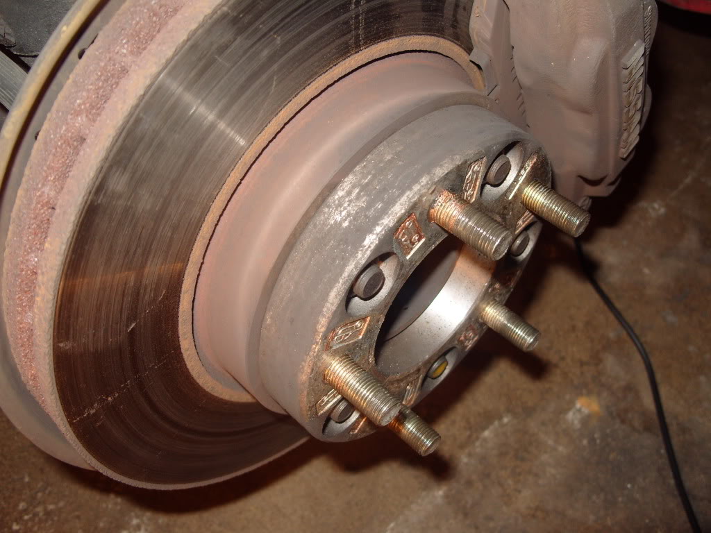

Fit 25mm spacers as I did to mine Lee.
[ATTACH=CONFIG]102830[/ATTACH]
That was my thought. But then I'm thinking, maybe just one of those 5mm ones would fix the issue rather than having the expense of 25mm hubcentric ones
