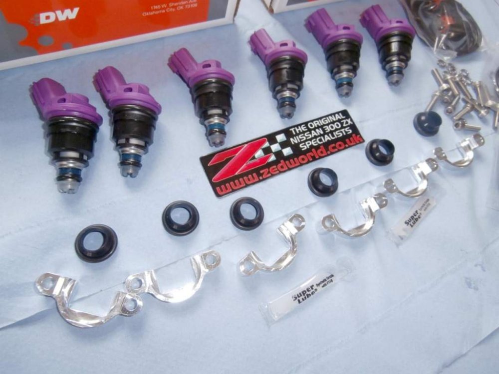

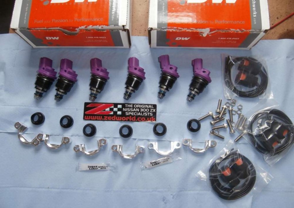

not sure if you remember eroll who had his engine build all uprated by some one with new parts then the car ran lean and fooked it not long after i no he spent a lot of money doing the car and then broke it up as he lost lost of money. well when he broke the car i got the injectors of him as they were new and only been on the car a very sort time 555 the guy who is dong my ecu and tune tested the injectors before i fitted them lucky he did the spary patterns were not good and the injectors with not all flowing the same some a lot less them others infact he said not to use them and bin them i have some brand tomei injectors so were going to use them, now the point here errol never new why his car went lean and and bang the injectors there at fault all along he would not have ever know this when he gave up and broke the car but the injectors were that bad this is whats done it but at the time no one new why his car went lean and bang am pretty sure he told me at the time they were jecs but the tuner i have suspects there cheap chinese ones but am sure he was sold them as good ones some some were along the line some one had ripped him off and as a result the engine gave up very sad indeed

New Deatschwerks are absolutely fine and actually a good aftermarket injector. Their first foray with them was not a happy one though as they used re-drilled originals. Their new ones however are completely new and a decent injector. If you buy new, they're fine. Steer clear from their old stuff.

there the new ones mate with less than 3k miles on them i spoke to the tuner this morning about the make all he said was there just a cheap brand and would not fit to any of there cars you cant get round the test results there duff
I'd get in touch with Deatschwerks then in that case. I've yet to hear of the new versions failing in such a way.

Rather than sling them in the bin, I'd certainly send them back to DW for testing. That'll shed light on whether they have actually all failed/damaged or wether they have been contaminated. Maybe worth asking Errol if he still has the original flow report so they can match serial numbers etc.

been flow tested cant get more facts than that there uneven and not going in the car i dont blame you here as you wouldnt have known yes your car would run on them but its not doing any good if there uneven flows
