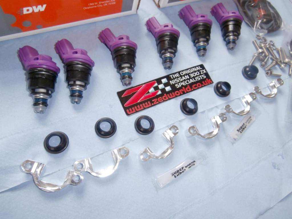

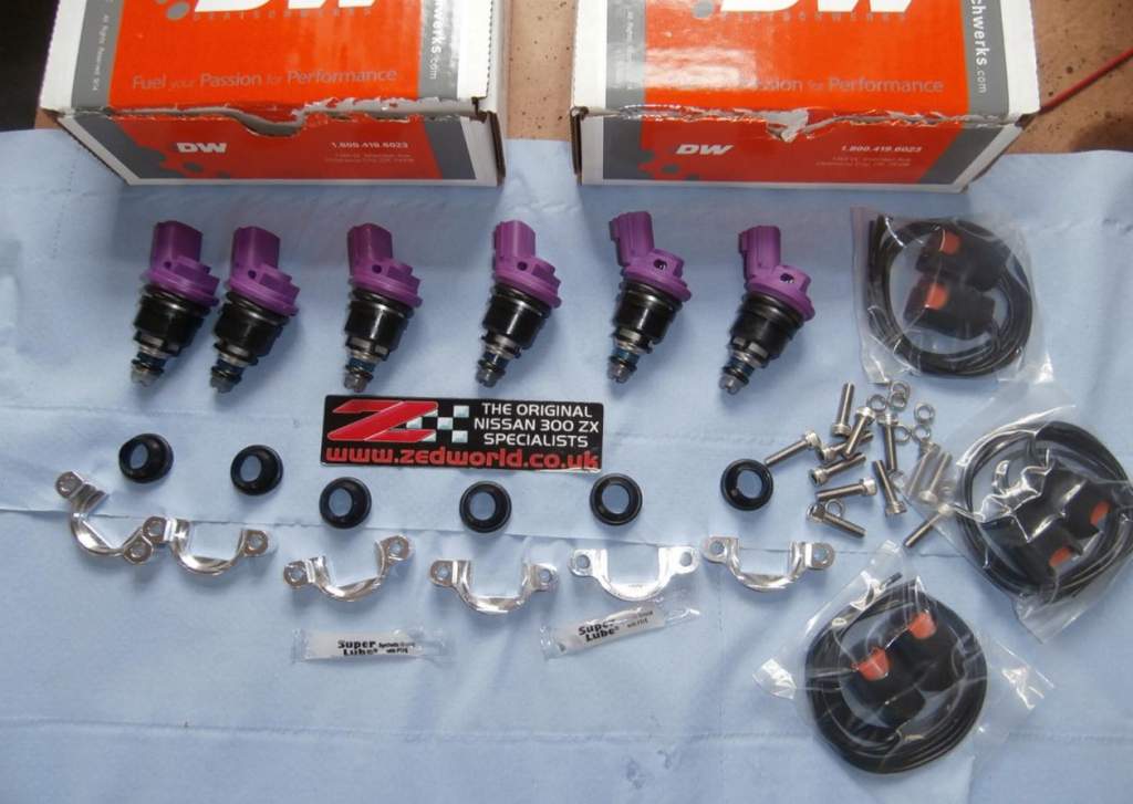

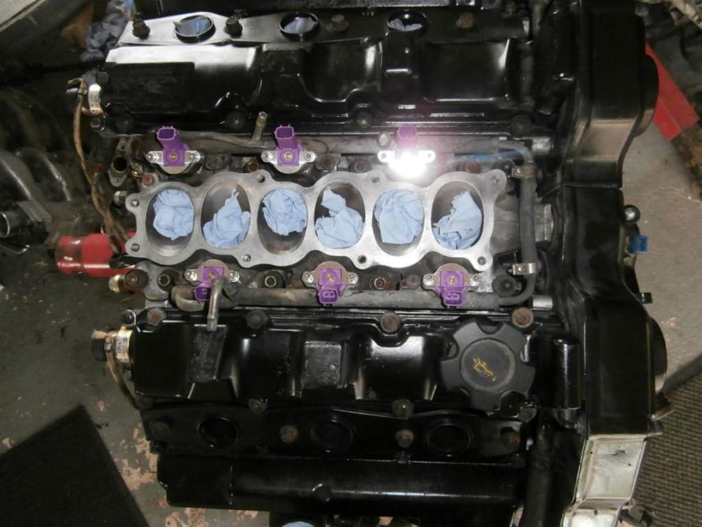

So lets look at the pics below, these are the actual injectors in question £600 worth, early style fuel rail adapters also at £120. the injectors are Deatschwerks a well tested and trusted company, not Chinese knock off, they come with a pintle spray report and volume certificate.

Quite why the flow pattern is not correct now is strange, maybe mishandled when removed ? who knows, problem with injectors is they are not good at been badly handled or and dropped maybe in transit unless in their original protection boxes.
Ok so asuming we are talking about the same Errol ( sure we are ) the op tuner who said they are Cheap Chinese knock off`s is talking out of his backside and whilst answering this with a calm tone I am really quite annoyed again how unqualified comments are branded about here about here, if someone has something to say fine , do your research before commenting or can look foolish.
