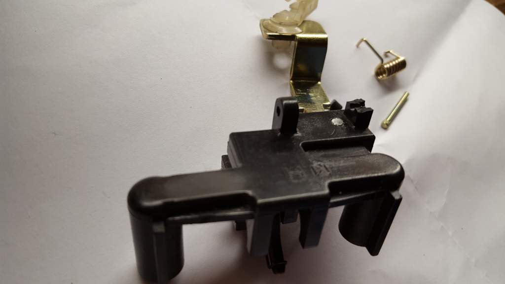

A very common fault and if you want a new latch then it's £60 plus postage from the USA. So here is how I fixed mine.
The plastic housing that holds the pin and spring breaks leaving the glove box unable to stay closed.

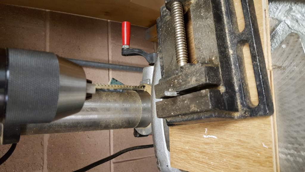

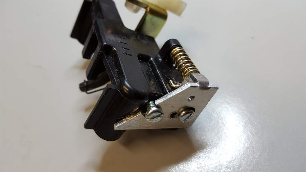

The first job was to get a length of 6mm acrylic rod then drill a 2.5mm hole in it. This will hold the pin for the spring.

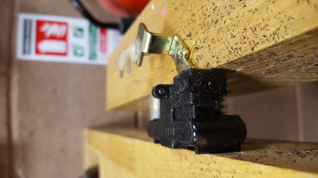

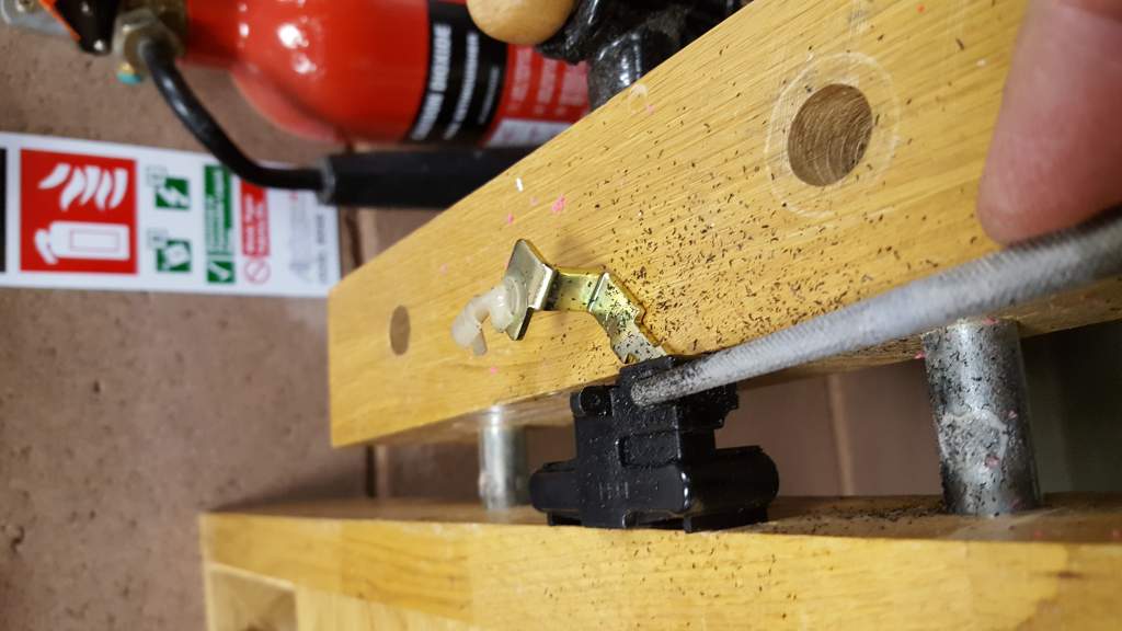

Then using a round file I filed a grove where the acrylic pin holder would sit.

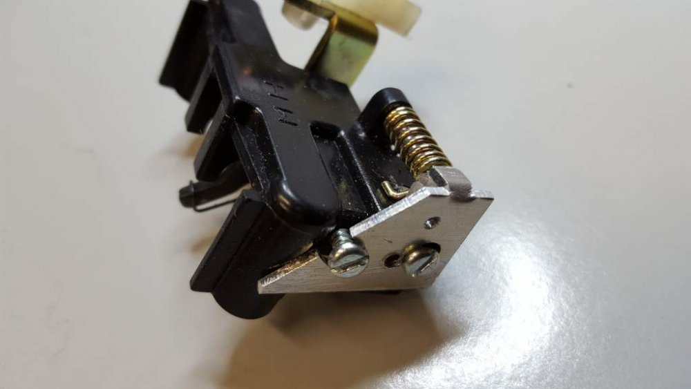

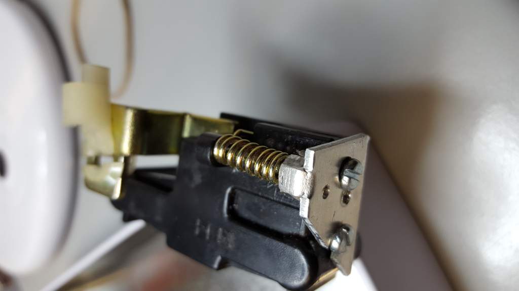

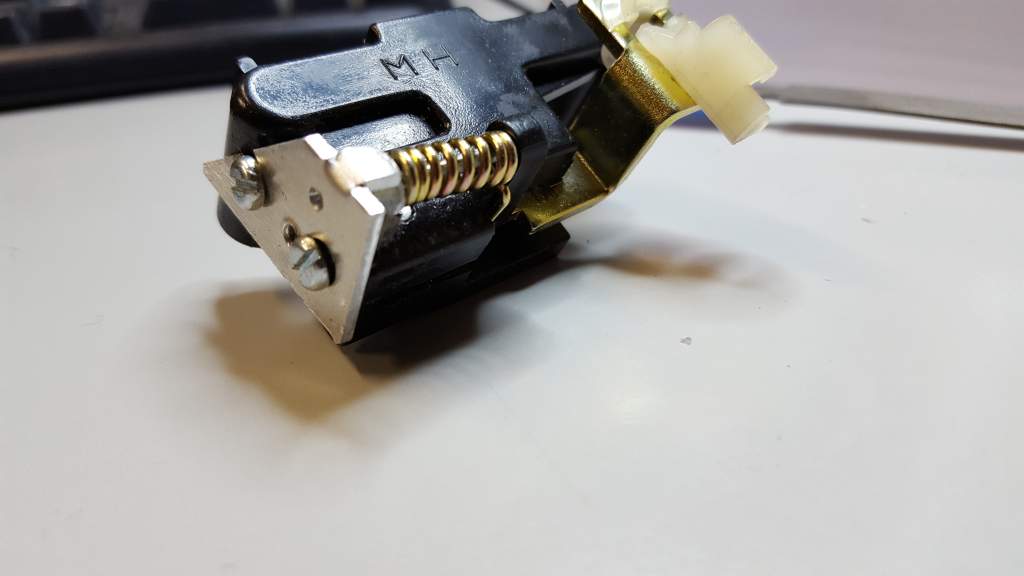

Then I cut the acrylic rod to length and glued it into the grove I made. A few hours later I fitted the pin and spring into the new housing but it was clear that the glue was not going to hold the pressure of the coiled spring so I screwed a small aluminium bracket on the side of the latch to hold the spring housing in place.

Strangely enough, I saw that spring on the floor under my breaker. Now I know what it's got and will need to rescue it!
