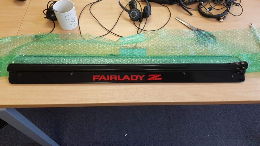

You would never guess what colour it is?
[ATTACH=CONFIG]106341[/ATTACH]

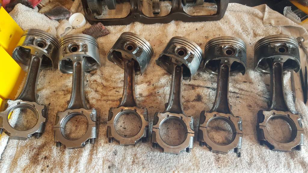

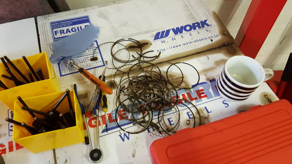

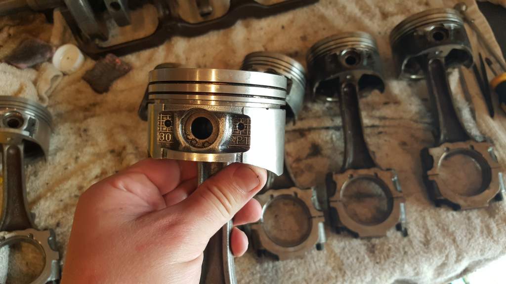

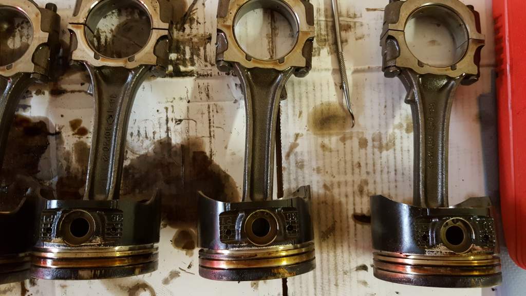

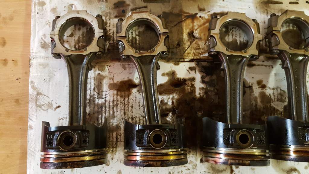

Moving onto the pistons i'm glad that I decided to crack on and strip it completely as I had a cracked piston ring on one.
And a few other cracked as I took them off, very fragile these are.
Just a cleanup job now which i'm not looking forward too.
Pistons are very good condition with just a few areas of carbon that can be cleaned up.

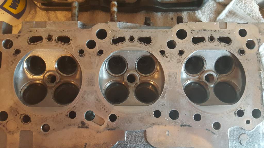

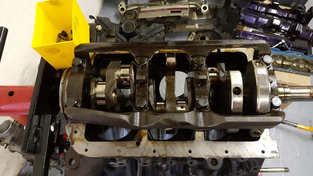

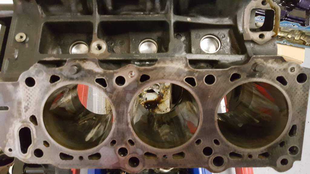

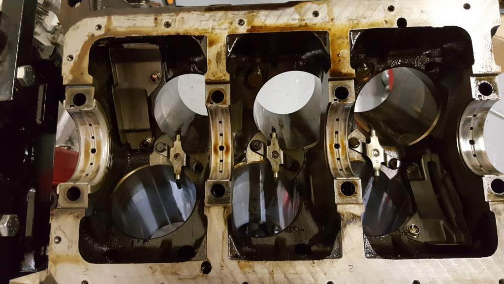

And looking into the block the cylinders are very clean indeed.
Good man, peace of mind taking it back to bare block :thumbup1: Assuming you can put it back together that is :scared: and work :lol:
This would be scary for most people but I've got a good engineering mindset so I found it very easy.
I've new gaskets, stem seals, bearings and piston rings on order.
Looking forward to rebuilding her but it's a bugger to clean.
My thoughts are to buy loads of white vinegar and steap the whole lot for a few days.
Try avoid cleaning the pistons too much apart from the ring grooves if your not lightly honing and buying new slugs..the carbon build up acts as a natural secondary seal and can help against a wheezing motor down the line;)
yes, they are all in order along with the lifters and will be going back where they came from. :)
