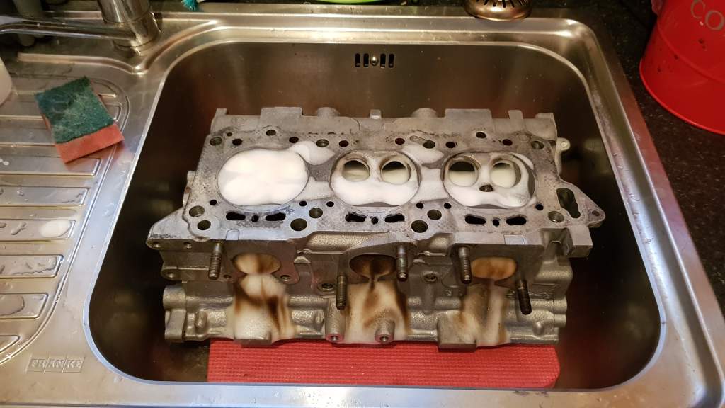

Working with a £20 budget to get this engine cleaned so went to the local kwik-e-mart.
Never would I have thought 5 minutes later I would be walking out the door with a Big-D.
Big-D as in Oven Cleaner. :)
Bought a few cans and its great for removing all the built up carbon inside the block.

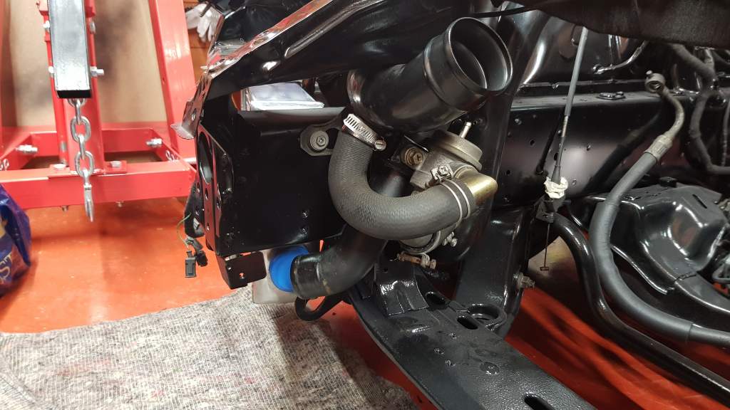

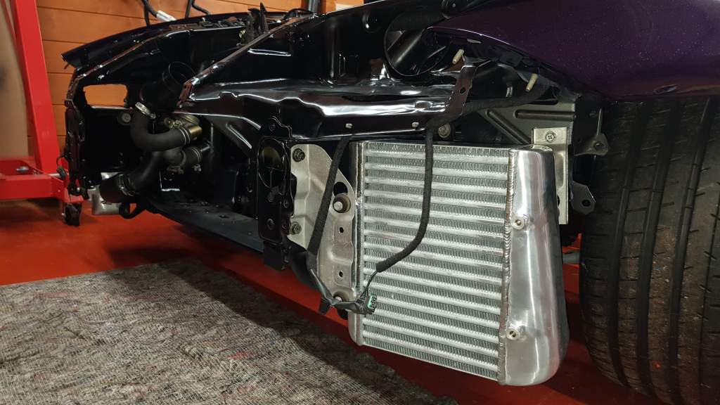

New intercoolers were fitted a long time ago but I originally had issues fitting the rubber piping.
This time I took the intercoolers back off and used some brute force and lube to get the pipes fitted.
After getting the pipework on I lifted the intercooler into place and tightened everything up.

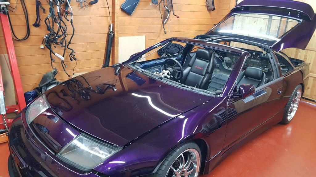

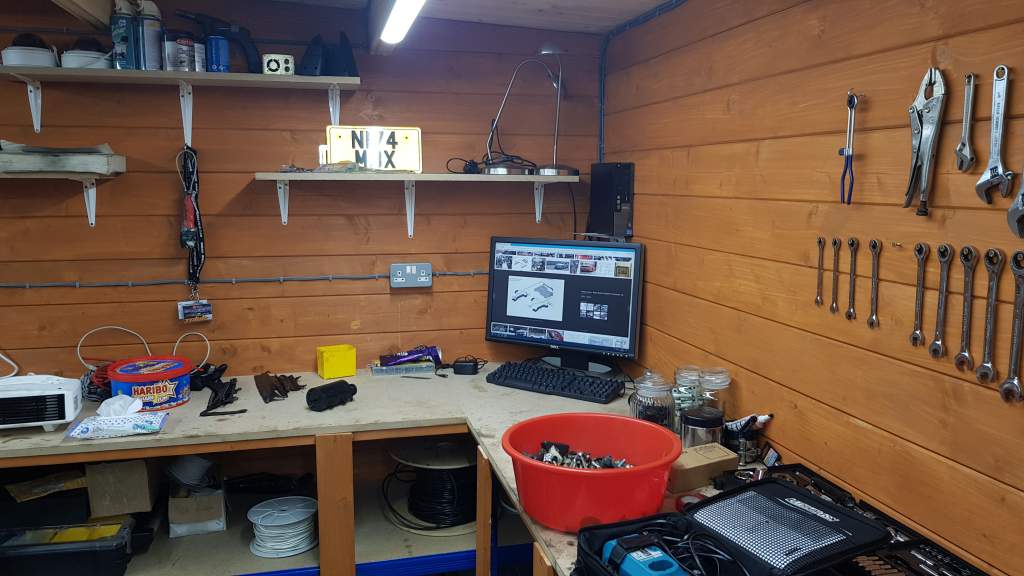

Not really a build update this one but last week I managed to get the internet cable routed up and now I have
a spare pc and a large monitor setup so that I can lookup anything zed related and catch-up on the forum without
having to come back in the house.
[ATTACH=CONFIG]110967[/ATTACH]
Love that workshop matey:thumbup1:
Thanks,
Its custom design & built especially for my zed, although it seems to have filled up with loads of other stuff too.

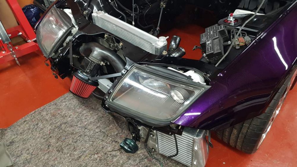

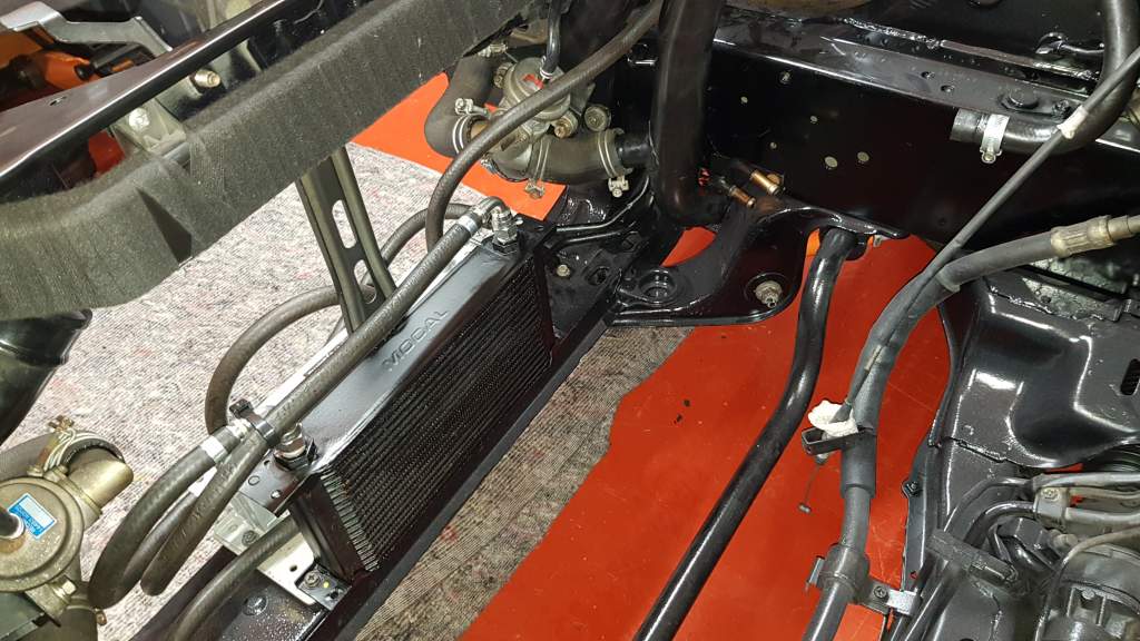

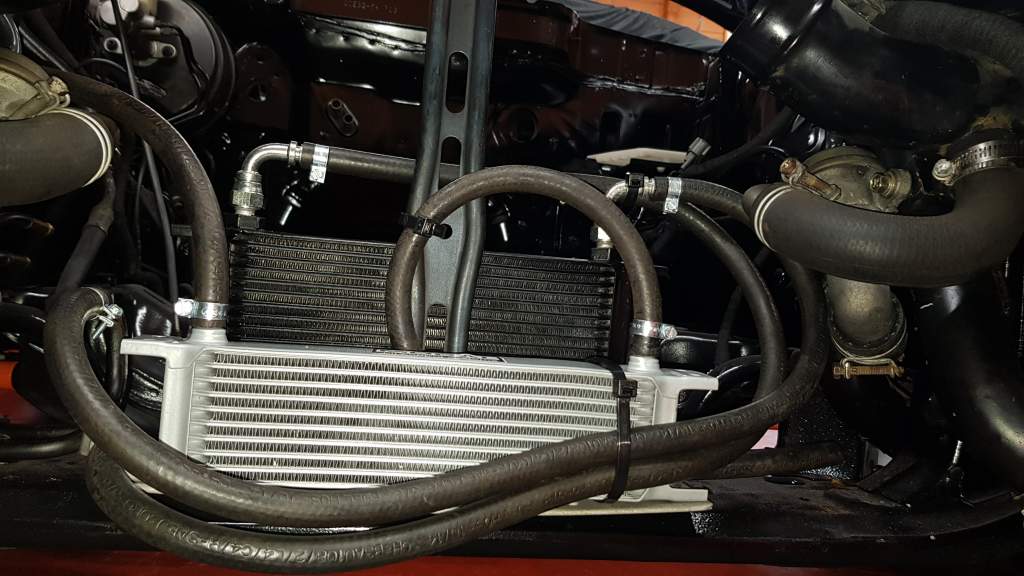

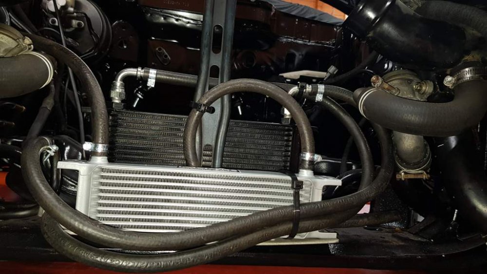

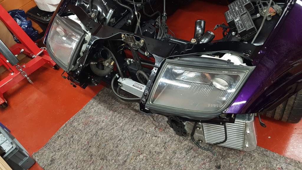

Intercooler and piping was completed yesterday so I moved onto the oil cooler and hoses today.
Used the same two Mocal radiators from my last build as I've completely removed the AC on this build too.
Forgot to fit the oil hard lines prior to fitting the bovs and piping to the left so a bit of bodgery to get it fitted.

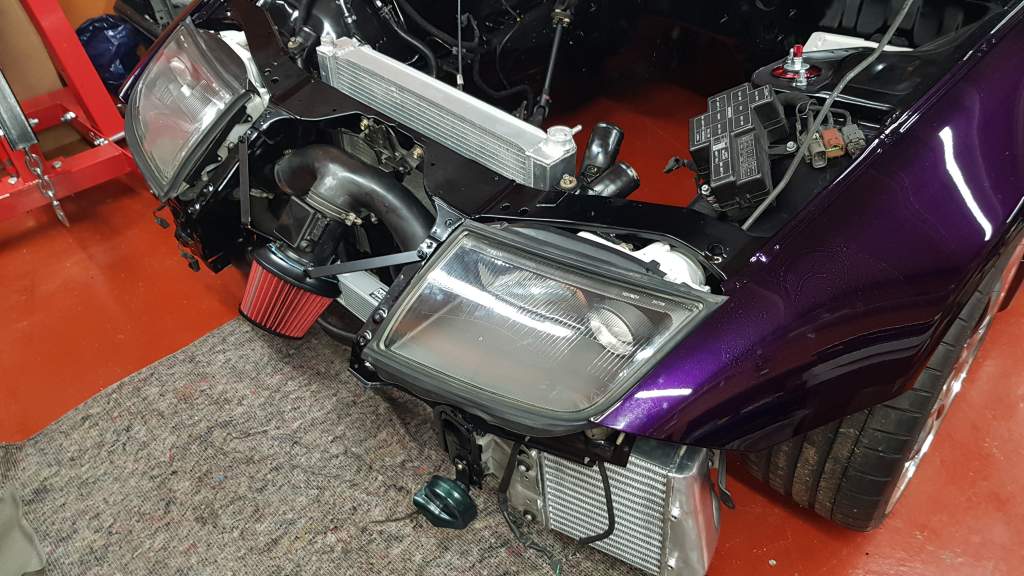

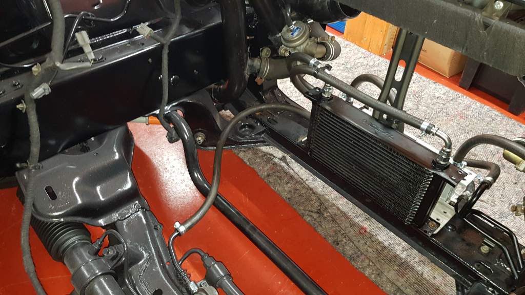

As I managed to damage the steering pot hard line again I've used a small radiator to cool that line just in front
of the larger cooler for the engine.

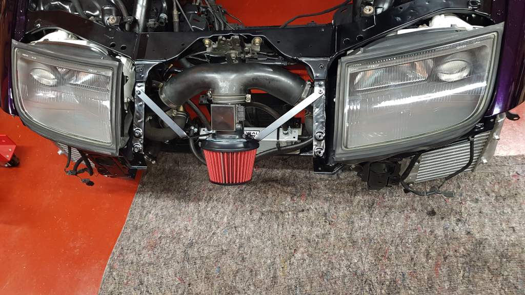

After that I popped the radiator in for good measure, but it will be coming back out when I fit the engine to ensure
I don't damage it.

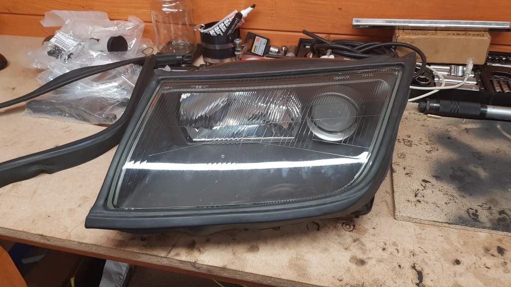

I gave my spare headlights rubbers a real good deep clean and treatment with Carbon Collective's rubber restore and they came out amazing. On my other set of rubbers I used the megs rubber gloss thing, but only lasted a couple of weeks.

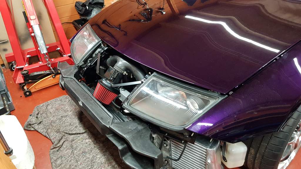

Not much happening on my zed build at the moment as i'm awaiting an order from concept.
Today I just cleaned up a few things and replaced some visible bolts with more pleasing to the eye ones.
Also fitted the rear wiper motor and pulled through the passenger side cable harness on the tailgate.
I spent more time cleaning out the garage to make more room so that I can start on the interior;
although half of its hopefully getting sent to Mondo so not sure if there is event any point in sending it.
So much to be done yet its all delayed because of what needed in the concept order. :(

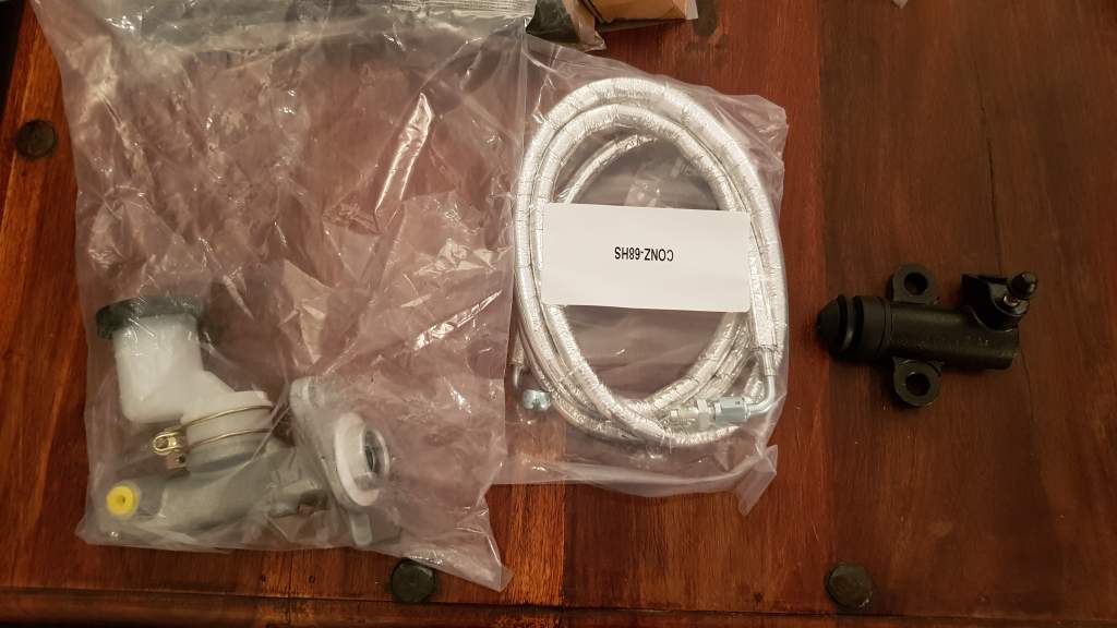

new clutch parts ready to be installed at the weekend.
