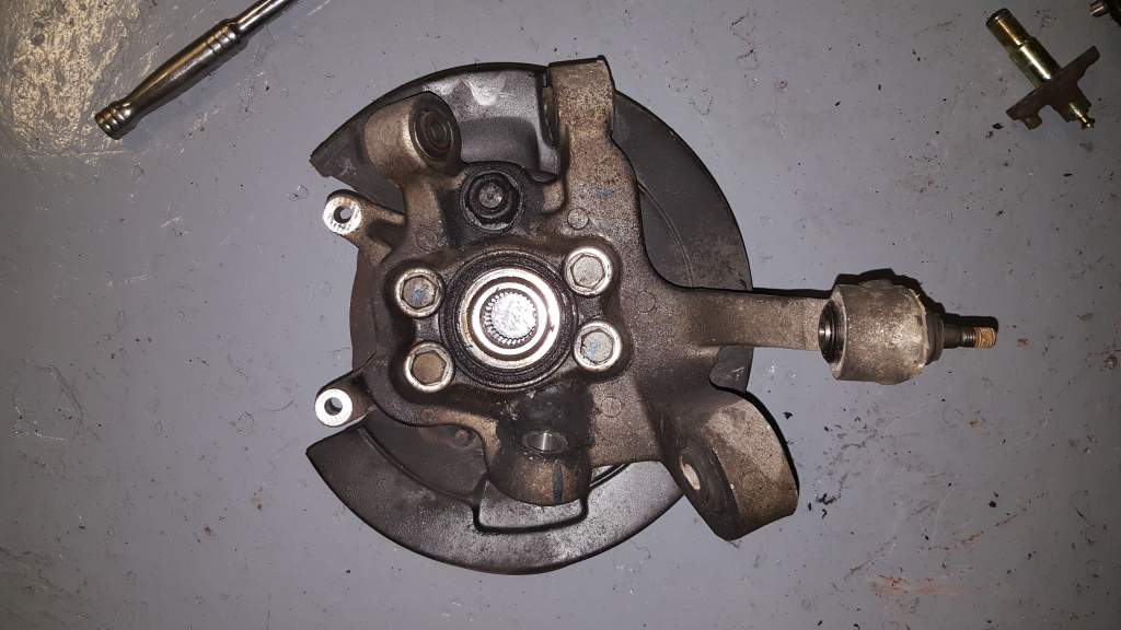

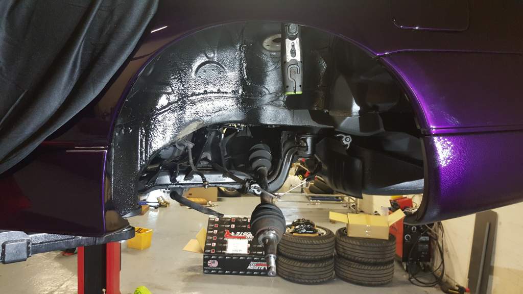

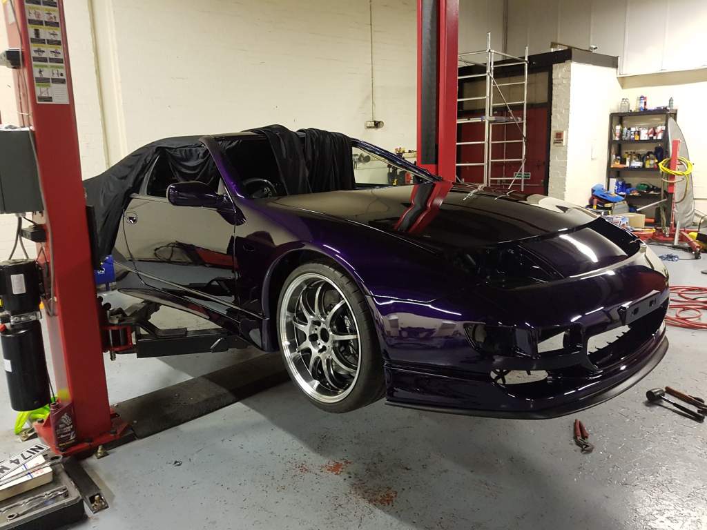

After a few hours and lots of pain I finally got the back end of the zed stripped.
Managed to disassemble the left side hub and knuckle without issue but I have a stuck bolt on the other with no way to get it off.
I have a large breaker bar but I don't have a vice or a way to keep the hub from moving as I try to turn the bolt.

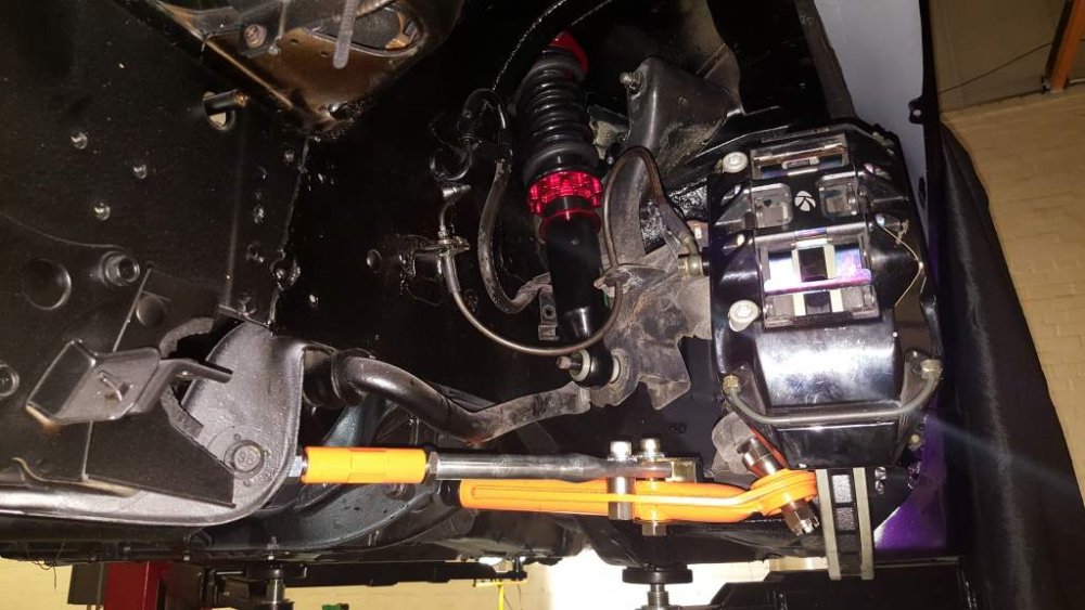

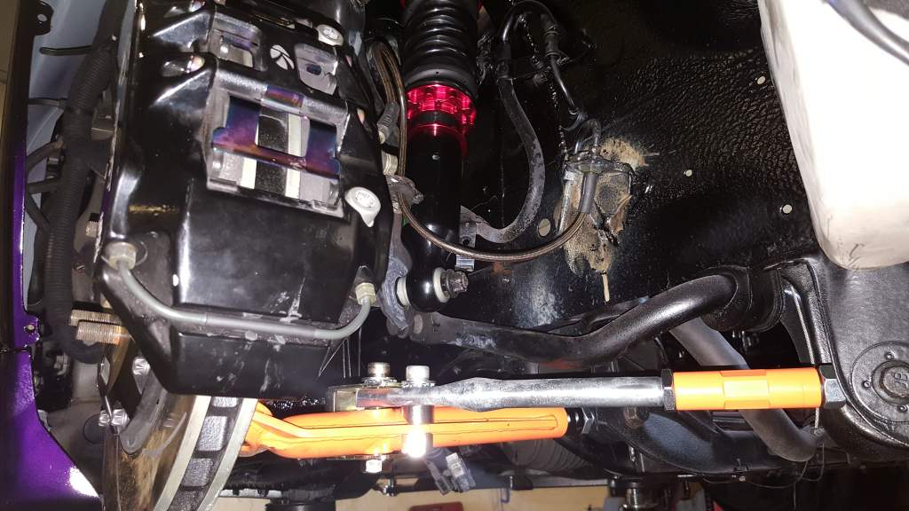

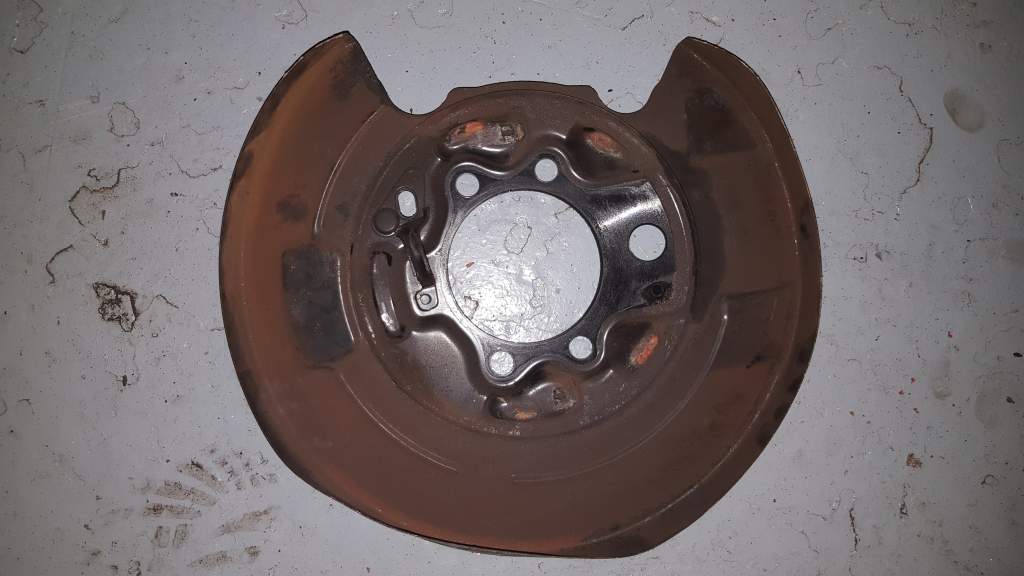

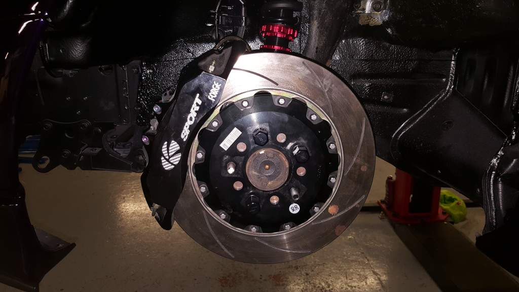

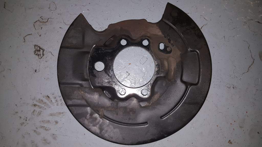

Few hours on the zed today and started the suspension over-hall with the drivers side being partially done.
Removed old brakes and also the dust shield so that I can fit my KSport big brakes.

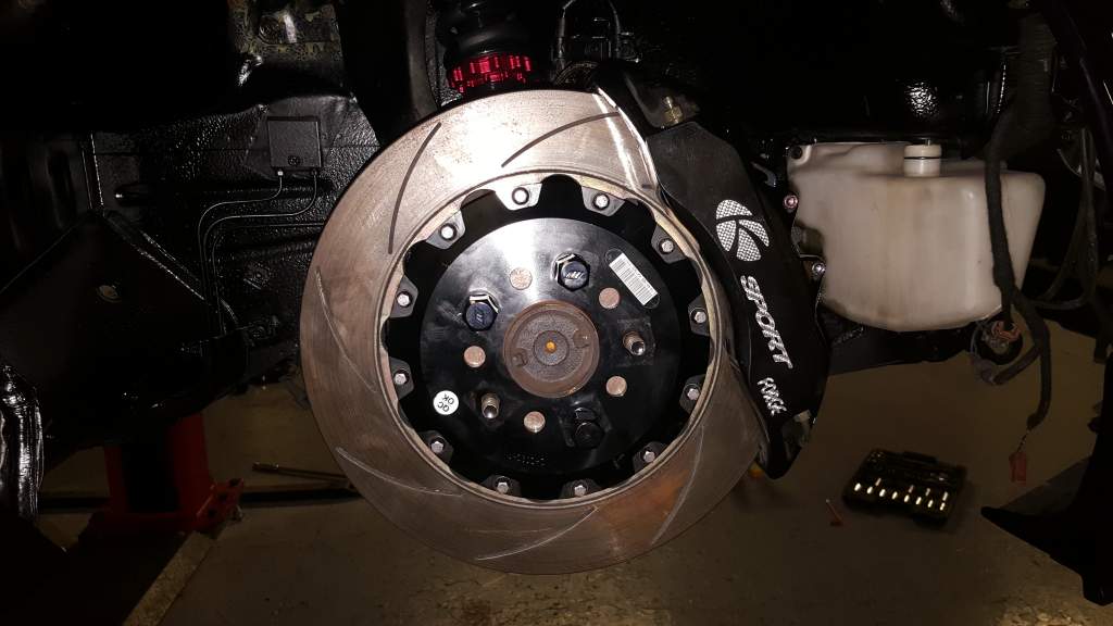

Lee,
you might wont to look at the K Sport instructions again, as I think that your disks are mounted incorrectly, as the "cooling" vanes in the disk should be round the other way.
Don't have instructions as I picked these up second hand, although they are in nearly new condition.
Are you talking about the inner parts of the disc ?
So just swap the left and right fronts and its sorted ?
Lee,
No problem, I remember spending sometime looking at the instructions before fitting mine, as usual the translation of the instructions could be better.
What didn't help was that my brother has K Sports on his Legacy, which I had used as reference, turned out his were fitted incorrectly.
Done two jobs today on the Zed,
First took 20 minutes and that was to switch the front discs around as they were on the wrong way.

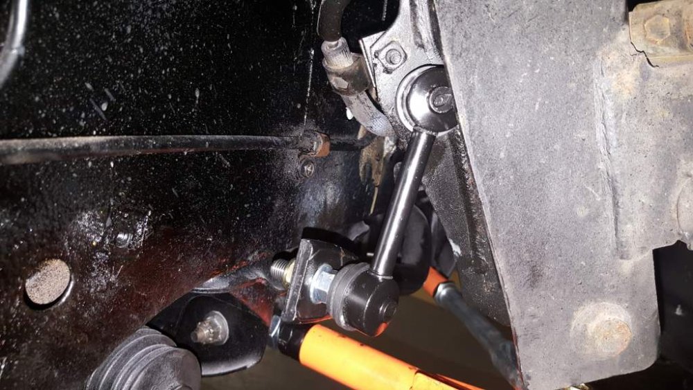

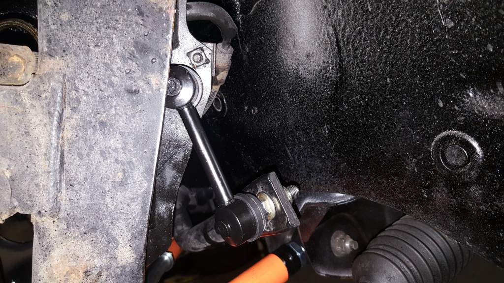

Second job took closer to two and a half hours; why is it the smallest of jobs are the worst ones to do?
All I had to do was swap out the front droplinks for new ones, but no one had to get stuck and I ended up
getting the grinder out and cutting the damn thing off.
Not a job I would like to do again.

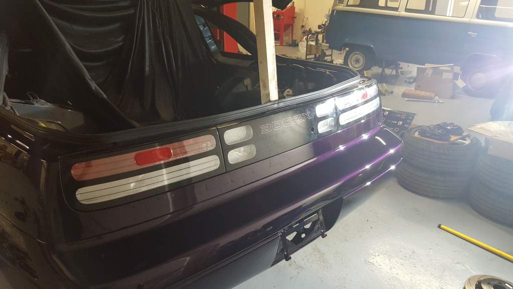

Heading over the the working garage in an hour so have a few jobs to do on my list.
Thinking of fitting my spoiler, tailgate plexi / brake light, wing mirrors.

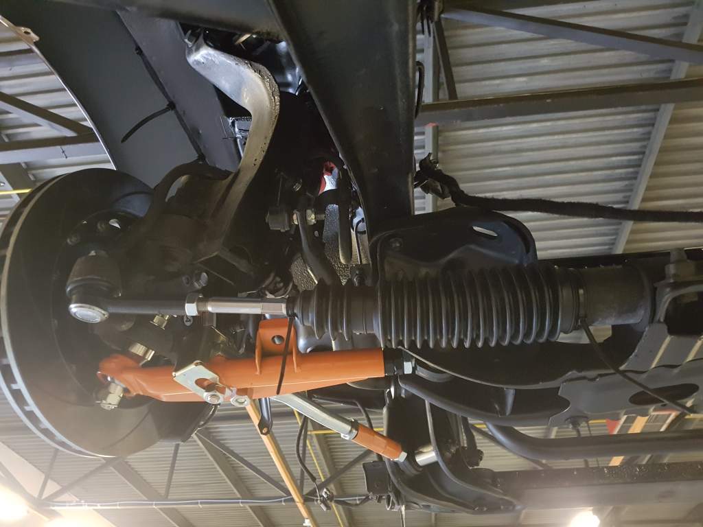

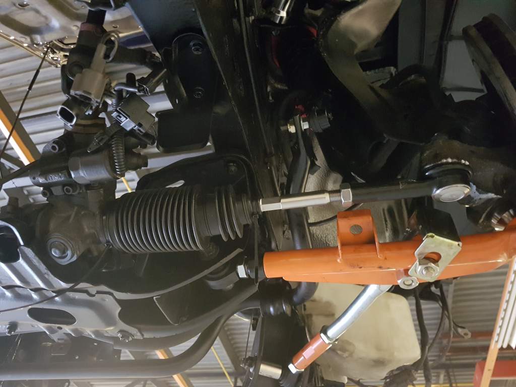

First off was I fitted the new steering control arms.

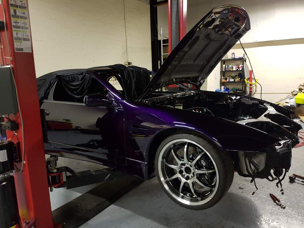

Worked on the wheel alignment a bit to try fix the wonky steering angle I somehow managed to get.
Also got the door rubbers on followed by the wing mirrors.
