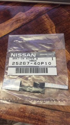

I love buying new OEM stuff, even when I don't know quite what it is! I'm due to replace my dash soon as I have found a replacement in near-pristine condition. Mine is ok, but this new one is VERY good.
As a result, I thought it high time to replace the AC/hazard carcass and the screws. Whilst I was looking at the parts on F.A.S.T, I noticed another part 25267-40P10 which I assumed mine 'should' have. I don't know what it is, so I just ordered it anyway. Does anyone know what it's for? I can't quite work it out. I'm picking it up from Z1 when I fly over there in a couple of weeks so don't have it with me to 'try'.

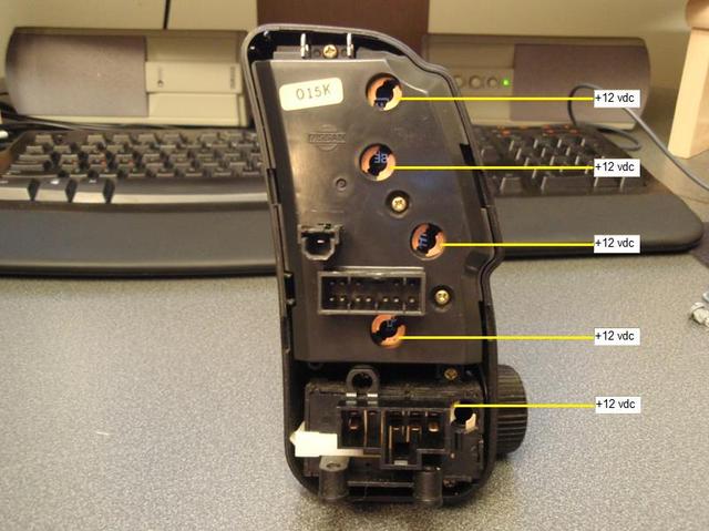

Is it anything to do with sheilding the LED's on the back of the pod ?

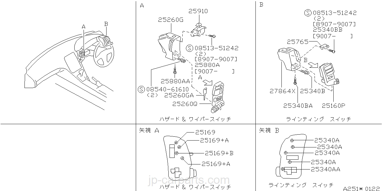

Nissan shows part number 25260GA for something similar on the left pod :

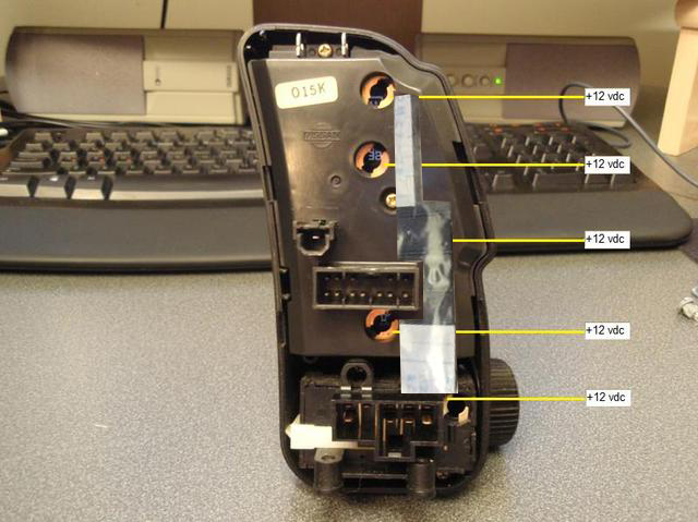

And if you look at the part it lines up perfectly with the LED's and goes round that socket :
Oh I see, interesting. Probably unnecessary, but it's an over engineered car, so I'm glad I got it ! :lol:
Having taken many apart i cant say ive seen it, as a bracket, there is a film that protects the circuit board on the back of the AC pod when you take the rear cover off, but doesnt look familiar. Im going to have to take one apart now to check :biggrin:

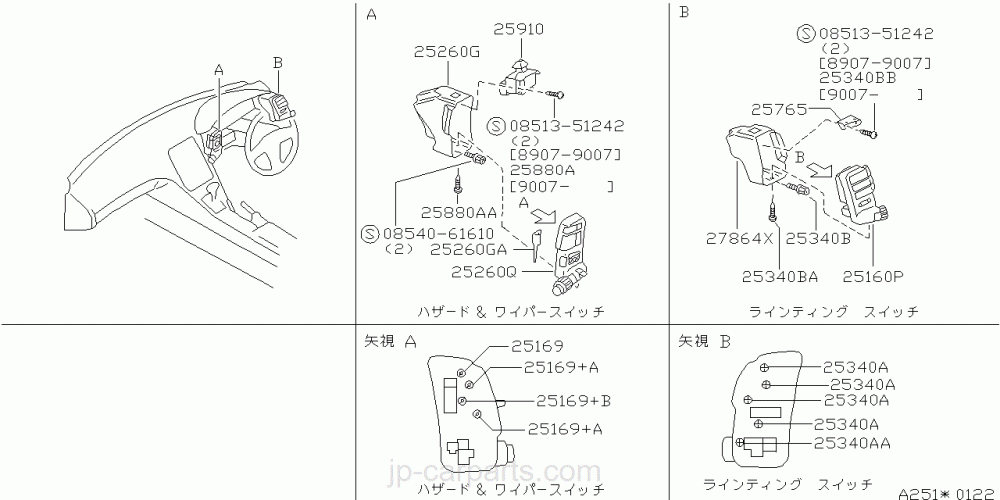

Could be put the part mentions 'B' which likely denotes Pod B which is the right side pod.
Its the wiper part that i assumed was the aircon pod, also the part number Andrew posted shows the aircon pod showing the only possible shape of that part
http://www.jp-carparts.com/nissan/pa...ype=33&fig=251 (part code 25260GA)
Some light diffuser for the aircon pod screen
