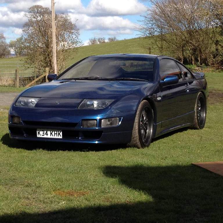

Keith Newport i think runs a 9.5 on his front
Oh wow. If there's no issues with that I could go for my first choice rim which would have to be a 9.5 front..
Keith's
But his suspension is not lowered too much.
Keith's
[ATTACH=CONFIG]101367[/ATTACH]
Mine is on stock suspension so I'm not too worried about that. Just rubbing when turning left/right, thanks for finding the photo

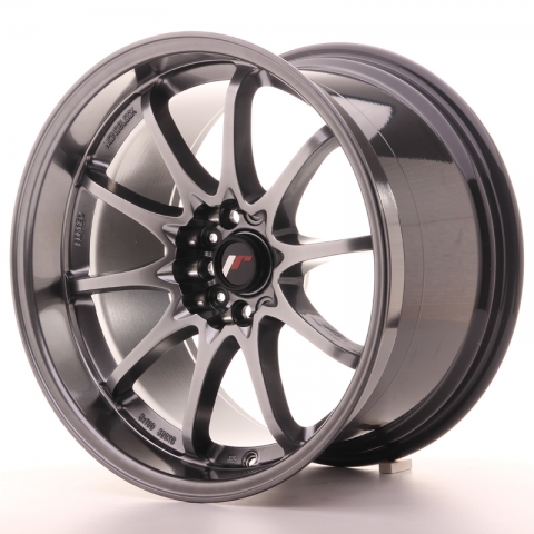

So this is what i was looking at, i think the Front would be okay, but my instinct is the rear will likely by off.. not sure it makes too much a difference but the rear arch is widened roughly 1 inch.
Front: 18x9.5 ET38
Rear: 18x10.5 ET12
Is my instinct correct?
Rim
FYI Keiths fronts are my old rear wheels off my white zed, cruise 190's I believe so you could probably get the offset info of ebay. Im pretty sure Keith runs meister R coilovers so if you are running stock shocks they should clear.
Thanks for the link Chris,
These are the results i got against the stock front and back size and offset, do these seem reasonable? as said a few times my rear arches are approx 1" wider (25.4mm)
Front 18x9.5 ET22
Inner Clearance:2mm LESS (the inside of the wheel to the strut housing)
Outer Position:EXTEND 48mm (position of the outside edge of the wheel)
Rear 18x10.5 ET12
This seems like it would work?

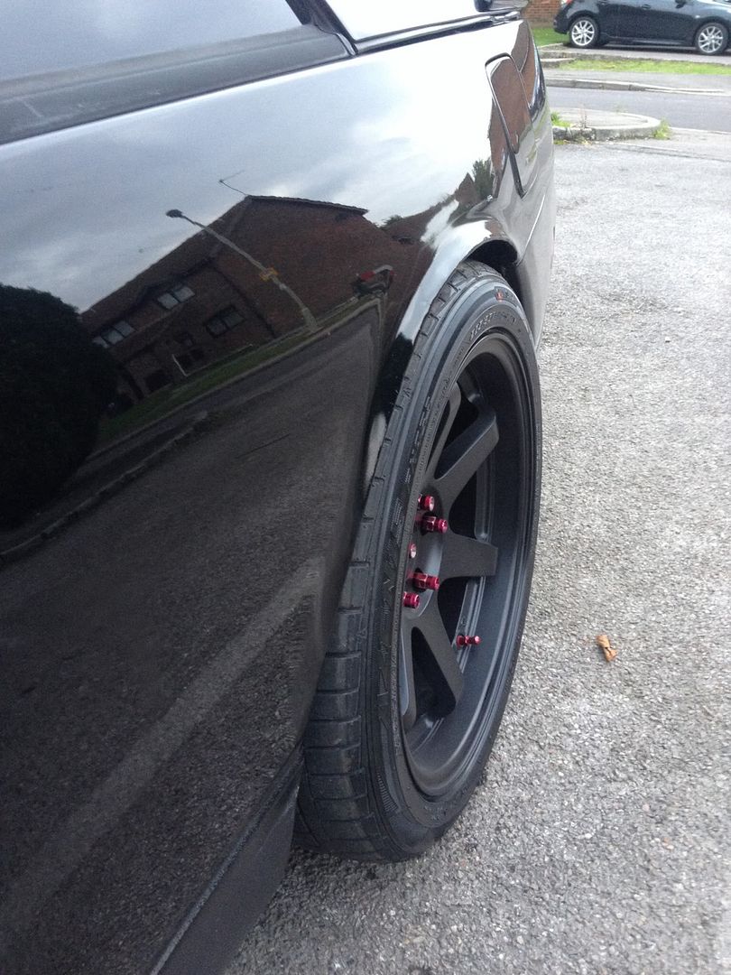

Mine sit 38mm further out at the front, this is a really crap photo but best I got at the moment
Depends what tyres you want I suppose
Oh and mines on lowering springs
What width are they? Do they sit flush with the arch?
In terms on tyres, I'd go for what fits without being ditch finders..
8.5, I have 12mm more inside clearance than stock. I consider mine to be pretty much flush
That's pretty much all the photos I have though!
With the extra height you may get away without stretched tyres. But stock suspension is also pretty soft so you could end up hitting them over bumps. Hard to say and I'm hardly an expert, but personally I'd be wary of having non-stretched tyres on those. Not that I like stretched tyres :-P

5fcc2a5ab2377968ea5c2f703e27fde5.jpg this is the size of arch work I've had done. Those look like a great fit
