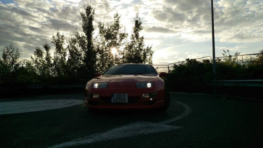

Yes I installed my ballast inside the fender. There is already a hole next to the headlight so just feed the plug through, and cable tie the ballast in tight.
It was probably easier than getting the headlights out as the wind is only 7 easy access bolts.
But put it where you see fit.
I used 6000k because I like the cool blue look as it makes it look more modern and it was brighter than the projectors already in it. Pick your preference.
