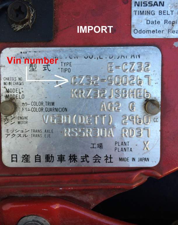

Lots of give away clues but the easiest is to look at the vin number on the slam panel under the bonnet the VIN number on import cars starts with Z or C and UK cars with a J
Jeff
Import one below

The vin is the quickest way these days as there are so many jumbled up zeds about now.

Vin starts jn1.., uk
Anything else cz, gz or just z etc import,
UK chassis numbers are much longer....
In a nut-shell.....:wink:
All cars first used/registered in the UK - irrespective of make/model - have a 17 character VIN.
