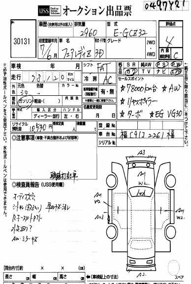

That still doesn't sound right to me. Do you have the export cert?

Was in reference to the "new number" having "fuku" in it
Oh :lol: my bad
The word fuku is Japanese is a general term meaning happiness,good fortune

Yes and this number is written in it as the identification number. Was won through one of the auction houses so I suppose that counts as public

That's not a normal VIN anyway. There's probably some explanation on the sheet.

Yea I had just read that Ali, the export certificate has what is supposedly the original chassis number on it so I'm wondering whether it would be enough for the dvla to allow me to stamp it back on.
I did get sent a translation of the sheet and it doesn't say anything about it. So I'm wondering what the auction house would do if I said the car wasn't described properly. If I can get a partial refund and the dvla let me re-stamp the number (big if at this stave of course), then have I lost out? Possibly not.
