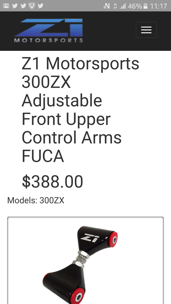

These are what you're looking for??

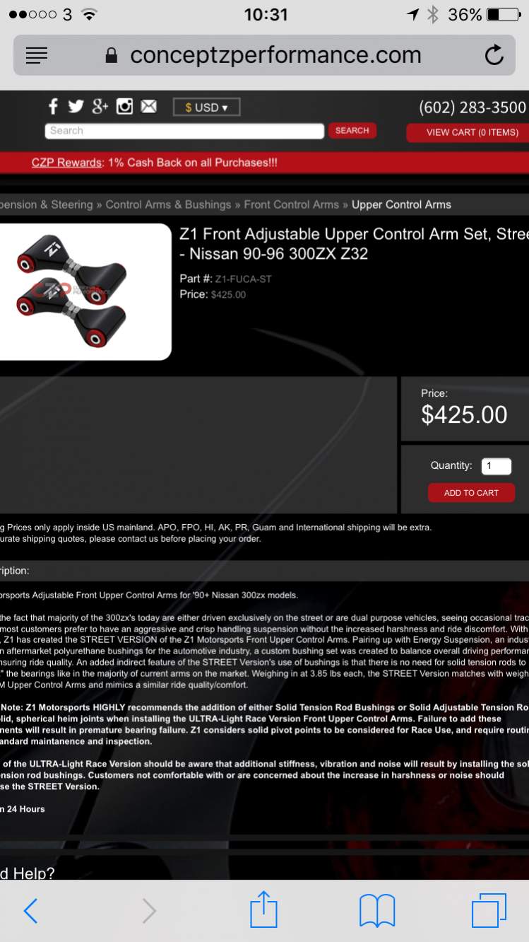

I have these, they're very good. MUCH better than the awful solid bearing FUCAs and stronger too.

Are yours the ones that people in the US are saying the bushes don't last very long on, Si...?
I've seen two occurrences where that's happened and probably because they fitted them the wrong way round. I have had no such issues. The amount of failures of solid bushed Midori style FUCAs I've seen is extremely high, sure there are more in the market place, but they are known to be troublesome.
