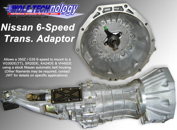

This question may have been asked already, i have got hold a 6 speed manual gearbox from a 350, can it fit onto a 300zx engine with much bother.
regards big mo
There is a sandwich plate adaptor to do the conversion but heard the boxes are chocolate....
gearbox being weaker is all "internet hear say"...it's actually quite a good box and I doubt it's weaker then a 300ZX box.
The 350Z rally team we have here in Holland only breaks axles and diffs..we haven't had a gearbox fail yet
Howver, it needs a fair bit of parts and modding to get it into a 300X.

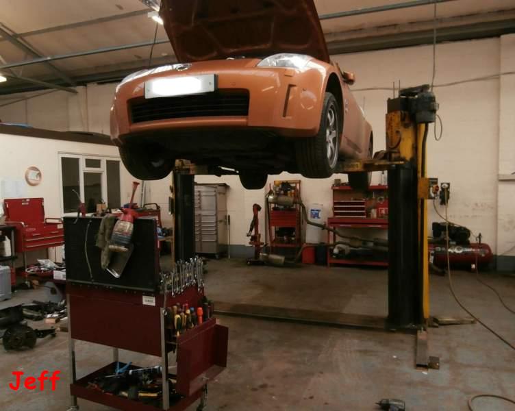

In road use cars they can quickly become noisy at idle and when accelerating in lower gears, this is what is probably meant as a weakness, in rally situation noise will not be a problem, earlier box is best as the later one has a concentric thrust bearing and slave cylinder combo which can fail ( and do ) which means gearbox removal.
Jeff TT
http://www.300zx.co.uk/forums/showthread.php?173641-Friday-workshop-woes&highlight=350z+gearbox
http://www.300zx.co.uk/forums/showthread.php?168091-350z-clutch-dilema&highlight=350z+gearbox
http://www.300zx.co.uk/forums/showthread.php?171606-350z-release-bearing-quandry&highlight=350z+gearbox
