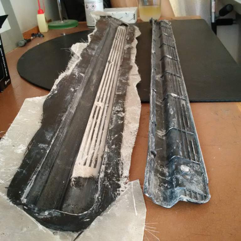

First second and third test of resin infusion. Initial two tests suffered from resin starvation, but I have the process and materials sorted now and the latest one is mirror smooth. This was 4 layers of 200g carbon twill weave.
I am just doing the final few layers of fibreglass on the mould for the sills and then I will run a test infusion for that. It is a shame that with limited time in the evenings this process takes ages as each time you leave the part to cure you have to wait 24 - 48 hrs!
So this weekend I will do the first infusion on a final mould - the drivers side door sill cover.
Very almost gave up when I realised how tricky the sill covers were with their tight little curves, but I think I got it!
Didnt get time to do an infusion last weekend but just completed a successful vacuum test on the new mould...
So it turns out that the mould is not air tight... Must have a micro leak somewhere as over the course of an hour the vacuum looses pressure.
So I am probably going to put the sill cover to the side for now as it has been an absolute mission getting this far and is just so hard to get to work. I have an infusion test in the mould at the moment but it isn't going to work annoyingly.
Will move on to a small part as I didn't quite appreciate the time this would take - Far more consuming than upholstery! And teh added annoyance of the resins and agents you have to use it is quite messy work.
This time it will be some seat belt rings for the bride seats as mine have snapped. They are quite small so hopefully mistakes wont' be so time costly.

De moulded my test piece today. Considering that it lost vacuum after an hour this has given me some confidence back - if I can fix the leak or keep the vacuum on without starving the part of resin then it may still work. The parts which stayed under vacuum are really smooth and could be polished up. Just one side I a mess haha
