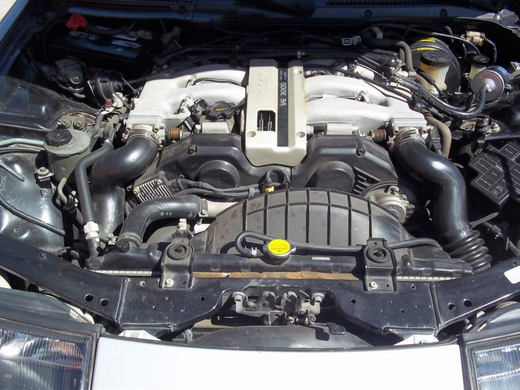

Early development car - Check out that terrible early intake pipework routing
....... and they still kept the rubbish headlights !!!

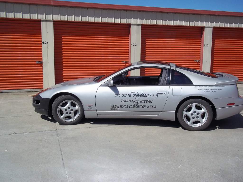

is it the same car from the advert? the interior shot the radio arrangement is different, repainted to silver ? surely Nissan had silver ones,turbo bumper on a non turbo Mmm and not registered ? all smells a bit fishy to me
Jeff
Edited by JeffTT
From what i know this was the stunt car used for the final jump scene not the actual main driving car. The fuel tank is rusted up with 20 year old fuel and from what the owner said in his forums post he couldnt start the car and was going to replace the fuel tank and pump.
Also they painted a black z silver to match the main silver driving car in the ad.

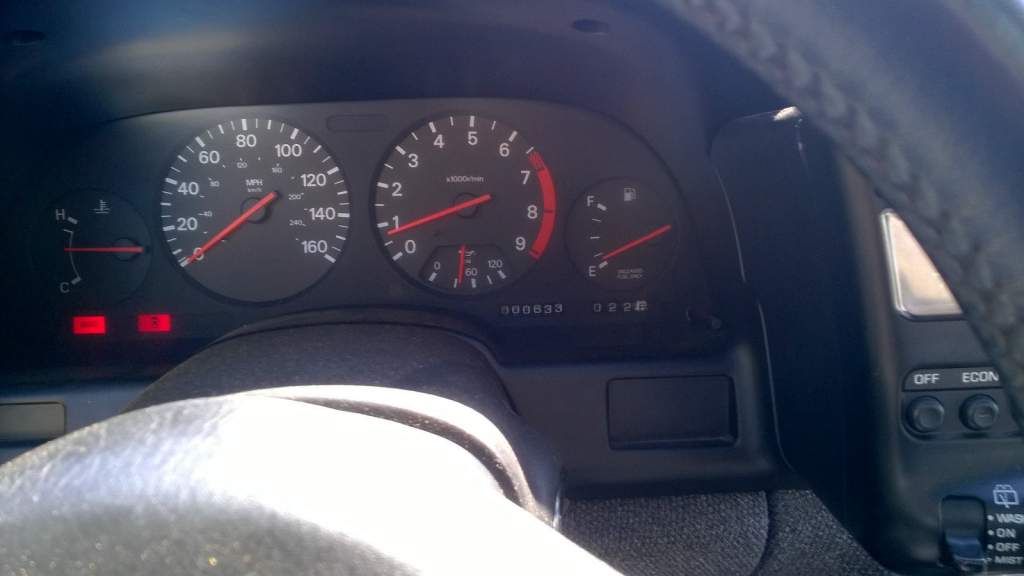

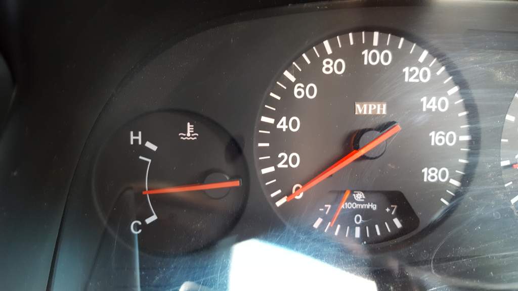

Is it overheating slightly?
[ATTACH=CONFIG]97265[/ATTACH]
Gary, you've been around long enough to know the coolant temp gauge doesn't work like that! When the needle drives up to "H" then it's overheating (likely followed by a catastrophic failure!), that position will be the normal operating temp for that gauge (they all vary slightly).

If you pop your reading glasses on you will see two little white dots. These would be level with the needle if it were in the dead centre position, or 9 o'clock if you do wish. That's where it's "supposed" to sit. This is where mine sits. As Joel said though some variation is common place.
The gauge is a simple stepper motor that uses the resistance value of the tempreture probe, this is a thermistor ntc type. The hotter the sensor the lower the resistance value resulting in a climbing needle. The stepper motor adjusts the reading in stages, I don't know the values, but as an example;
Cold 70-50 ohms
Normal 50-20 ohms
Hot >20 ohms
Something like that. Hope that helps.
Cold 70-50 ohms
Normal 50-20 ohms
Hot >20 ohms
