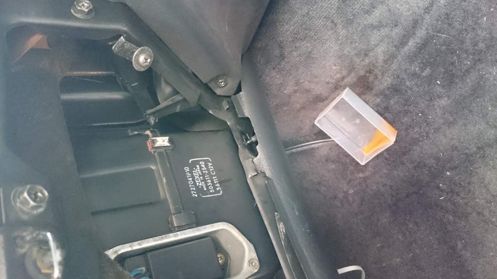

What is leaking in my passenger footwell?
Good bye heater matrix. Does it smell like fish curry?
ย
Most likely Heater matrix has failed, but could also be A/C drain pipe or Targa drain pipe.
ย
Rusty coolant
ย
All the above, mate.......:clover:
