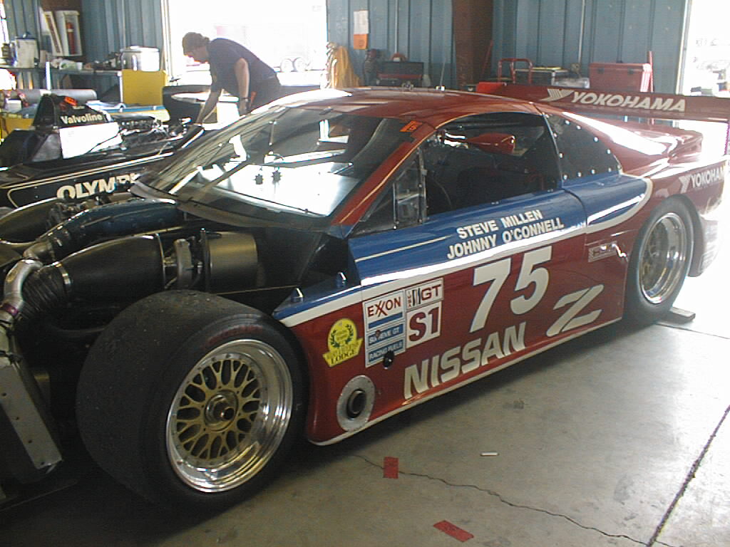

If you mean this car:
[ATTACH=CONFIG]96729[/ATTACH]

That's the one. It's not really a 300zx at all is it. I wonder if it's wheelbase is what's 2+2, maybe that's the basis of what's doing the rounds. I.e where this "information" has its basis. The shell, let's call it what it is body cover haha certainly has a 2+2 roof line.

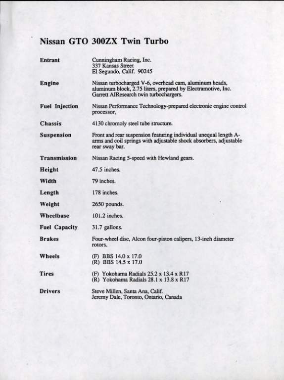

The specs:
[ATTACH=CONFIG]96732[/ATTACH]
There's the information. Wheel base 101.2" that's a 2+2s length the 2+0 is 96.5". So there we go, the stillen "******* 300zx" is actually a 2+2 wheelbase.
Interestingly the spec States it's a 2.76L twin turbo with an aluminium block. I wonder how many of those still exist.
Two GTO cars were built to that spec. Raced as numbers 75 and 76.
Its a bit longer than the 2+2 wheelbase. I bet they are running much wider Front and Rear tracks though - and its the Wheelbase vs Track ratio thats important
Everything I can find says the 2+2 wheelbase for the Z32 is 101.2" long and 70.9" wide. Making them the same length but the stillen car just over 8" wider in track.
I had it in my head it was 99"...but whats a couple of inches between friends ;)
I don't have a copy of the IMSA rule book for the '89 season, however as before the cars were required to visually
resemble the production cars (and in fact use elements from the production cars). The rules for the '87 season
stated that wheelbase had to be based on a production car and it is reasonable to assume that the wheelbase
rule was carried on. Hence for all the space frame wizardry of the 300ZX GTO cars the wheelbase is exactly the
same as the 2+2's.
