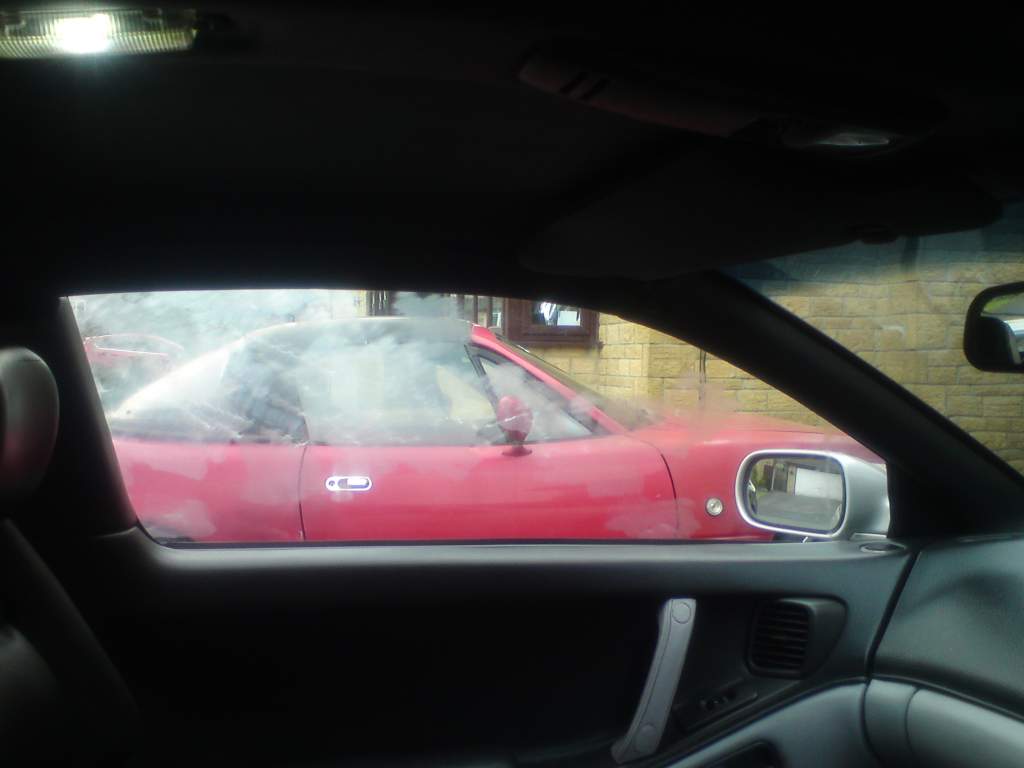

You can see below the scratches, felt with a finger nail so i knew these were classed as deep/bad, all done initially with window going up and down over 15+ years.
In my 'nothing to lose silliness' i even rubbed them by hand with 80 grit paper many many moons ago, made them appear worse than they are or were, this got the scratches 'back', well it would but wasn't the professional way forward and was slow hard work.

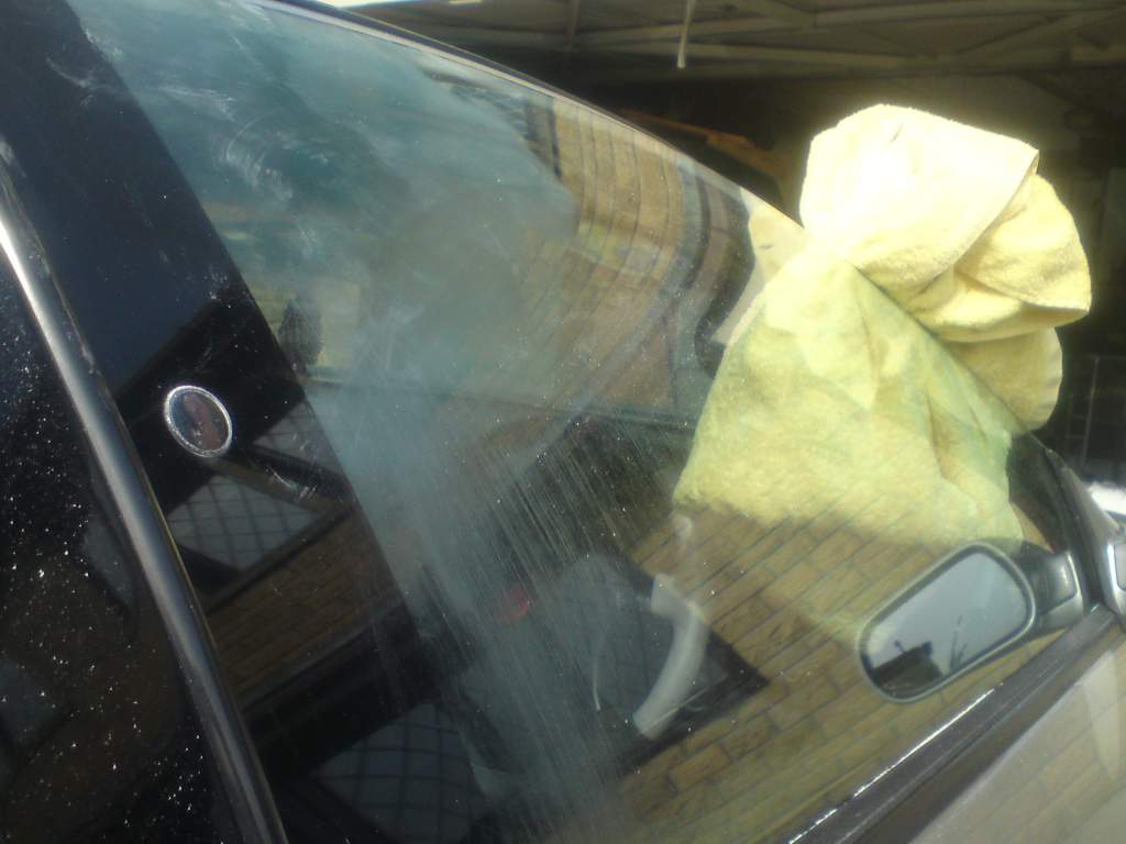

Towards the top left of the glass is where i have sanded, bottom left - yet to do. The towel is to hold the glass away so i can go right over at the top.
I admit doing them off the car would be ideal but there isn't a scratch really i cannot get to in situ and plus i can still use the car.
I bought some gp150 coarse for glass is this grit, 115mm velcro sanding sheets and used these on my drill attachment at around 2000rpm.
My L/H was not as bad as the R/H, this is completely done for now with this grade of paper.
I sanded right over the window guide peg, they want making less bulky anyway and i'll give these some tlc at a later date.

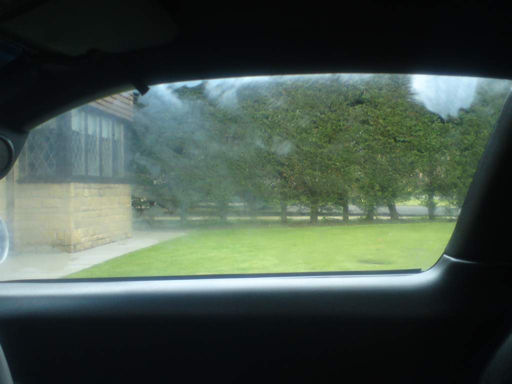

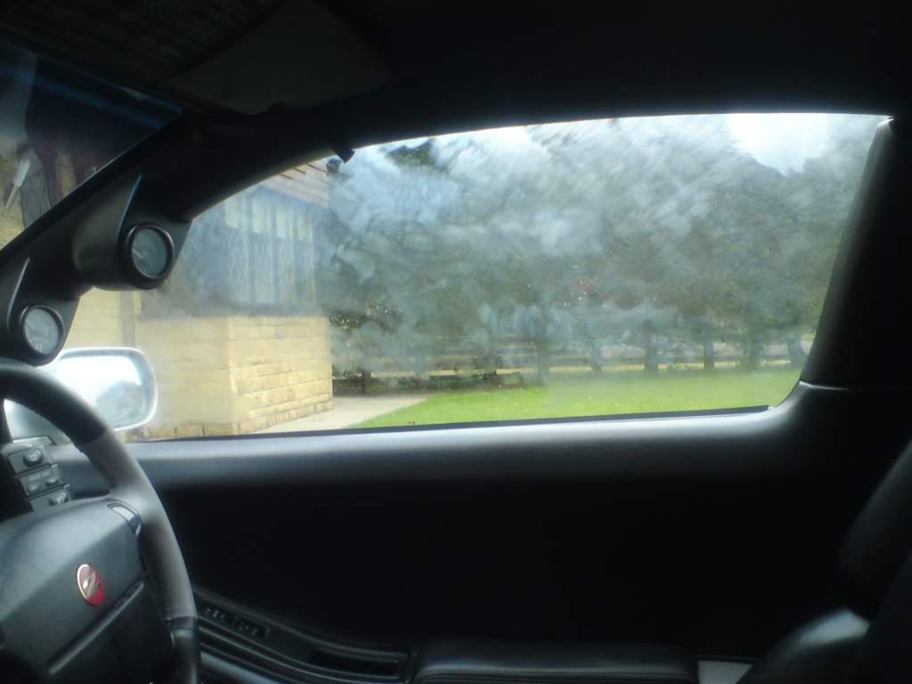

A view from inside and you can see i am left with cloudiness for now, it was my intention/plan to just try and improve but i have in fact done every little mark...god help me !!
Fyi the glass is 4mm thick, so what i am removing.........................0.2mm ?
Easier job than i thought really, just kept moving about the disc with just moderate pressure until each scratch disappeared before my eyes !!

The 150 has flattened out the deep scratches but as you'd expect it leaves scratches behind !! The 50 is too fine to get these out, fully expect the 100 will.
I also received today some polishing pads so i had a very quick go and i can see it coming back already on the right hand side of this pic, the haze top right is a bit on the inside i have not yet touched since the coarse grade.

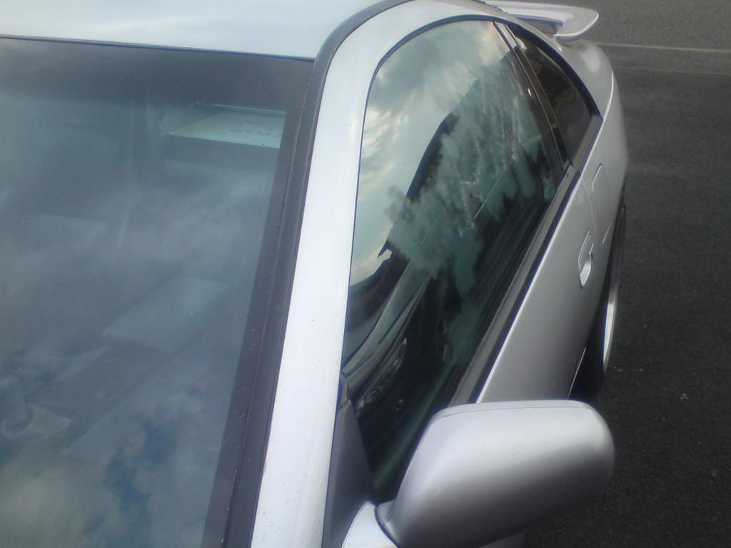

Since my update i bought the finest grade of paper for my disc, just to recap i started off with the 150 and this takes out everything, then down to 100, then 50 and then yesterday i spent time with my newly acquired 20 grade, very fine is this and it does feel like it is a pre polish paper.
Each paper as been needed i will again add - skipping is not an option.
I had something similar but i bought this item and highly recommend, it is top quality.
http://www.ebay.co.uk/itm/252203462159?_trksid=p2057872.m2749.l2649&ssPageName=STRK%3AMEBIDX%3AIT

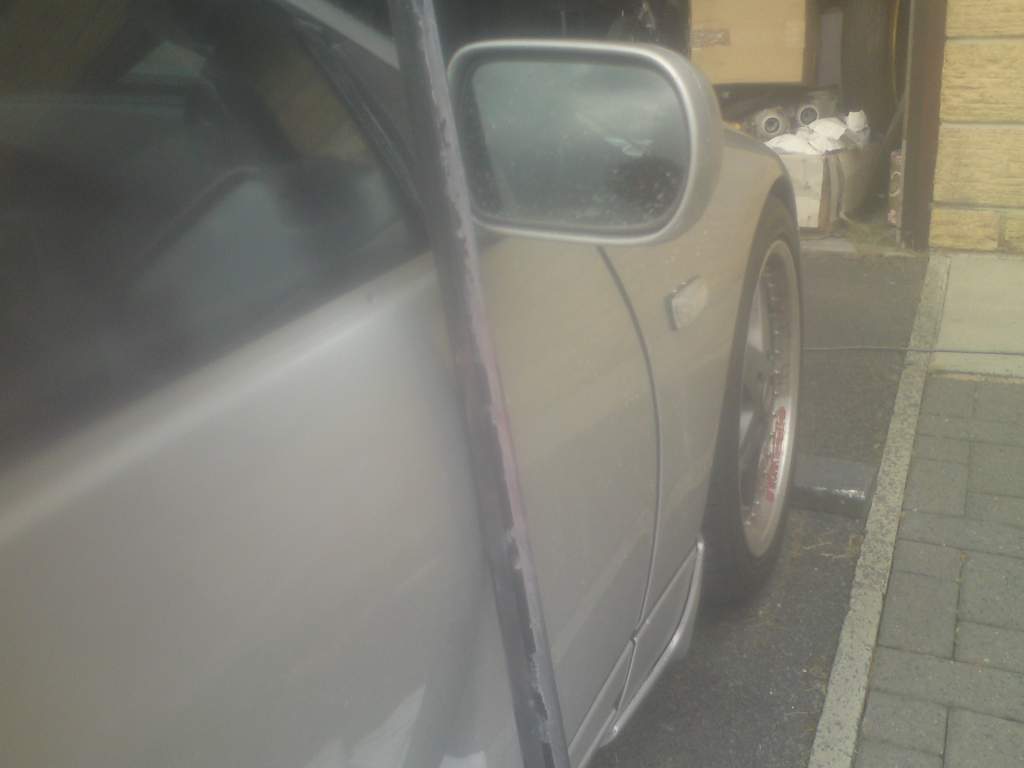

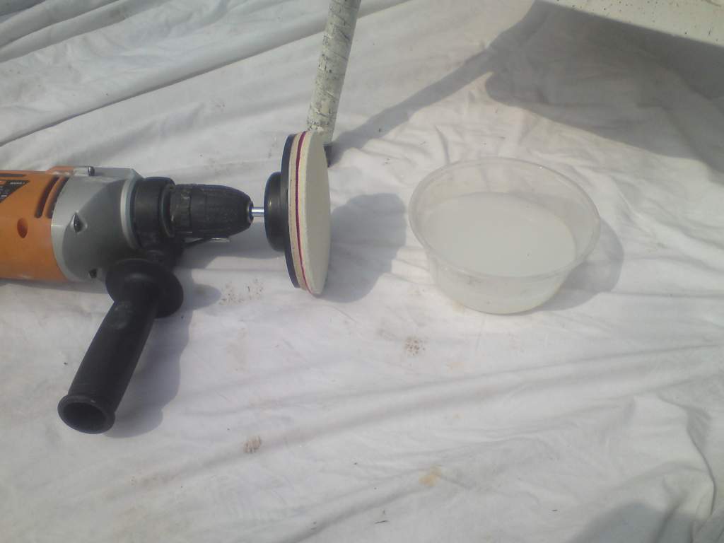

Here it is attached to my drill with a tub of water at hand.

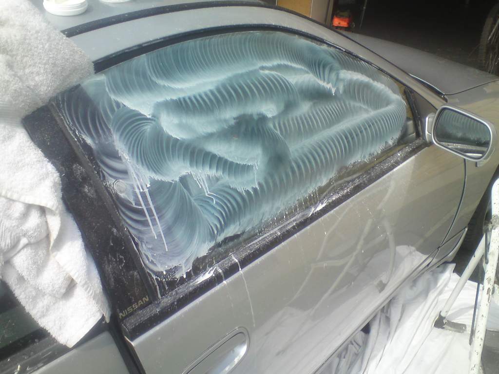

So on with the polishing, so using the paste i got with the kit although G3 or similar did seem similar and with water on the pad, i ended up making a mess !! If i was to do something different next time it would be to do this job with the glass out of the door, to enable corners/edges to be got better but to be fair there were no scratches in these areas anyway.
After going back and forth umpteen times i wiped off, i spotted some scratches i had missed so it was back through the papers locally though, polished again and then again.
I do have some scratches i need to go back to and i shall asap but the more you polish the better the finish, this is not a two minute job.
My glass was badly badly marked but with this being blue swb glass i had no choice but to do this process, it's not perfect but is way way better, yes i have some inevitable distortion but this is only visible in the unforgiving baking sun, bet if i pulled up no one would say or spot anything, when you consider i've not done anything like this before............i am well happy.

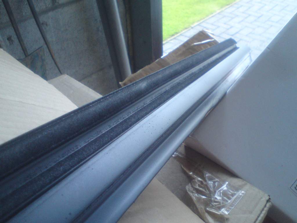

You can see below on the blurred pic a lot of slopping and no doubt tiny glass fragments/dust in the cushioning so i removed for a damn good clean, i also sprayed down some WD40 so it flushed the glass out and ran into the door cavity.
Much better after being wiped in hot soapy water and lightly scrubbed with a nail brush, freshened up also with some black satin, certainly not wanting those scratches back :biggrin:.
