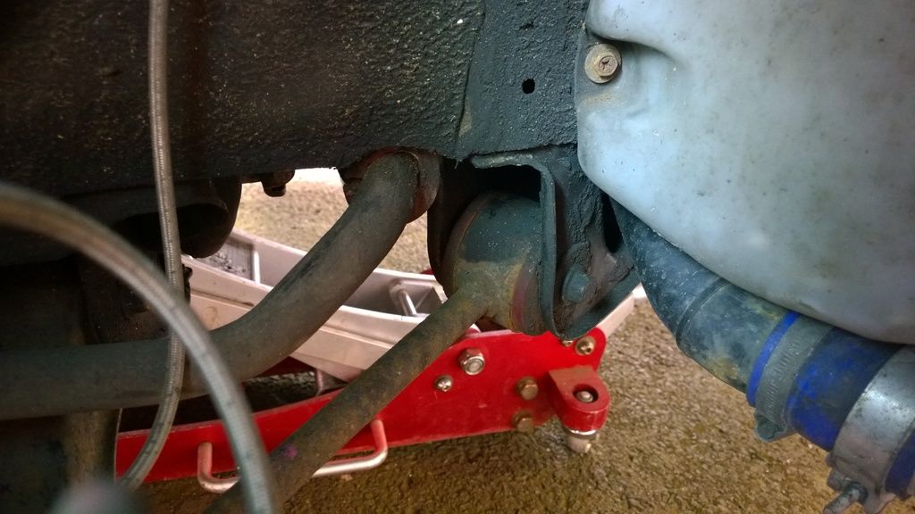

This concerned me, but then i pulled the sleeve back and it seemed fine.
Theres nothing under there that i can get a clonk out of now, nothing seems out of place or worn.

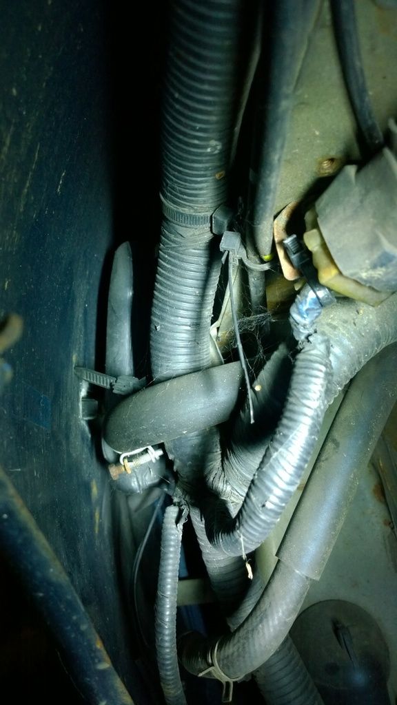

Also what is this
Part of the aiv?

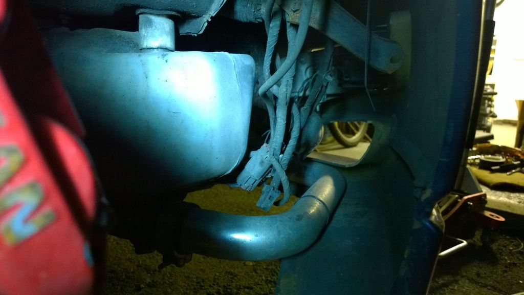

I think someone beat me to the deletes but didnt finish it.
You need the axle stand or jack off of the subframe or suspension parts and jack it on the jacking point or you are compressing the bushes.
Yes AIV probably deleted in the system but associated parts not removed.

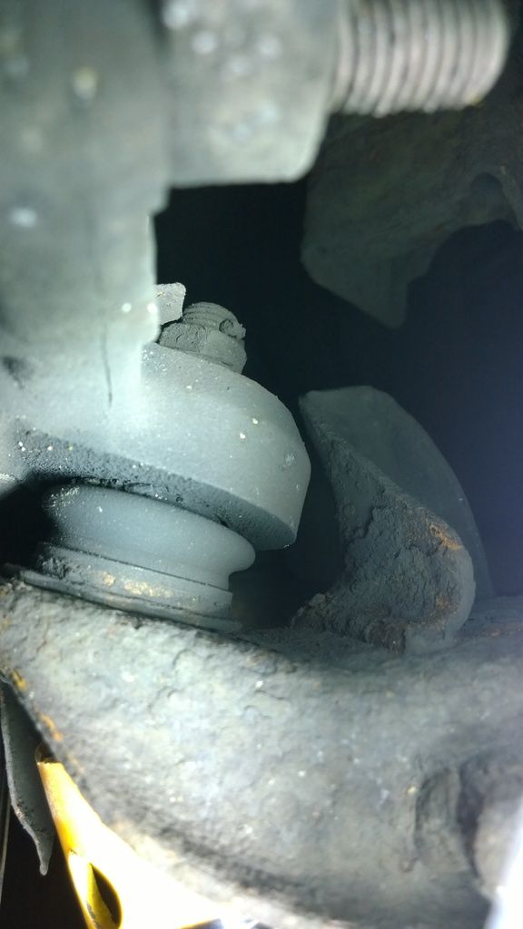

That joint looks a little dry, all the juice gone maybe.

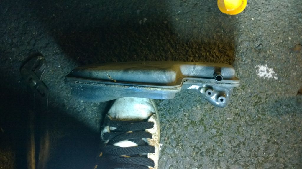

I think that shock looks pretty suspect now.
Your tension arm looks to have a poly bush and looks fine, the gaitor on the shock being shot, could let in grit and dirt and eventually effect your shocks performance but but unlikely to be causing the clonk, sounds more like a movement issue, ie drop link movement
You would fail an MOT though on the shock gaitor
