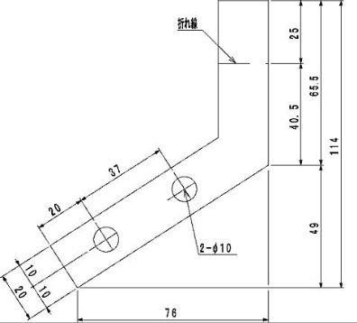

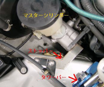

Does anyone have a brake master cylinder brace they could get some decent measurements off?
I'm looking into getting a metal fabricator mate of mine to make me one. Best I've given him so far is some pictures off Google.
will post pic 2 moz i have one here
in fact i will make you a paper template of the size and were alll the holes are and post you it

you need to have a look at the pics i sent you by email to to see how the end is done as you can ajust it have a look in the pics i emailed you
Dan...Could you please post this up for all could you?

do you just want pic of the brace ?
i can do you a template if you want mail your address and email. will send you a template in the post and send you some pics by email so you can see how it looks will post in in a day or so
