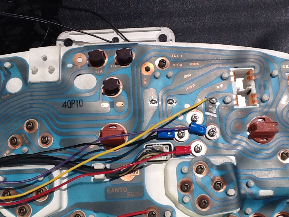

I wanted to keep original clocks & fitted a kph to mph converter.
There is a write up on it & yes I cut & soldered the circuit!
Did not have to do any more!

[ATTACH=CONFIG]95550[/ATTACH]
Hi, thanks, I need a course for dummies, what circuit did you cut and solder? And the photo is of???
Cheers.
I have that exact item which I bought but never used, as I came across a UK cluster. You can have it if u want for £15 posted. Can't find the parerwork showing which wires go where though, but someone on here should be able to help.
I've never personally like this method of cutting into the track as there is no way back.
When doing mine I just cut the cable on the loom and put a bullet connector on both sides then
if for any reason I need to take it out just plug them back together.
I've never personally like this method of cutting into the track as there is no way back,
Mmm... but if you snipped the yellow cable and put a ring connector on it and it would fit back under the speedo screw, or solder in a link cable, personally as the pulse voltage / current is so low I do not like bullet connectors as they can tarnish over time and become high resistance to low voltage or just be not a good connection, good soldering however is neat.
But I do see the bullet connector method can be accessed quickly without speedo cluster removal to return back to kph, as long as the +12v and -12v is taken from the loom also, was a pain I found when removing a cluster to find when the main connectors were undone there was delimiter cables connected to both the speedo cluster and the loom.

Just need to be proficient at crimping and use the correct tools.
I have seen some dodgy connections on zeds I've seen but as long as the crimp is suitable for the gauge of wire and its solid
it should be good enough. not that i'm saying its better than the old solder technique.
Yes and yes, horses for courses I guess, that said, sure we have both seen some soldering nightmares too eh?
Jeff
