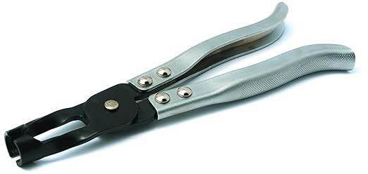

Apart from the tool that AndrewG posted, I also recommend a set of valve seat pliers to pull out the old seal (and put in the new one)
