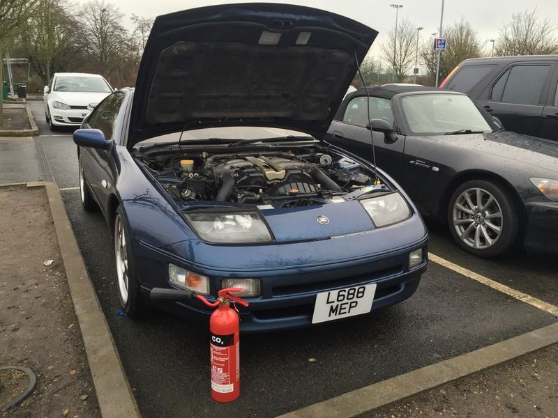

Thought I should say hello properly. I've had my Z a couple of weeks now and I'm chuffed to bits with it. It caught fire on day 3, but I've forgiven it that minor indiscretion already. I was very luckily I spotted what was happening and managed to get a CO2 extinguisher right away. I had heard that the Alternators on these cars were weak, but I didn't expect it to self combust!

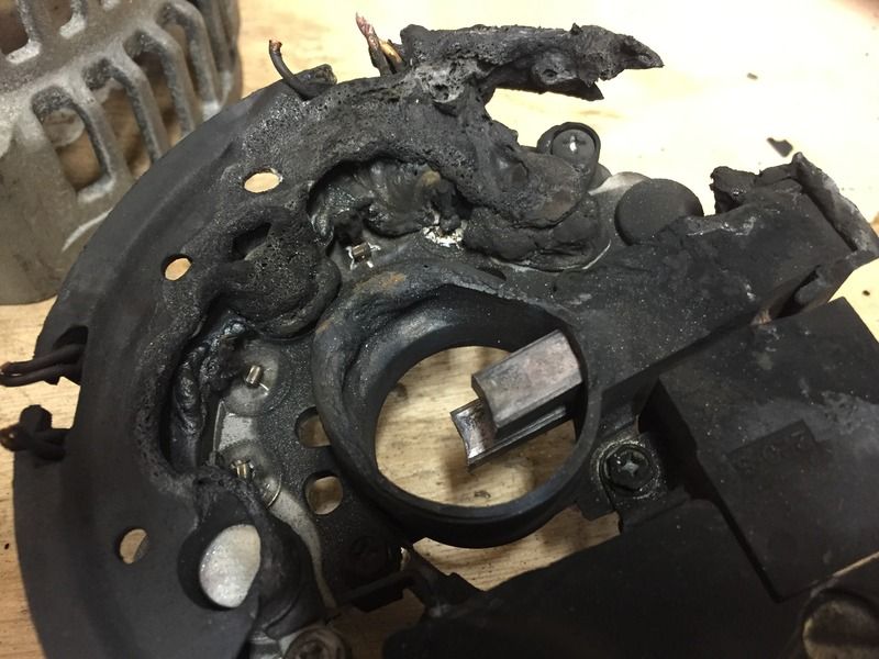

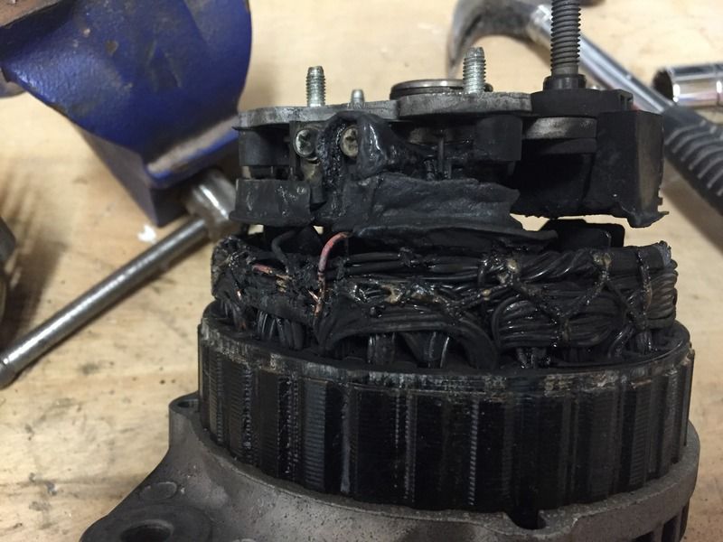

As for the Alternator, I reckon the regulator failed and was overcharging significantly. fortunately I parked up only a mile or so after it happened (radio started playing up so I can pinpoint the time of failure, I now realise as it did like operating at 16V+). Very lucky not to damage any other electrics, and very lucky not to lose the car to the fire as would have been a serious possibility if left to its own destiny. Since Euro's weren't keen to take my alternator in exchange, I took it apart for a look...
I assume this is a more unusual Alternator failure?
