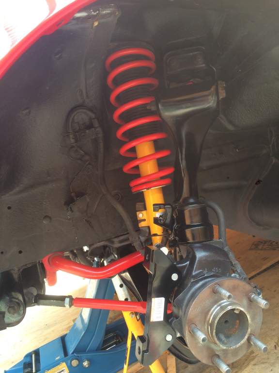

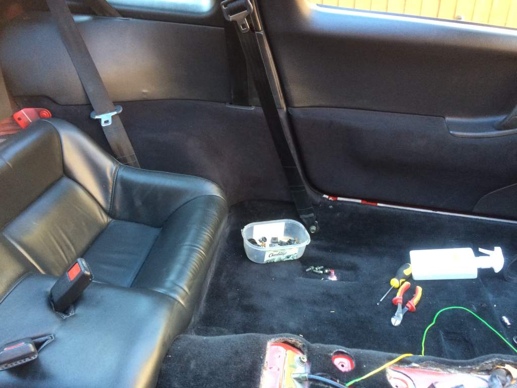

got the gear box back on fitted new speakers all round with dab radio all working now get the retrimmed door cards back on an electrics hooked back up did wiring for fog lamp in center panel and reverse light to. here are a few pics of the door cards looking super in black alcantara

Does look really neat, keeping the seats the same?
no i have a new set of leather recaros to go in

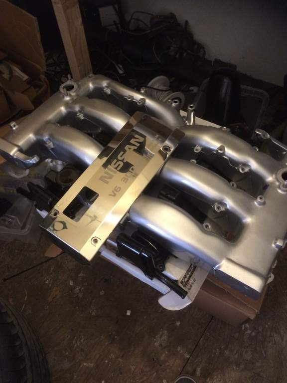

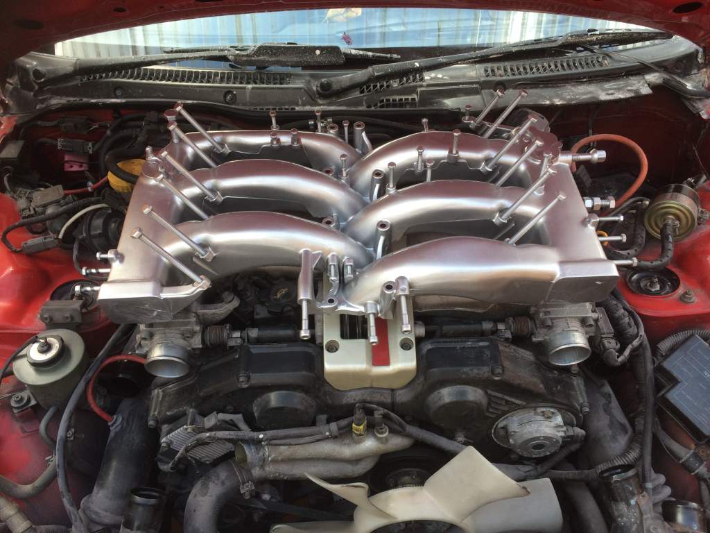

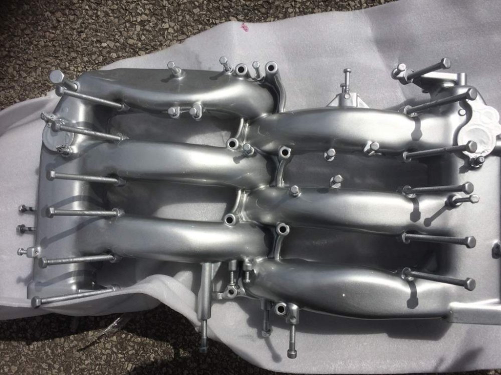

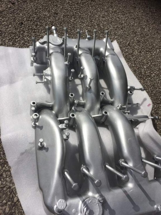

the time is near after i fit the big brakes to give the engine bay a major make over to match the rest of car just got the manifold back done it bright silver
Edited by dan300zx

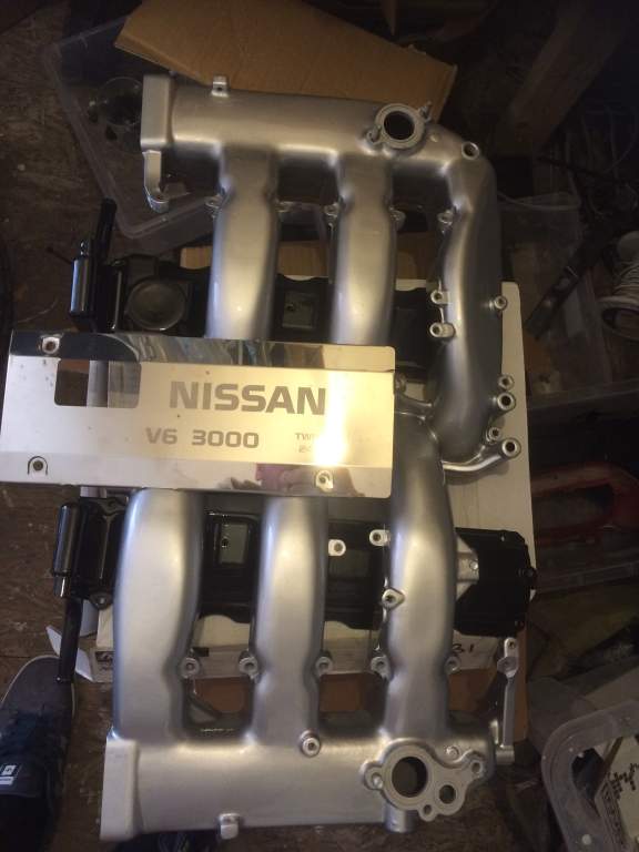

just a mock up to get a idea like with black cam covers

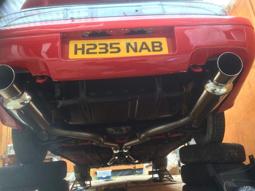

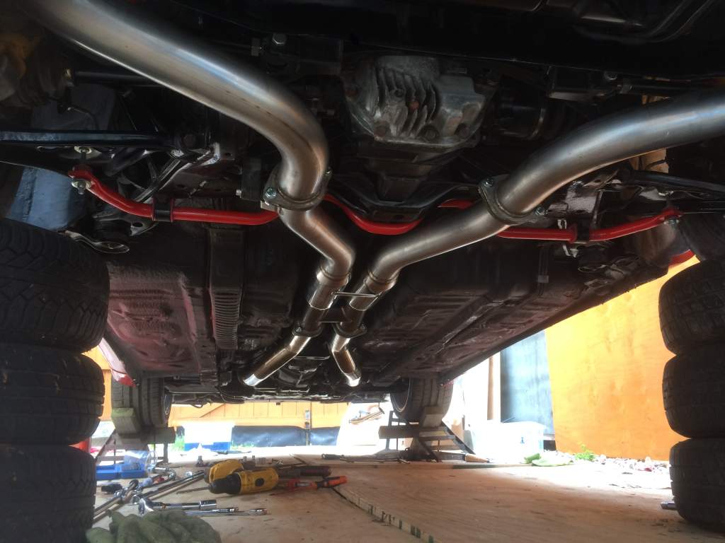

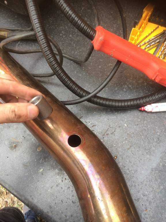

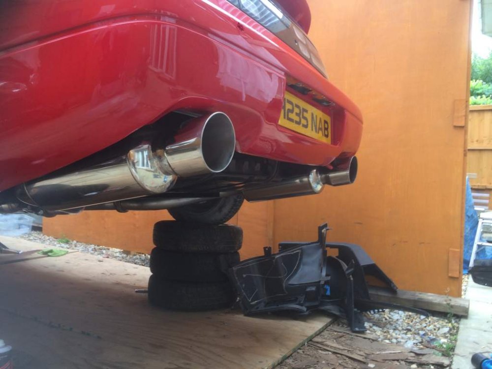

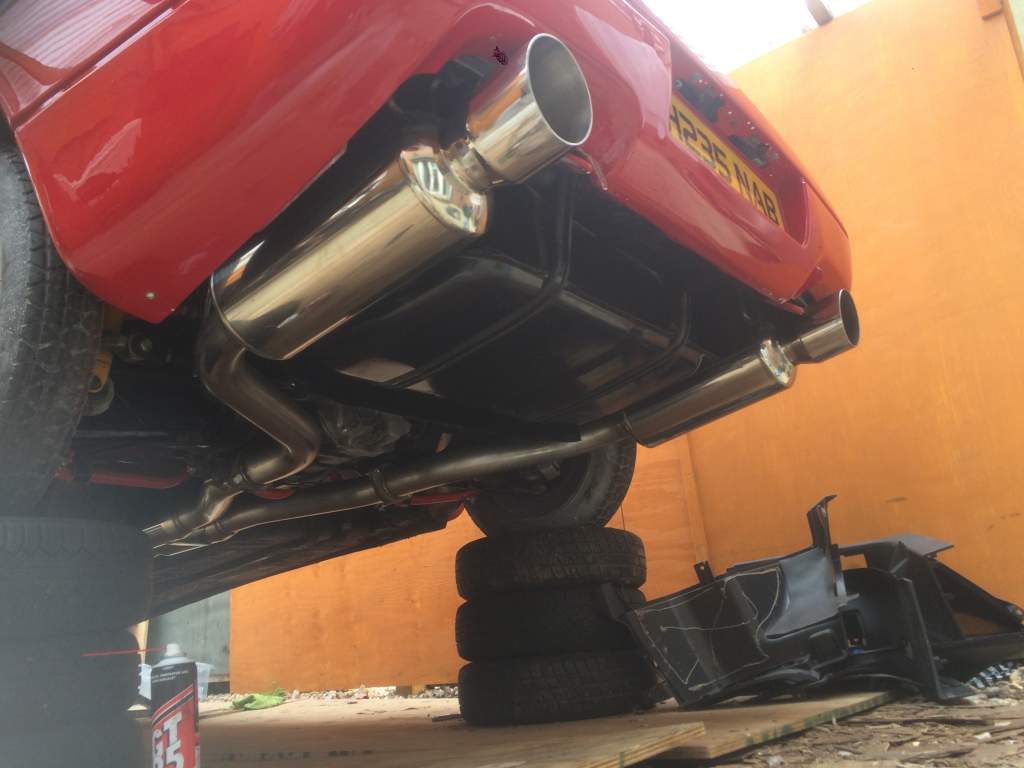

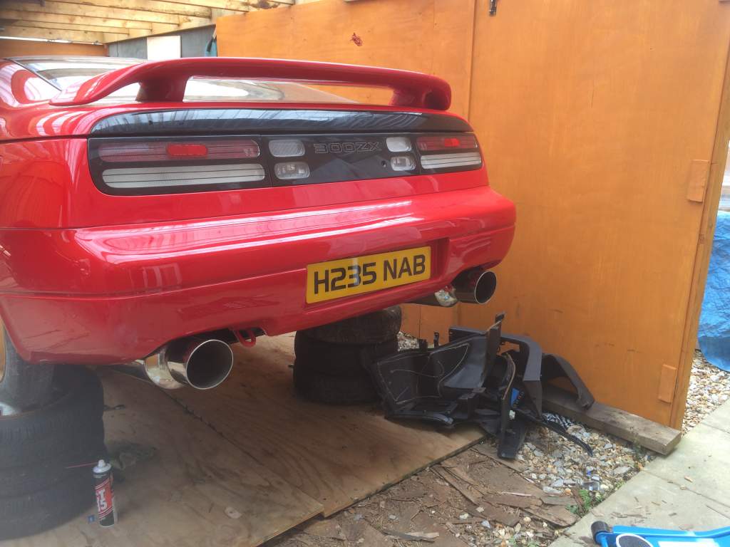

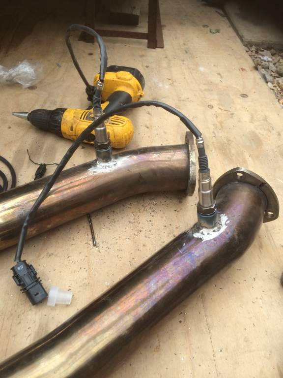

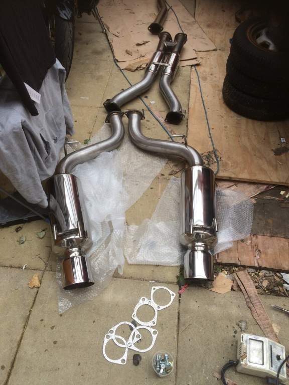

today i welded onthe bungs for the afr gauge and fitted the fill 3 inch system so we how have full 3 inch rite through inc down pipes was bit of messing to get it fitted as i was on my own would have been much better with some help but after a few hours it was done all new bolts and gaskets to
Edited by dan300zx
That's looking really well Danno:thumbup: They're Veilside cans, if I'm not mistaken?? How soon to firing her up??

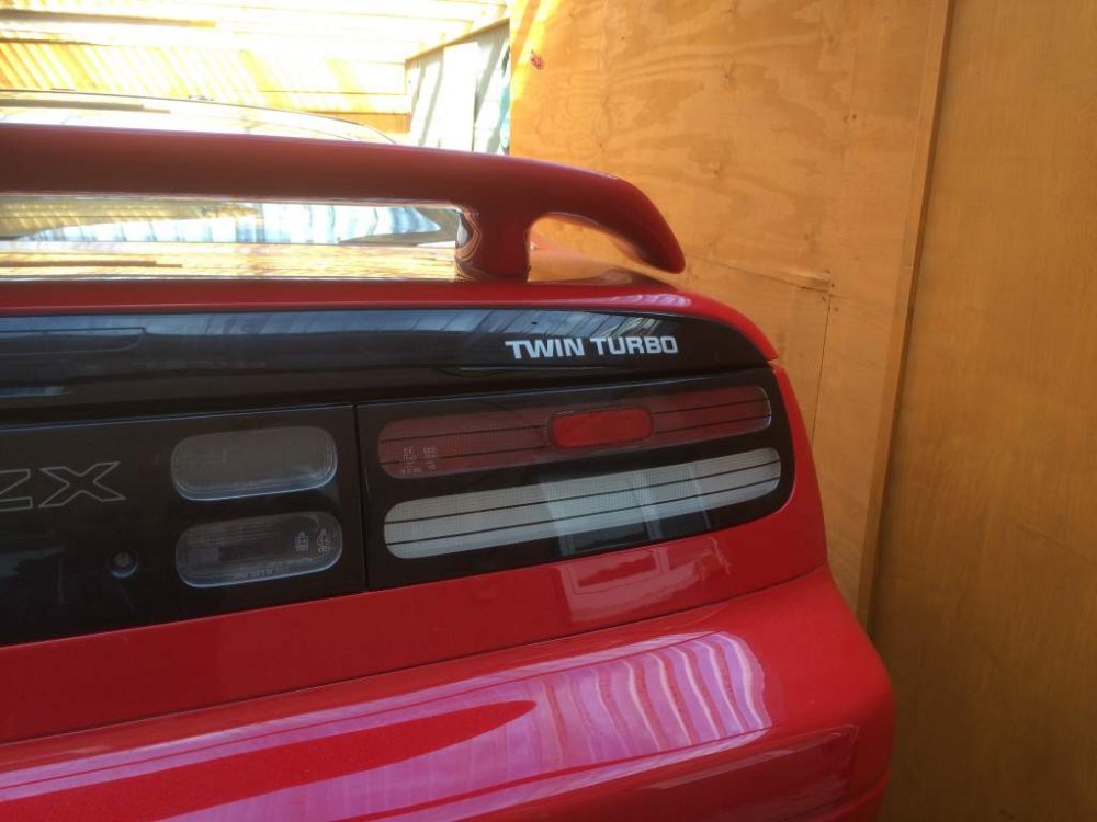

didnt get home till late today so didnt have much time just finished going over the system bolts the routed the cables form the air fuel ratio sensors into the cab i have a duel afr gauge so can monitor both banks of the engine just need to get them round the dash then its time to drop the car back on the ground and get on with the major brake upgrade also fitted the twin turbo decal lol the most easy job to date lololol

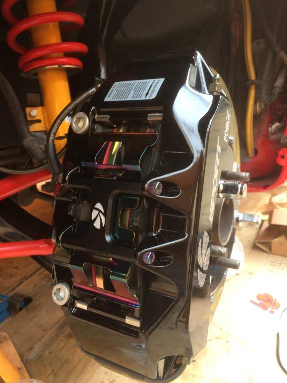

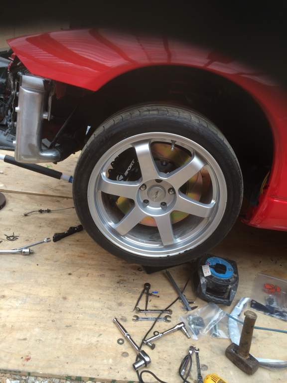

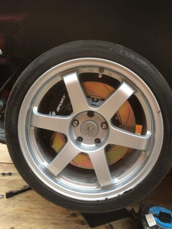

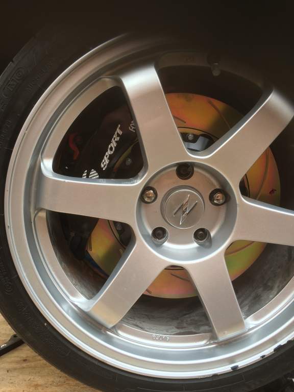

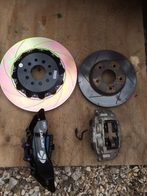

car back on the ground all work done on the under side made a start on the big brakes got the front on will get the rear on 2 moz bit of a fiddle but the fit it very good and fits behind wheel with no issues the front discs are 356 with 8 pot calliper have taken a side by side pic to show you just how much bigger vs stock ones you may notice the brand new wheels then powder coated got kurbed when i was moving it had no mirrors on at the time the wheels have not even be drive on there al going back in for a other full strip down and powder cost silver with a clear coat od silver sparkle bit of a pain but stuff happens i guess
Looking good Dan, nice to see you got the disks on the right way round. :yes: There are lots of photos on the net with the "directional vains" turning the wrong way. My brother fitted a set around the wrong way to his Subura Legacy and had been driving around on them for a year!
When you get to the rears you will find that there is no hole in the disk bell to get to the handbrake adjustment cog. I ended up having to drill one in my bells to get access. :crying:
yes in internal vains is what counts groves on the discs can go anyway, people get mixed up and go with the groves not the vains
