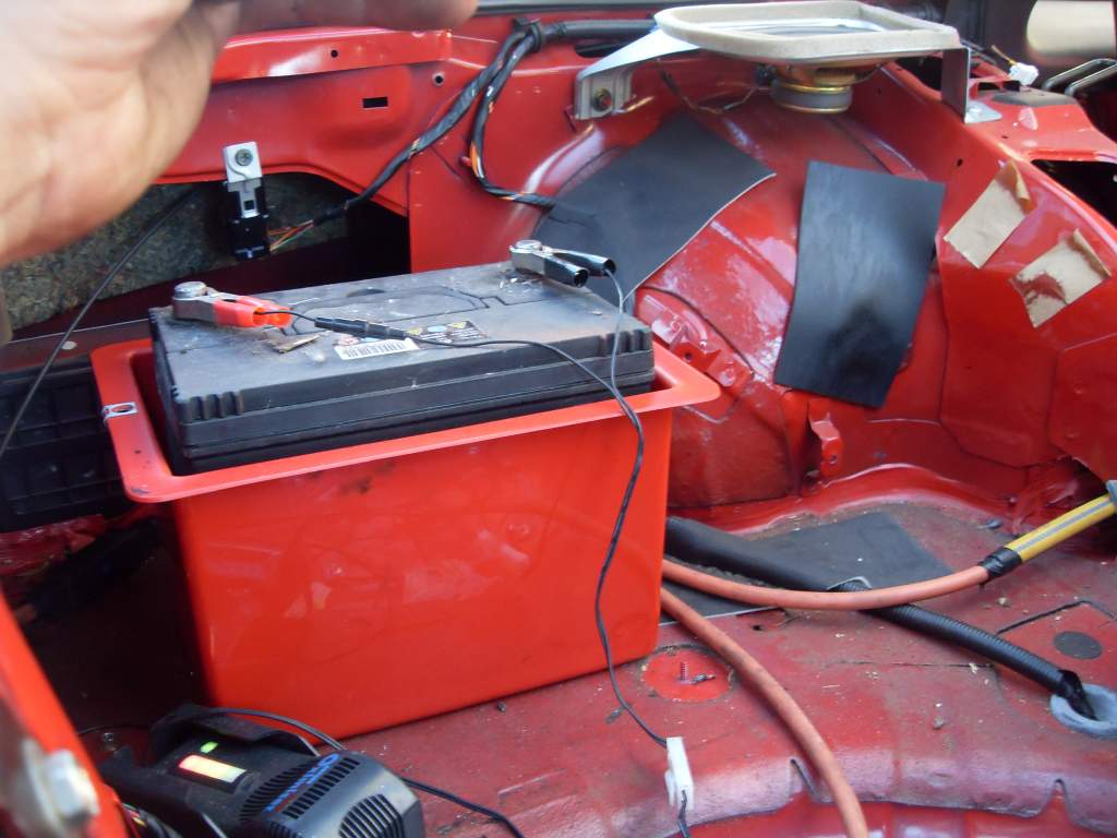

i had to move the bat to the boot to do this i used the ams one SDC12531.jpg

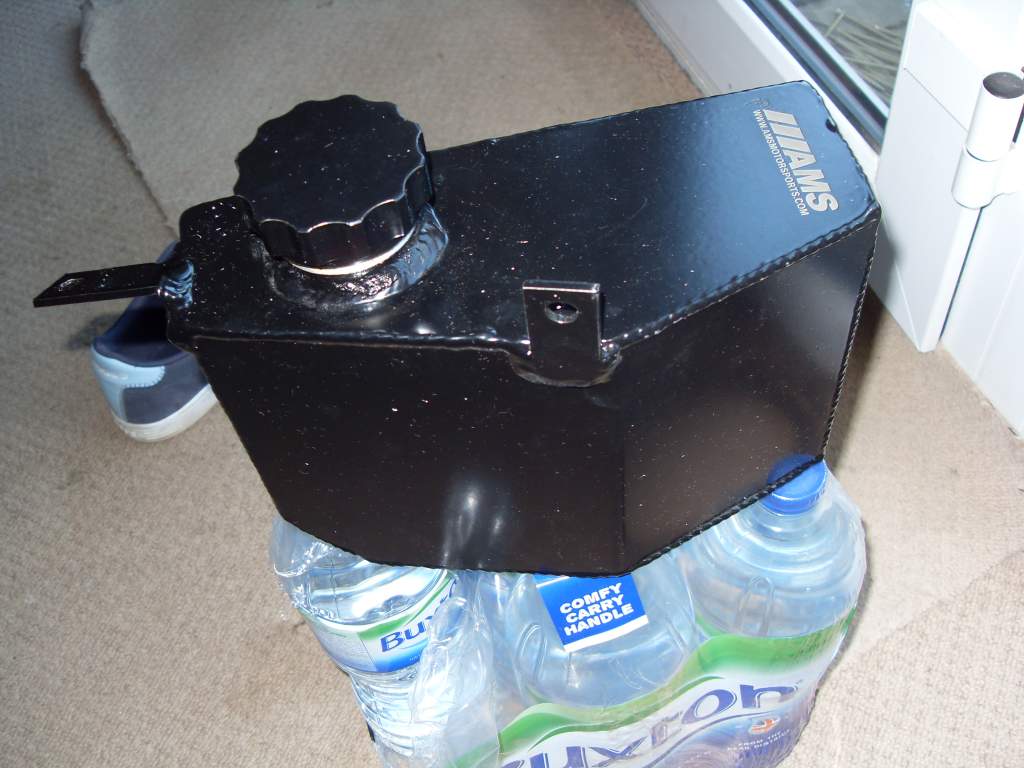

Why not get the ams one? It's on offer!
Thought postage would be a lot, it would take a while to arrive and not sure it would fit with a normal sized battery (whatever that means) so if someone knew of one for £20 or whatever then I'd go for it
i had to move the bat to the boot to do this i used the ams one [ATTACH=CONFIG]94488[/ATTACH] [ATTACH=CONFIG]94489[/ATTACH]
So the AMS one didn't fit properly with that size battery?
I don't know about postage, bit they're only about £40 on the ams site at the moment.

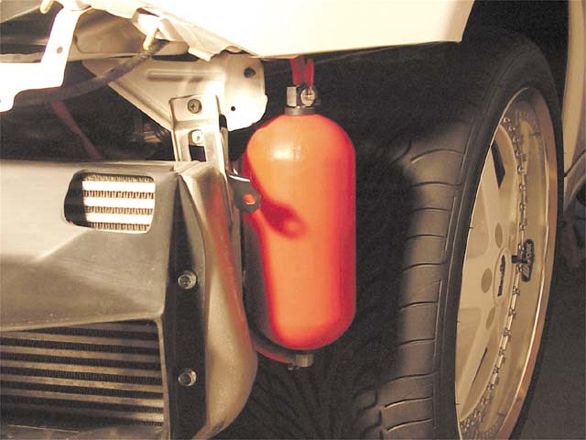

This is what I have.....http://www.summitracing.com/int/parts/sum-g1472/overview/
[ATTACH=CONFIG]94490[/ATTACH]
I got mine from a forum member a few years back..... does the job well....
Thanks, that's another one to order from America though

They've come back with $28 for shipping so I might go with it actually as it should be a neat solution, though still not sure if it will fit next to my Bosch 068. Anyone know if that is the stock size or smaller?

I asked AMS what size battery it would fit next to and they said OEM. So I asked them what size the OEM battery is and they had no idea!
They put me in touch with a customer of theirs and he said you need smaller than OEM, his battery is 216mm wide and a snug fit so my 260mm battery doesn't stand a chance.
The stock battery is approximately: L260mm W175mm H222mm.
Really? Hmm well this is confusing then. He did say I might be able to get enough room if I removed the plastic tray so I could move the battery over enough, but his looked pretty tight as it is. Will see if I might be able to gain enough room, but then I'm not sure what that would do to getting the battery in and out
