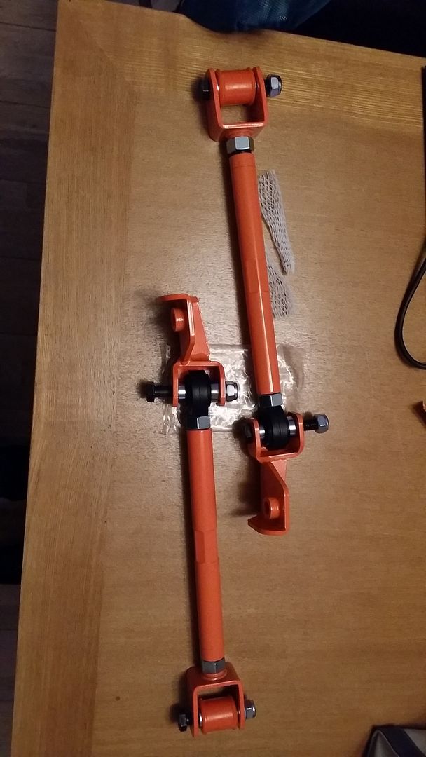

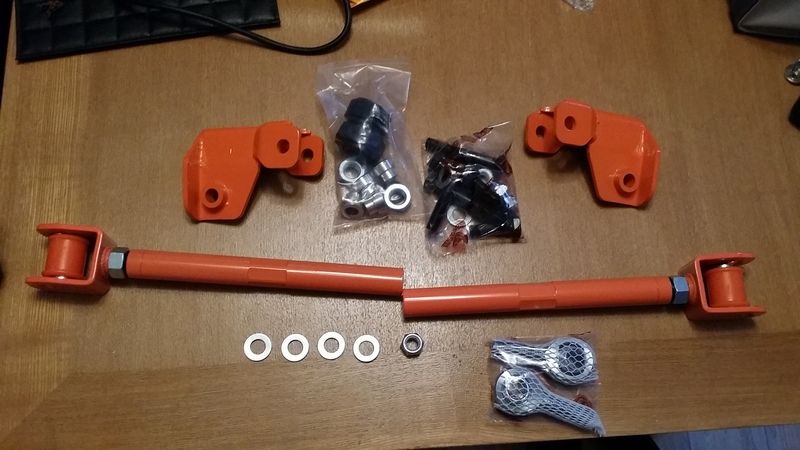

Well, I've just ordered the driftworks total HICAS eliminator kit.
