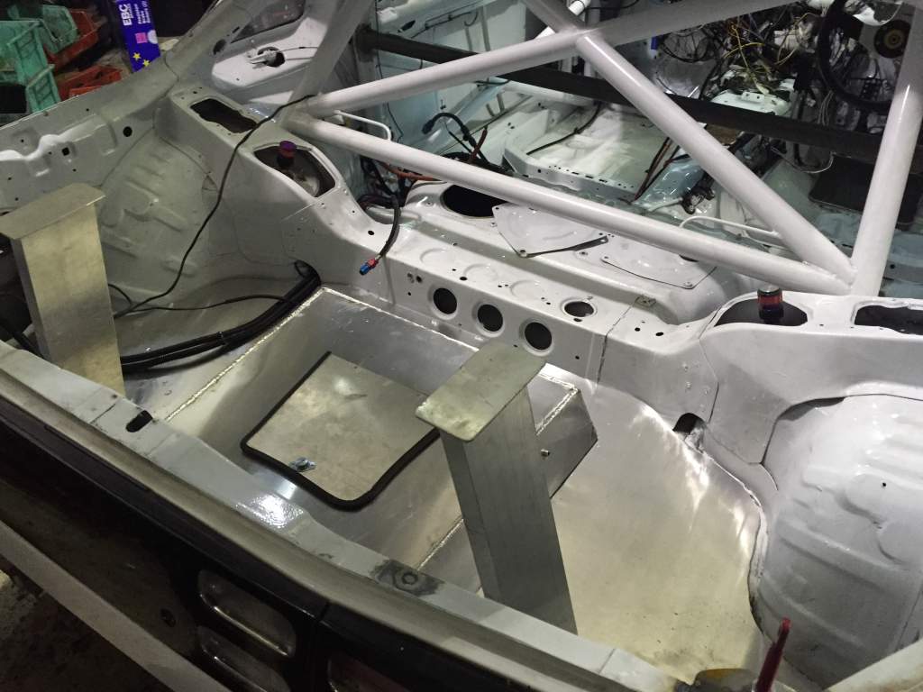

The main aim in the rebuild is to move weight to the back as far as possible. In addition I will be trying a few new ideas and I will add a few more photos as I get them over the next couple of months.

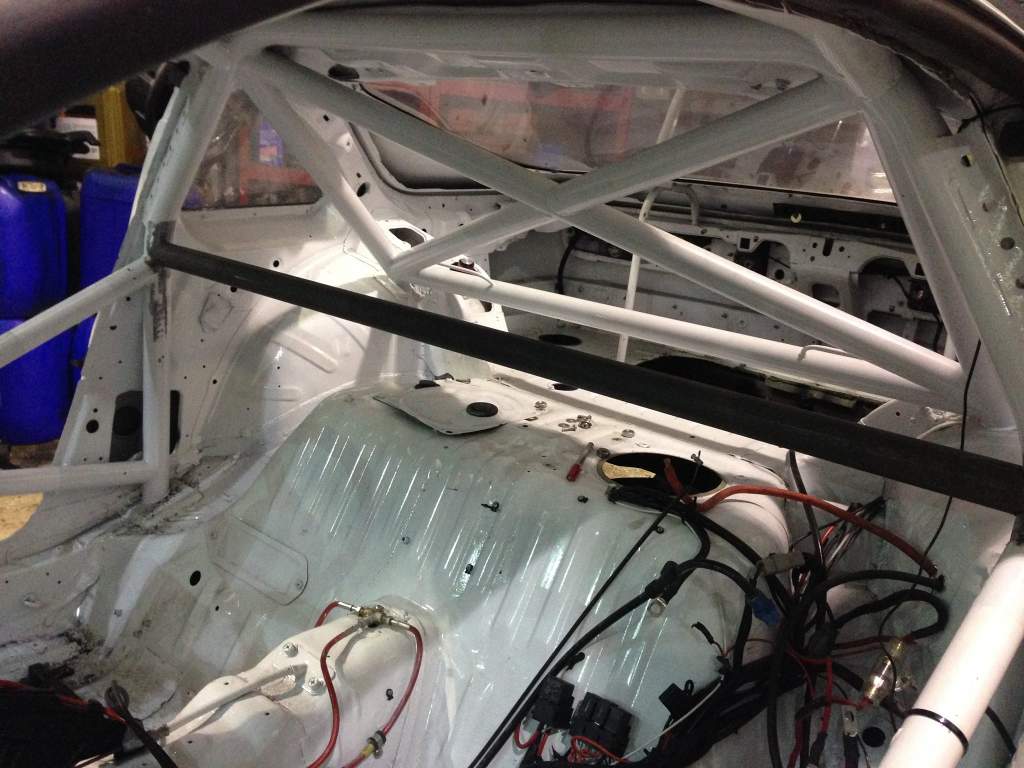

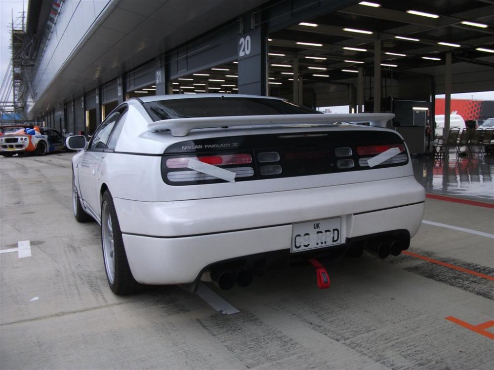

And here we are at one of the early trackdays we did at Silverstone.
By then it was a well modified TT manual but still fully trimmed and nice to drive on the road......

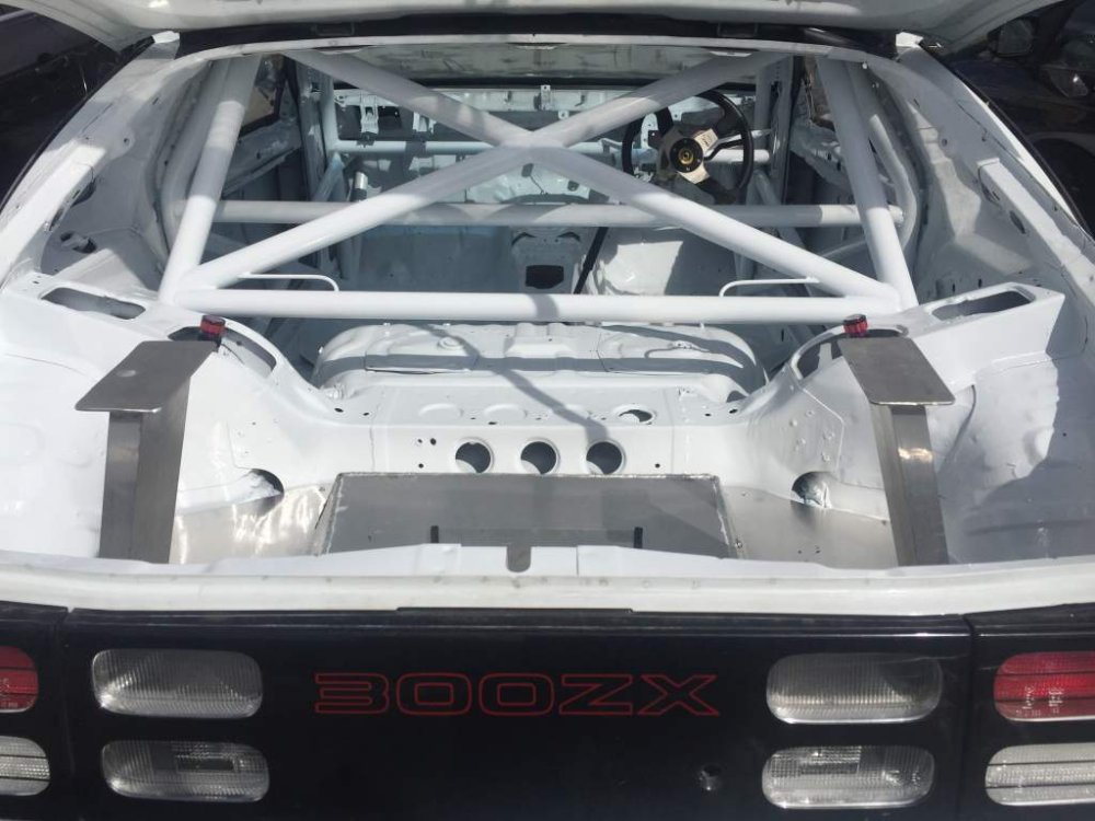

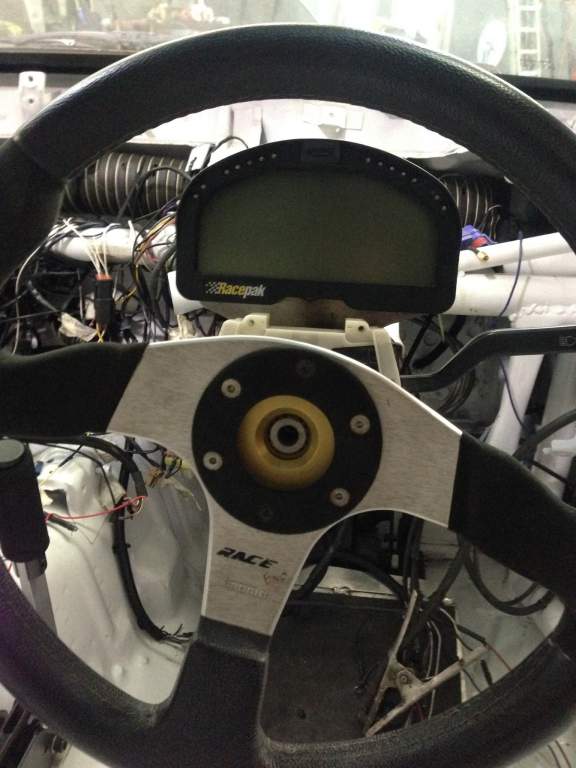

Racepak relocated to enable more functionality. Extra rear cross-member installed to be compliant with Jap Drag Series

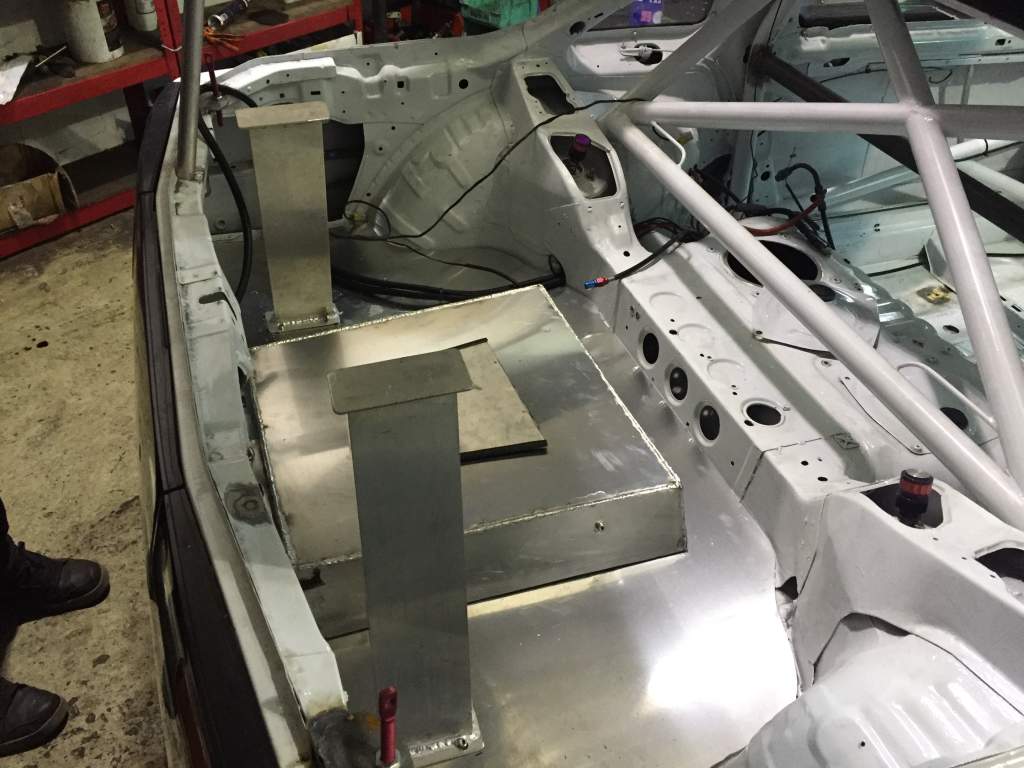

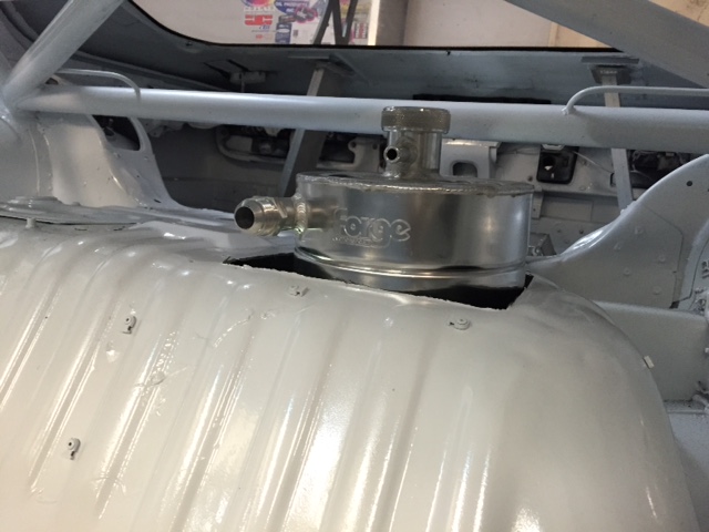

Some really nice work for the fuel tank and some better catches. The front is coming along nicely :)

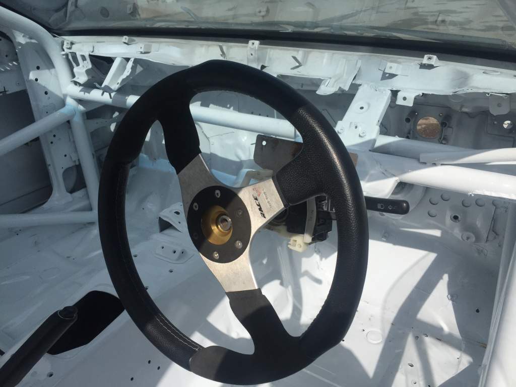

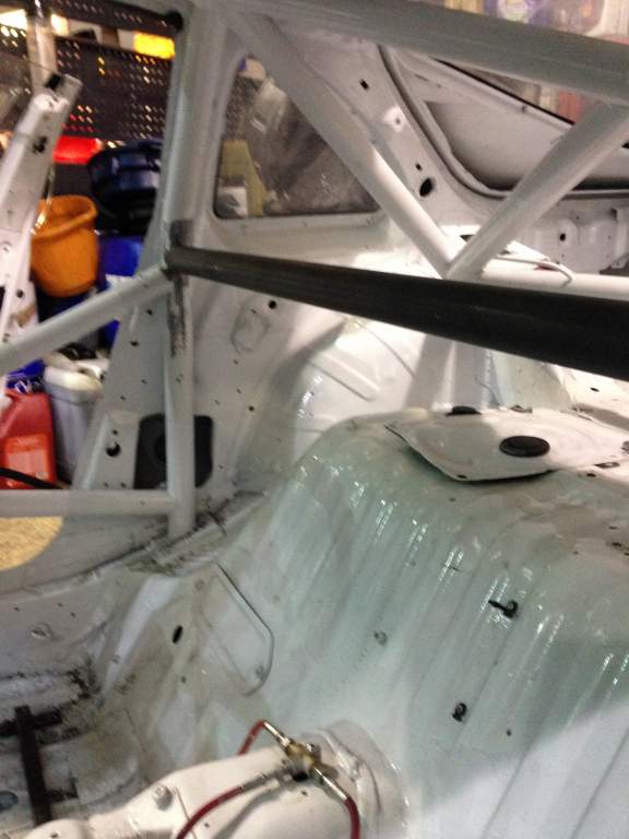

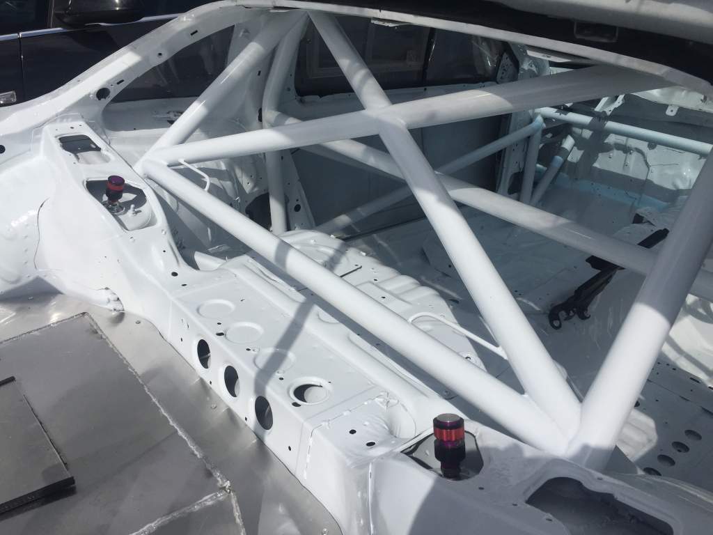

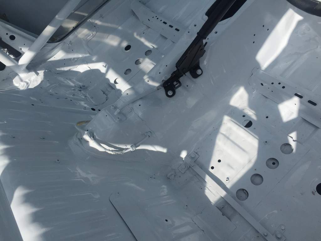

Painting the interior now completed and ready for the next stage. Still awaiting a part for the gearbox so getting impatient with that. Now we have to re-wire hopefully for the last time ever! We have all the parts for the dry sump and hopefully by the time those components are assembled we will have the gearbox in and ready to test the dry sump with the old engine. Still hopeful for Time Attack at Brands and TOTB don't want to do any of that in the Evo

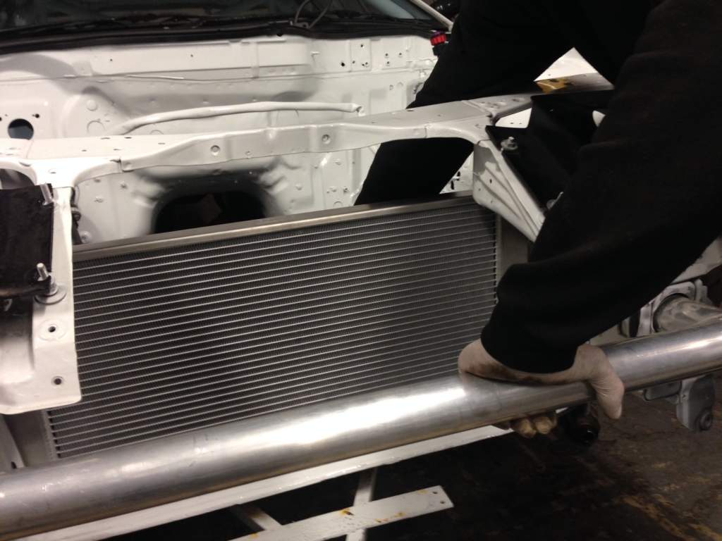

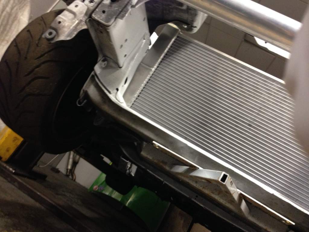

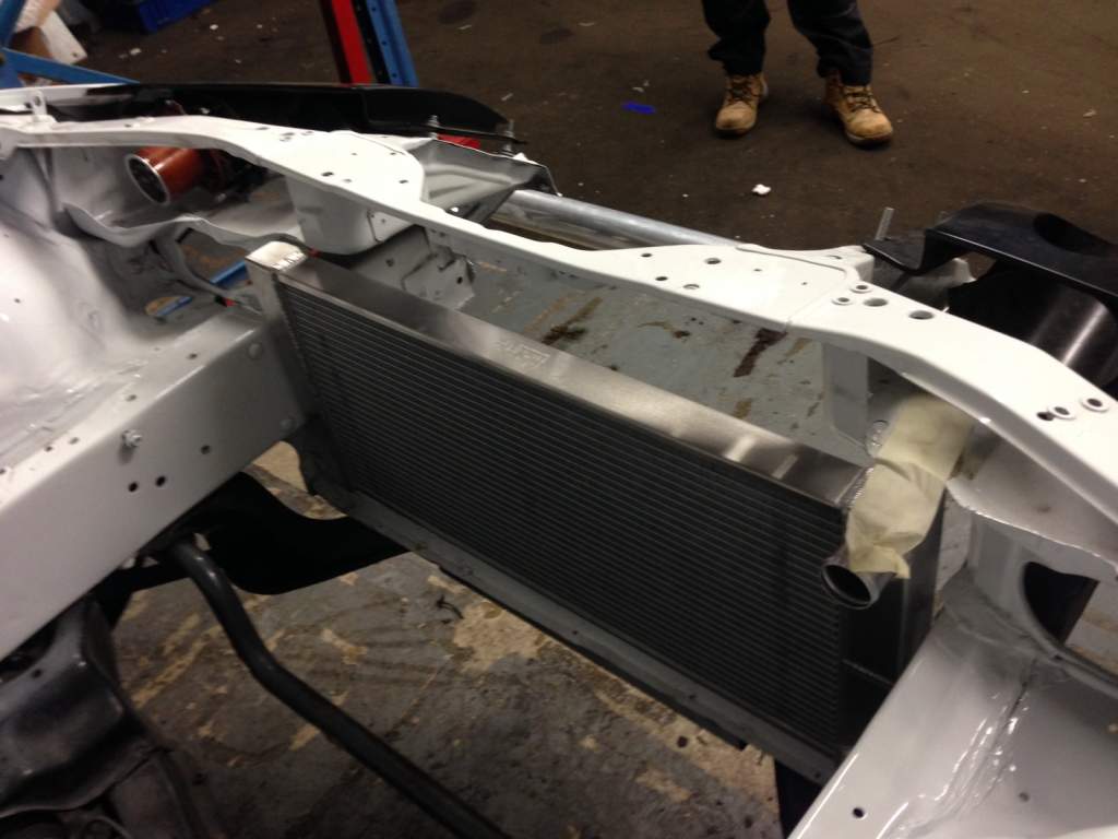

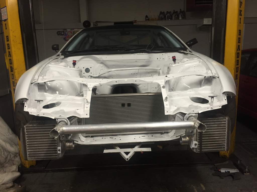

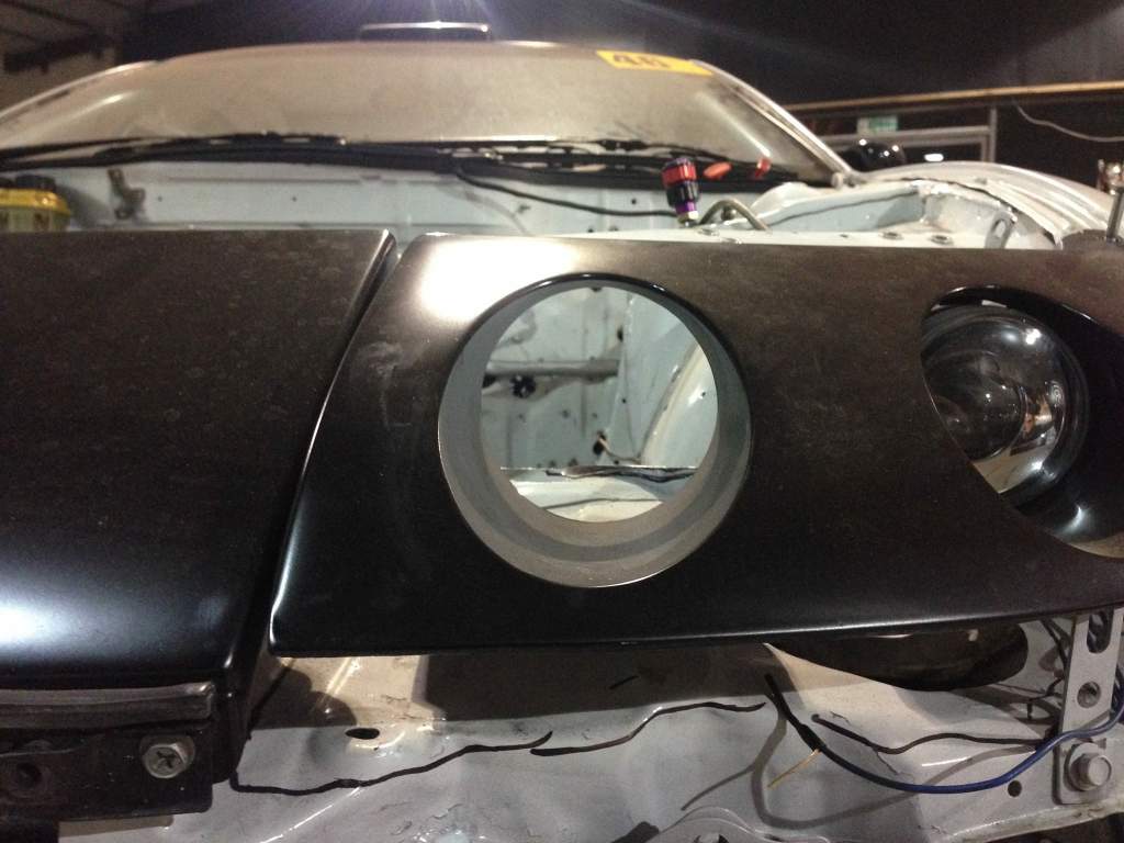

Here are a few photos of the radiator install. This should improve cooling as we will prevent any air going around.

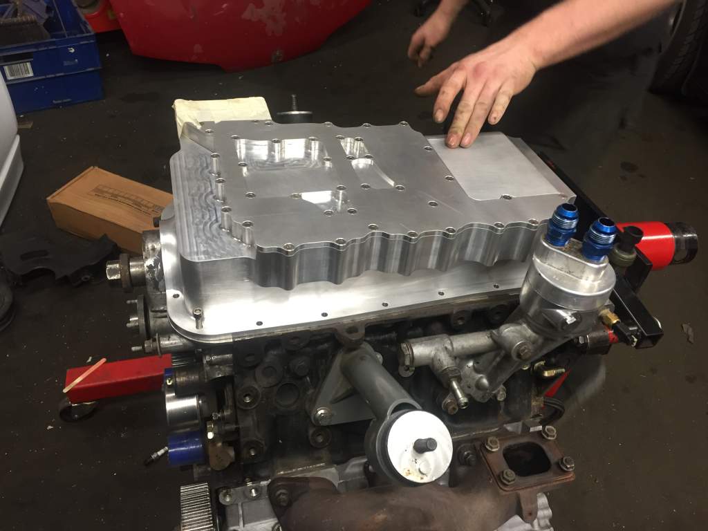

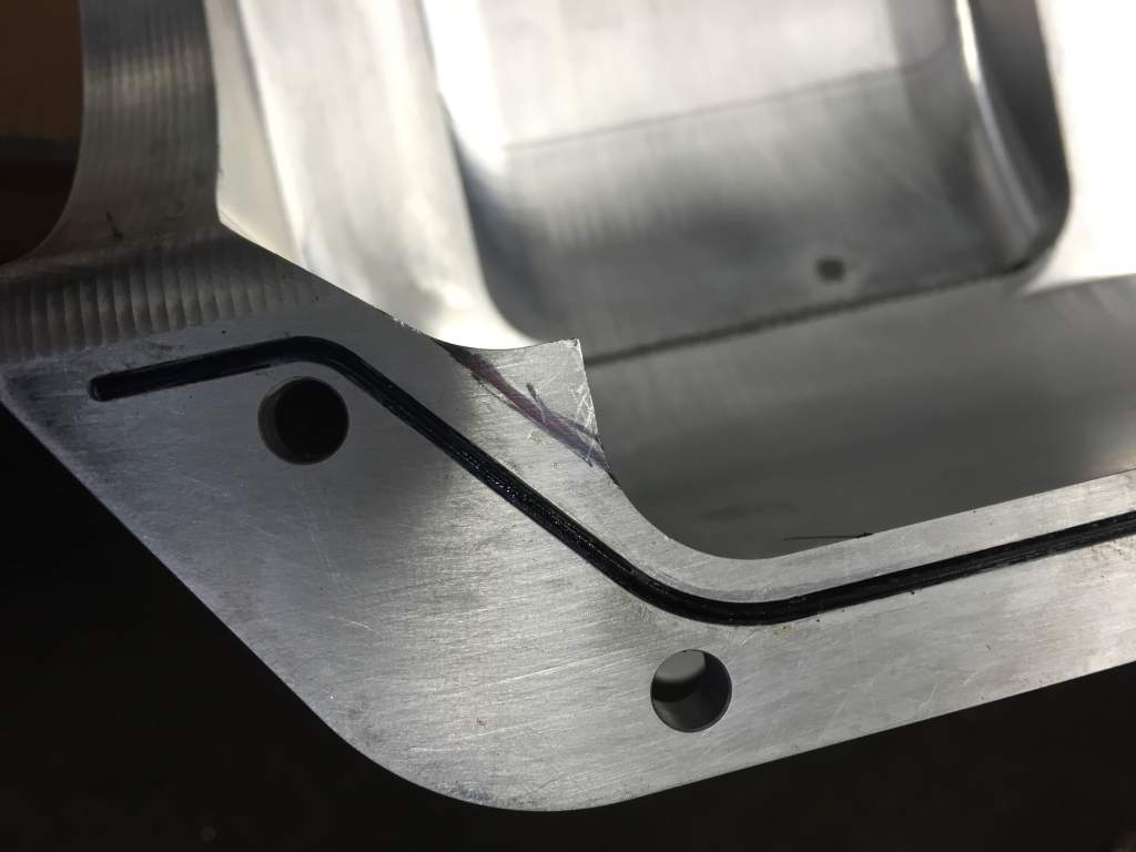

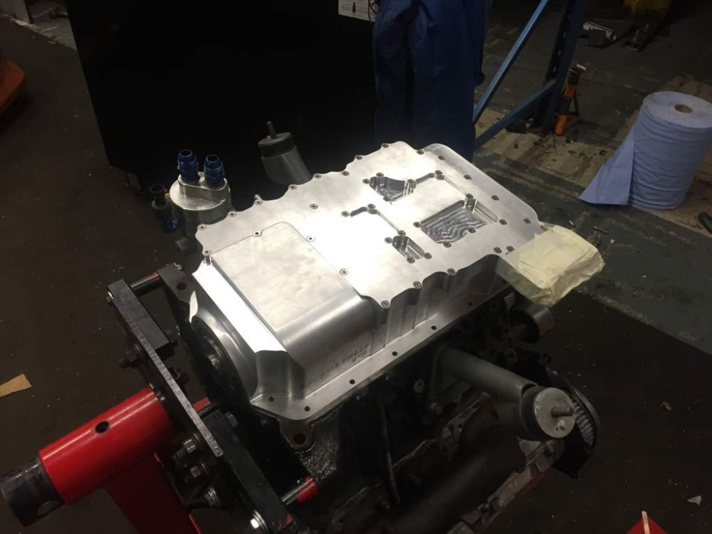

We were fitting the Daily dry sump to the old engine which we shall use for testing but found that a corner needs machining off as it causes the sump to foul the crank.
Next job is a new race loom but mostly now we are simply re-installing parts which hopefully will mean some testing soon.
I hope the next photo will be of the gearbox install however we are struggling to get a rebuild kit for the HKS Triple plate clutch. I will use the old one for testing purposes and keep fingers crossed we can sort it.
I do like thay radiator setup, i was thinking dual pass for mine but i had other issues to take care of.

I needed a little machining done to the sump pan took it too Andy Robinson today who turned it around in three hours! So he works as fast as he drives top man :)
So here it is trial fitted to the old engine and fits perfectly now.

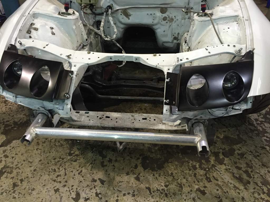

Some custom intercooler brackets made which position the side mounts perfectly and you can see how the new ducts will help with effective cooling.

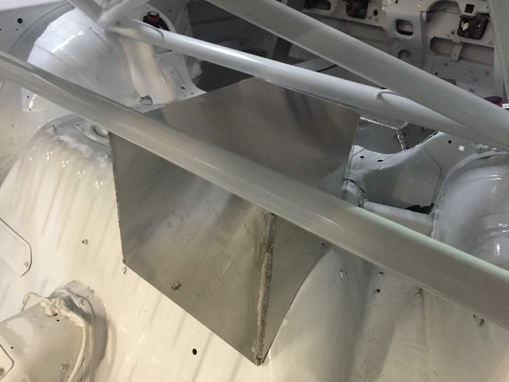

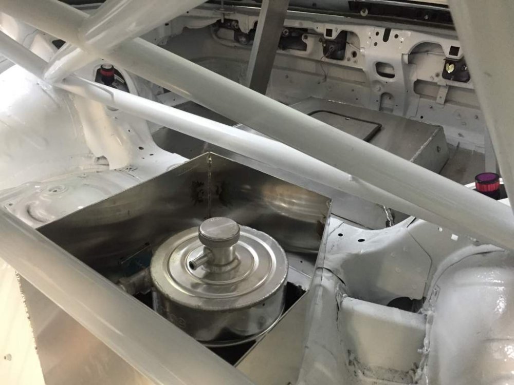

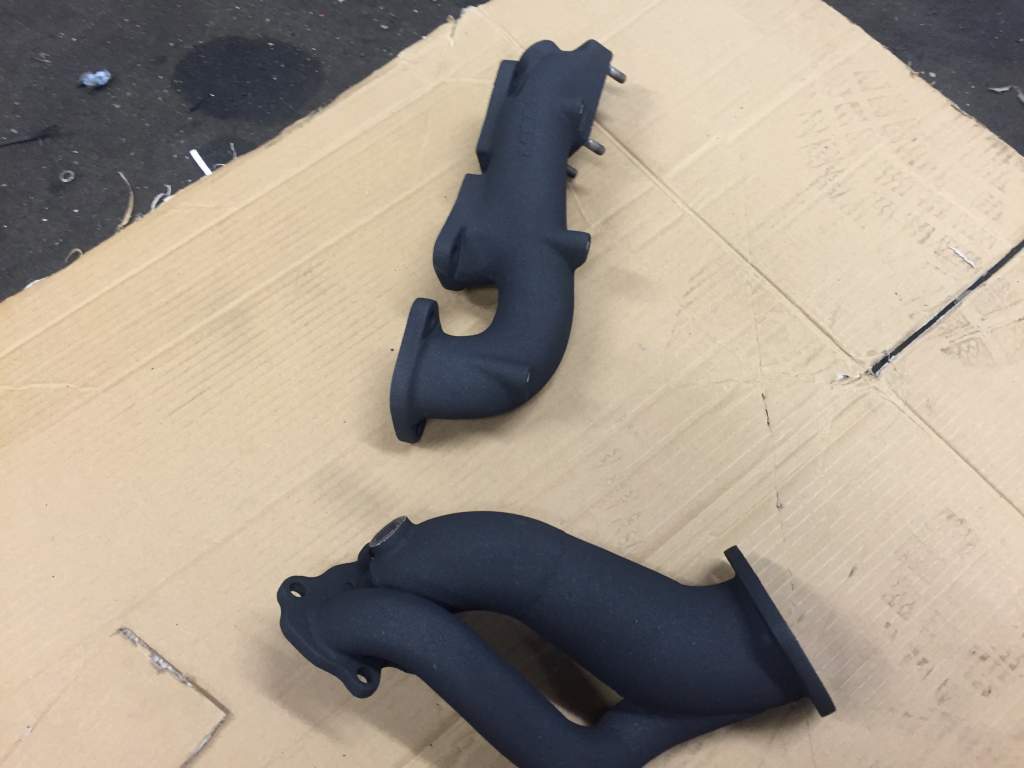

Some stealth Zircotec here will also help with keeping things cooler. Boxed in the dry sump oil tank as MSA regs now just needs welding.

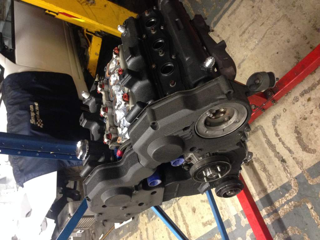

Thanks guys we are progressing and I will have a few more pics by the weekend. Not looking good for Brands Hatch time attack round sadly so will have to be the Evo (hopefully finished this weekend). We have trial fitted the dry sump to the old engine and stripping the guts from the original oil pump as will be using the pick-up. Once the new gearbox arrives we will have to measure up for a custom prop. Patience is a virtue so they tell me :)
Here is a photo of the old engine and installation of the dry sump system parts getting it ready to test soon fingers crossed. Looking very stealthy I think! I will have a few more updates Saturday hopefully there will be a gearbox stuck on there :)
