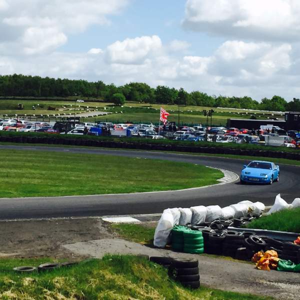

I've been running federal 595 RSRs for the last few track days and a ring trip and I've been pleasantly surprised by them.
They have enough grip to make them worthwhile, but their real benefit is how much better they are at handling heat compared to a road tyre. I haven't had any of the splitting across the treads that to you will read about online, whether over been lucky, or they've sorted the problem I don't know!
In the wet, forget about any grip as you won't get any heat into them, but wet track days are all in about learning about your car!
Remember if going for a really grippy tyre, (r888s and up) z32s need a lot of help keeping oil starve at bay!0029c5d3f85400c716e931e60c256d18.jpg
