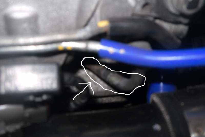

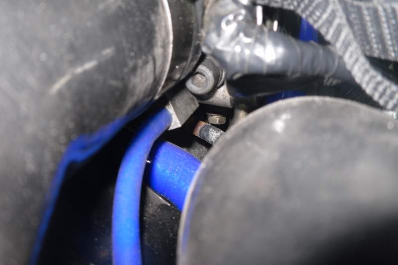

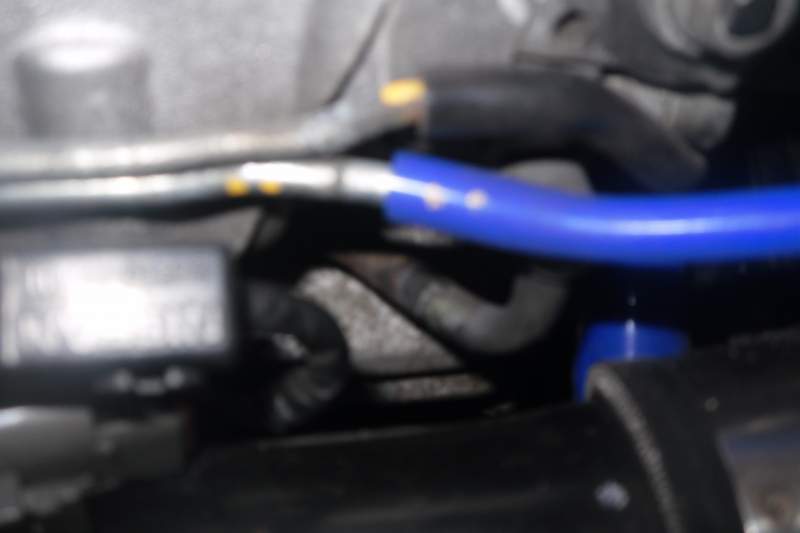

What are these?
It's the only thing I have found that is open, they sit just under the front of the throttle body at both sides of the plenum.
It's the small pipes right in the centre of the photos.

The little hoses under the throttle body, one side feeds the carbon canister, and the other feeds the EGR solenoid
There connectors in the picture do not have anything attached to them at present?
Are you saying these two blue pipes don't have anything connected to the other end? If so, stick a bolt in the end of the hose and zip tie it there. Have you or a previous owner done any of the deletes such as carbon canister, AIV, EGR etc? If so, you'll want to trace all pipes and make sure they're capped as well

Here is the two pictures again with the little pipes circled that have nothing attached to them, anything that has a blue hose is fully attached at both ends as there are a load of little pipes in the same area but they are all ok.
These two pipes circled have nothing on them.
Sorry didn't realise you meant those two pipes. To be honest I can't help you there, I have no recollection of mine ever being there so I presume they were already deleted. I can't even check as I'm away at the moment. I'm sure someone else can clarify.
That's what I was thinking judging by the diameter but don't remember them being there when I did my bypass
